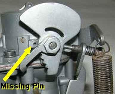

Does anyone know what size roll pin to get, and the best place to look for one?
Not mine but here is a picture showing a missing pin for clarification:
Thanks!
Warren in San Diego
1967 Beetle Sunroof Sedan

Simple repair for VW people. Get a small nail that will fit the hole. Cut it to length and then mix up some handy dandy JB weld. I think you get the picture. This worked for me.

I think either a 1/2" or 3/4" finishing nail fits.

Split pins are available at ACE hardware stores in many sizes, and that is where I got mine when I rebuilt the carb. JB Weld provides some additional insurance, but if the hole in the carb is still okay then the split pin will work well on its own. I managed to fill the area in with JB Weld, grind down and drill a new hole, and insert a slightly larger split pin.
This pin fell out on my 66 during my morning commute - wide open throttle at 7:30 gets your blood going! Luckily I found it in the engine compartment and replaced it.
Posts: 71500
PostPosted: Mon Nov 16, 2015 6:01 pm    Post subject: Re: Lost my 30 PICT-1 Fast Idle Plate Roll Pin... Reply with quote
This is where I got one for my carb too. Works great, no need for any sealant since it's under tension.

Just went by on the way home and scored - Not sure what size I neded so I bought 3/32", 1/8" and 5/32" to start.

Originals are a split roll pin, but most likely a metric size. Think you might need a 1/16" for closest match on an early carb.
The hole in the carb does wear from the weight of the cam resting on it, and eventually it can get wobbled out and typically that's why the pin falls out.
If you don't have the old pin to measure it can be hard to tell.
If you find you need to install a larger roll pin, be sure it's not too big because it's most important that it clears the slot in the fast idle cam throughout the cam's full range w/o binding or sticking.
If the hole in your carb body looks distressed, you can take the fast idle cam off and gently peen some of the soft metal back into place with a small flat head punch to cold forge the base metal and make the hole smaller for a tighter fit.
As mentioned a small finishing nail works well too, and for a long term repair JB Weld the best sized pin in if the hole is too oblong or distorted to hold it very tight.

Just to follow up even the 1/8" roll pin was too large.
Ended up trimming a brad nail for a friction fit and put it in with a touch of JB Weld.
