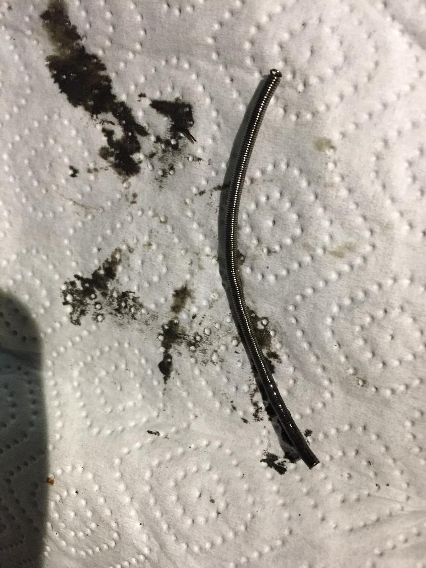

This spring came out of my 1961 Beetle“s gearbox yesterday during a routine gearbox oil change yesterday.
It is about 9 cm (3.5 inches) long and 2 mm (0.07 inches) thick. It was held firmly by the magnetic screw. No (for me) visible damages. Any ideas? Should I worry?
Thanks in advance.

Looks like the coil (garter spring) from the input shaft seal.

Thx that makes sense! Damn, engine has to go out...

Maybe that spring is from an earlier seal, has been in the transaxle for a decade???
But I understand: might be better to be pro-active and ensure that the current transmission shaft seal is OK, rather than risk oil leak and potential transaxle and/or clutch problems.

I wish you were right, but... no: I ve owned this Bug since 1987! I know that with this, I am still no match for you, but I changend the gear box oil three times in all those years and this was the first unpleasant find ever.
But thx for the idea anyway!
