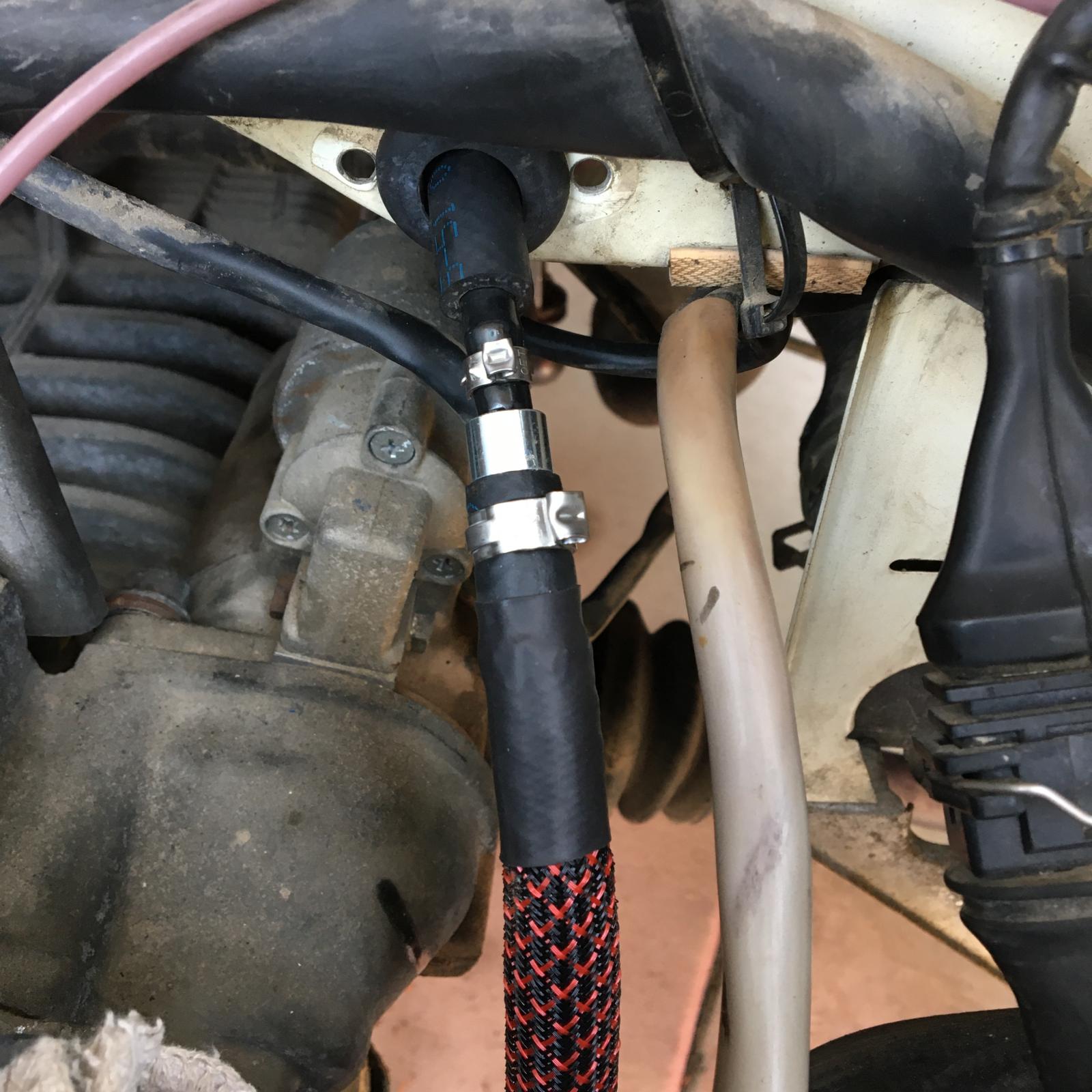

At first I was hesitant about the GW kit because it used the crimp-on connectors and it needed a special tool for that. In the end, I decided these would be the very best crimps and it would be worth it to go this route. I’m happy with this choice.

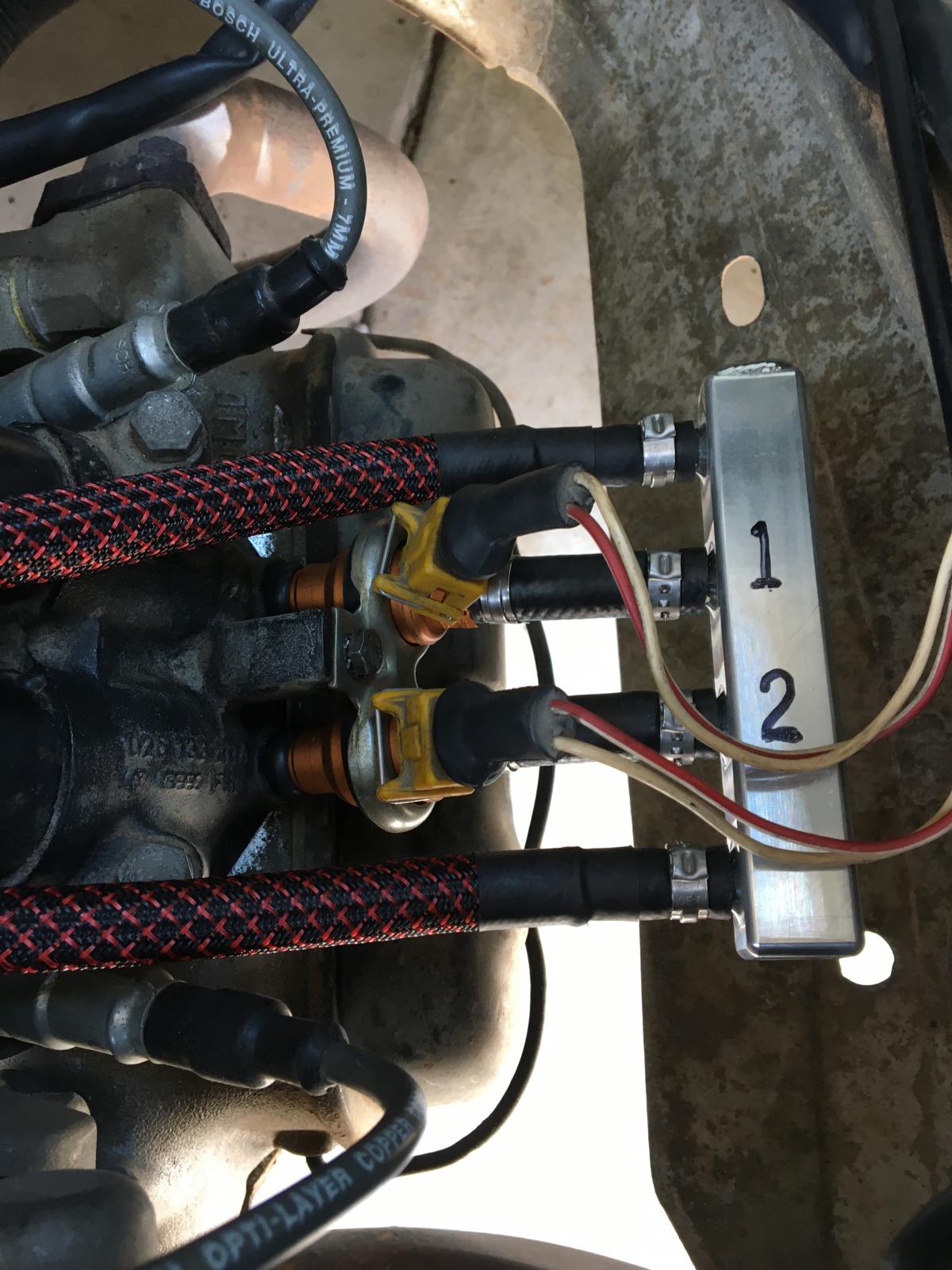

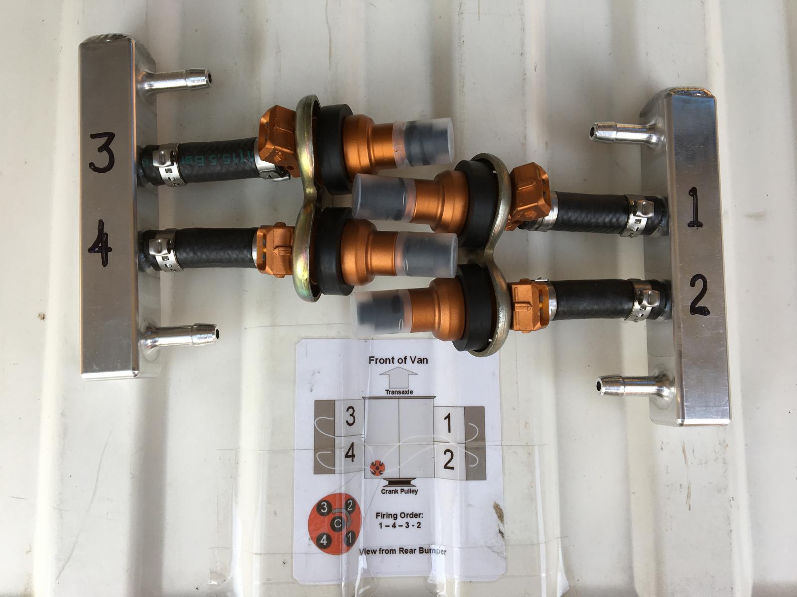

Part of the project also included replacing the injectors as well, so first I made up “assemblies” of the new rails and new injectors before installing.
Here's the assembly before I realized I'd put the clamping brackets on upside-down:

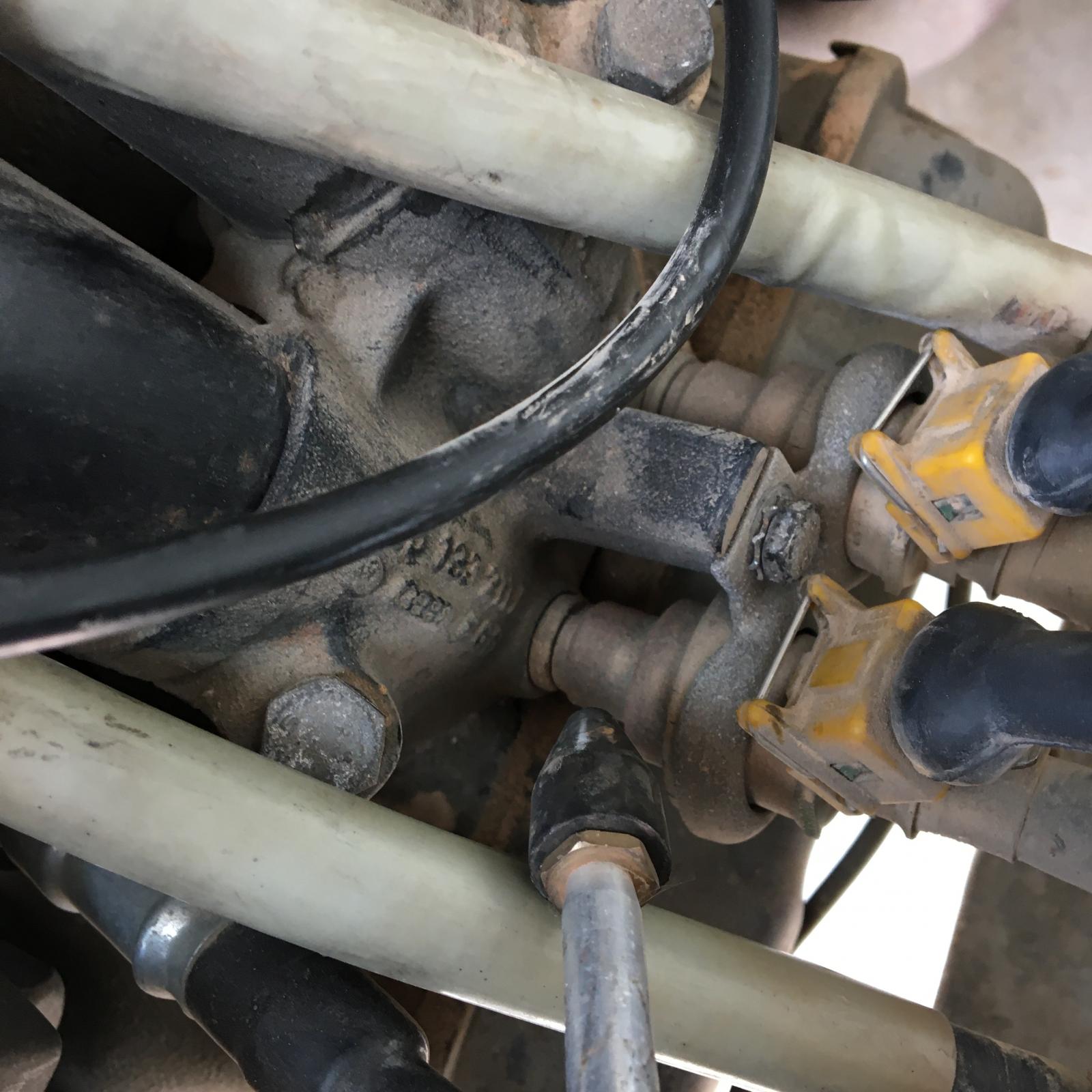

Next, I removed both pairs of fuel injectors as assemblies. Since this exposed the holes for the fuel injectors to dirt and debris around these holes, I recommend blowing the dirt & dust away before removing the old injectors.
To remove the fuel lines I discovered a “new” tool. I highly recommend this “cheap” $10 tool as it must have saved me more than an hour I would have otherwise spent pulling, slitting, twisting and tugging at the old lines.
It’s a hose separator tool:
https://www.amazon.com/gp/product/B07G5QSQFQ/ref=ppx_yo_dt_b_asin_title_o03_s00?ie=UTF8&psc=1
Highly recommended! Wished I’d had this years ago.
After the injector assemblies were out, I proceeded hose-by-hose, one at a time. I removed the hose, laid out it’s curved length along the new hose and cut the replacement to the same length. I put two lengths (about 1.25” each) of shrink-wrap tubing onto the sheathing to cover each end once assembled, Then I applied the abrasion sheathing to the hose. I found that for this size tubing, the length of the sheathing “shrinks” about 25% when its diameter is expanded to go around the fuel line, so remember to cut it about 20% longer than the hose. After the sheathing and the shrink-wrap on each end, about 1” of bare hose was exposed for the clamps.
When installing each length of fuel line, I placed a plug into the leading end, since many of these lines are AFTER the fuel filter and anything caught in them would go directly into a fuel injector. Also, remember to place a clamp onto the line before pressing it onto a fitting.
One-by-one, two lines feeding the injectors from the T and two lines returning to the pressure regulator. Another from the firewall to the T and the return line from the regulator back to the firewall. Pretty straightforward.
Used this very nice Knipex brand tool to crimp the “Oetiker” clamps.

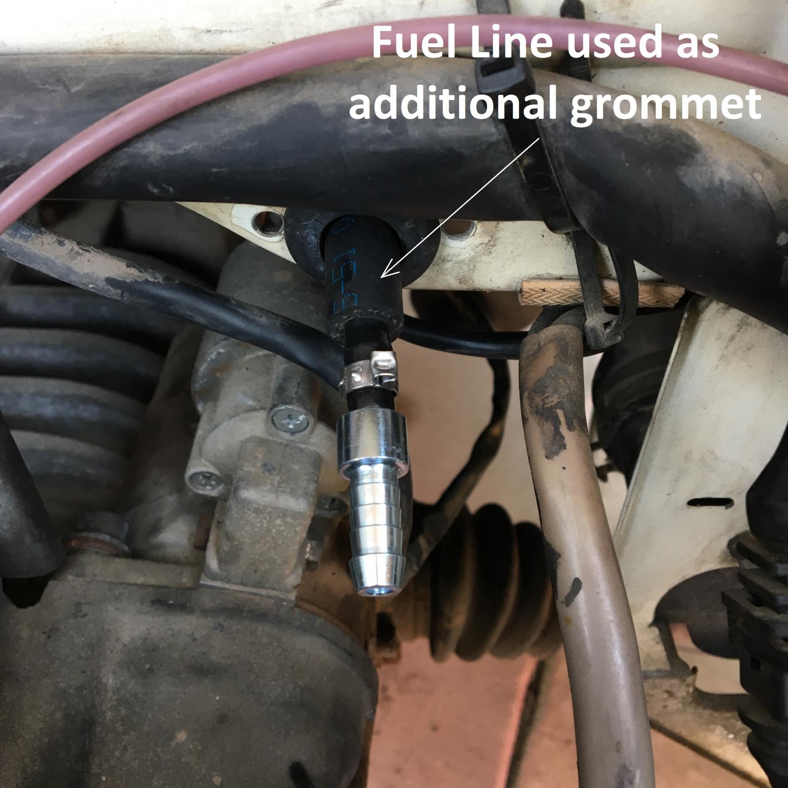

Next, I debated about the need to replace the plastic lines. After removing the old and “almost ready to crack” plastic firewall fitting, I found that on the forward side of the firewall is a section of rubber hose about 3” long before it transitions to the plastic line. So, in the original configuration, there are TWO clamped junctions in a difficult to see and difficult to access spot above the starter and forward of the firewall. One clamp is used between the firewall fitting and the hose and then another clamp between the hose and the plastic line. Not wanting to leave it this way, I decided that using the new plastic line kit was very useful after all. I cut the new plastic line about 5” longer than the original and ran it through the hole in the firewall so that the plastic-to-rubber transition would now be easily accessible. I put the GoWesty supplied grommet into the firewall home and then pushed a couple of inches of fuel line over the plastic tubing to additionally isolate it from wear in this spot.
Note that pressing the metal barbed adapters into the plastic line requires a bit of force and is best done while the line is out of the vehicle instead of after it’s installed. Remember to slide the crimp clamp onto the tube BEFORE the barbed adapter. Only one thing was irritating about replacing the plastic supply line, it that it was clamped to the brake-line distribution T which is above the main coolant lines, above the heater lines and above the shifter rod. It’s easy to see but difficult to access, I got the old line out OK, but then had to remove the shifter bracket and drop the rearward part of the linkage to gain access to re-install.
I replaced the large diameter hose between the tank and the pump with a full tank of gas, trying to spill the least practical. I got a plug ready to fit the old hose and positioned myself at arm’s length from the pump. I got the hose smoothly 90% off the pump with the new hose separation pliers. Then slipped it off the pump and put the plug in within about a second. Put the new hose on the pump, then swapped out the end at the tank, hardly spilling any. That is, until I forgot the hose was full of gas and just laid it down. Oops!

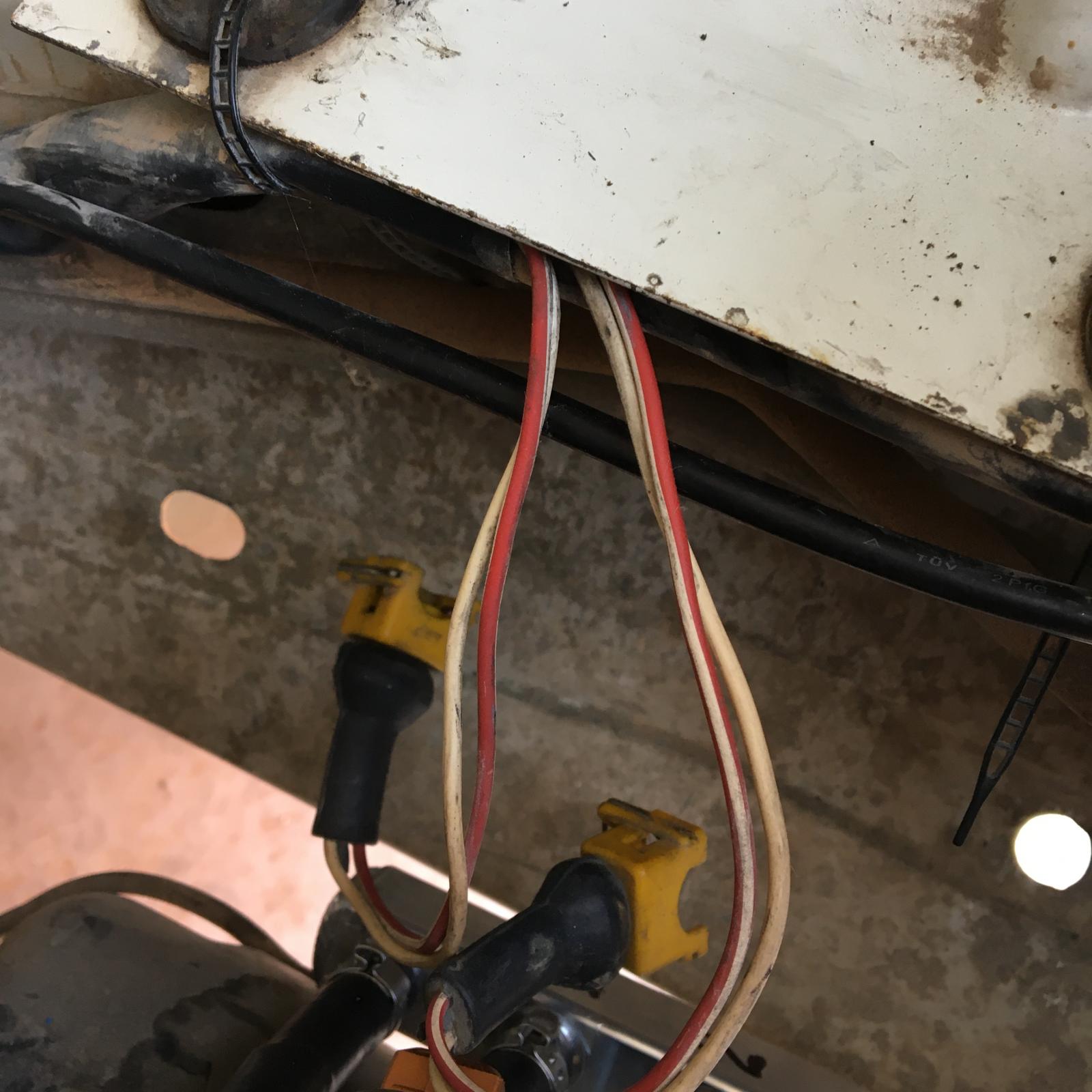

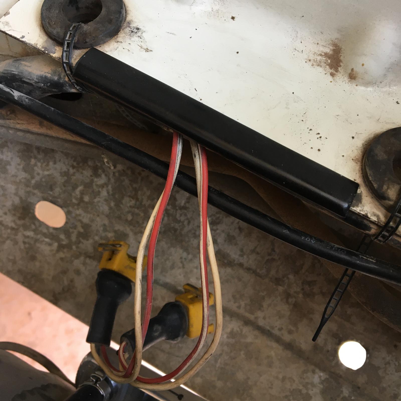

Fuel Injector Wiring:
When I was about to reconnect the fuel injector wiring, I noticed that the wires pass by the edge of the mounting bracket that holds the air filter box. There was no wire chafing apparent, but took an extra few minutes to add an “edge grommet” to the bracket just to be safe.

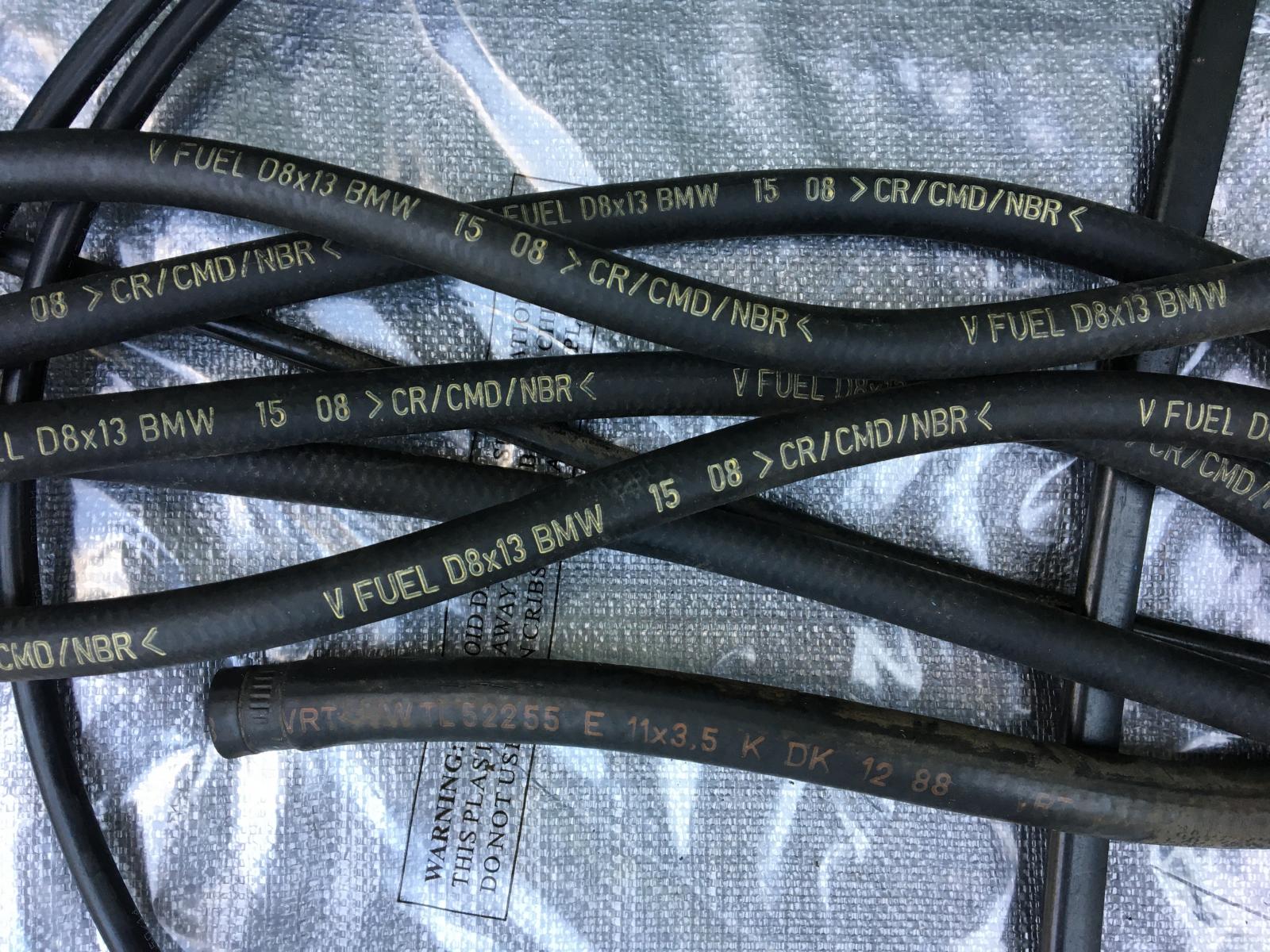

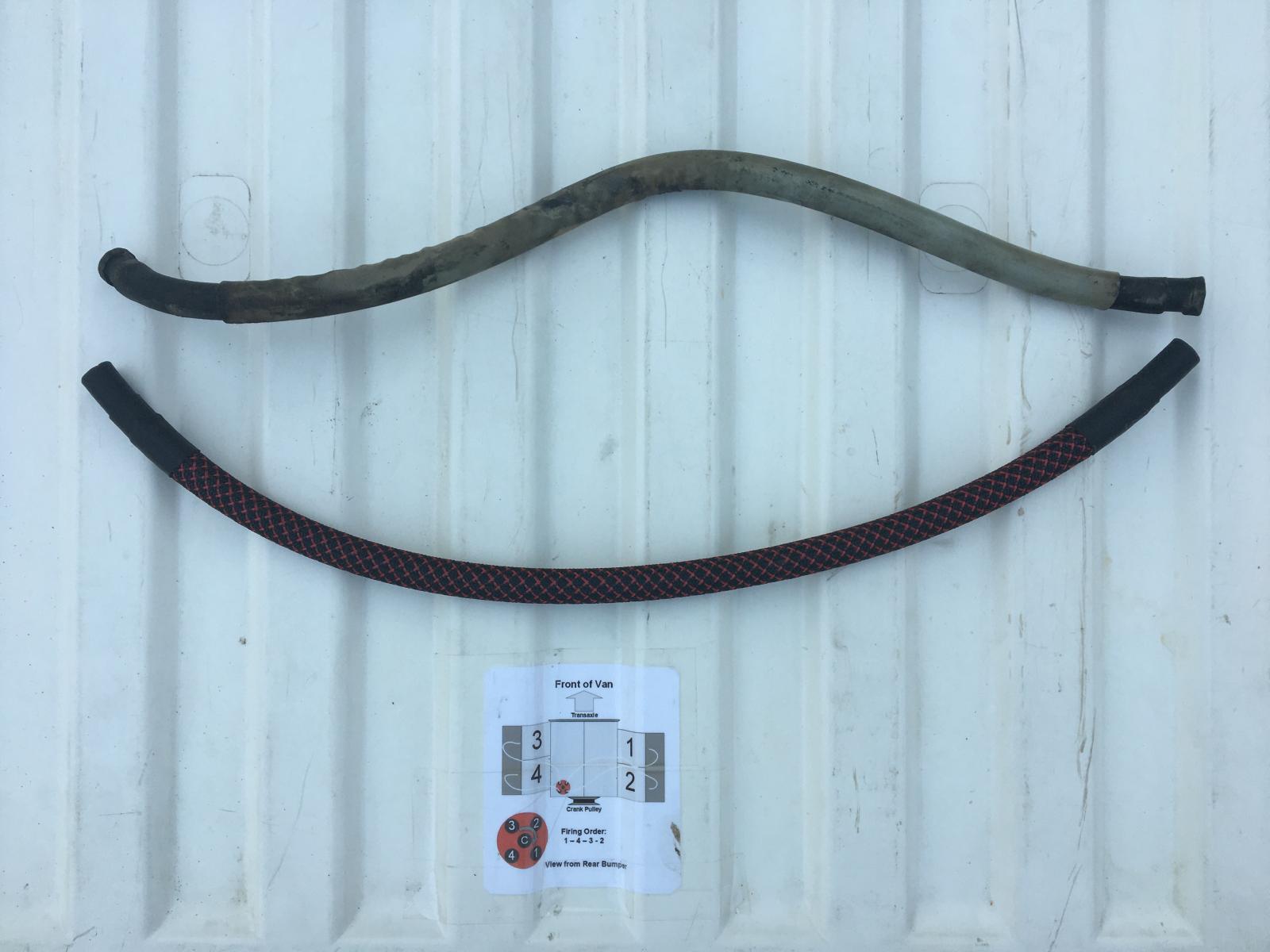

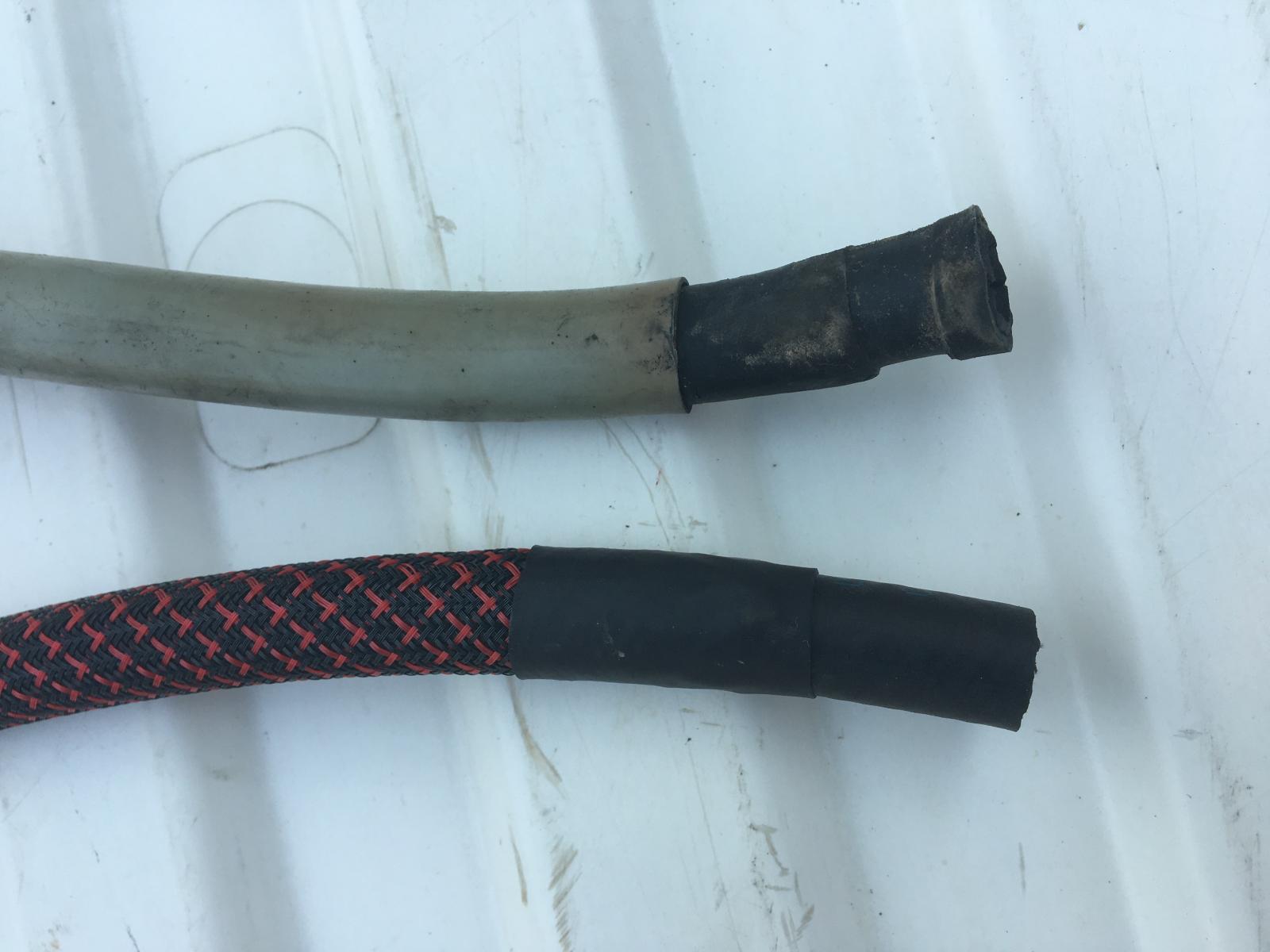

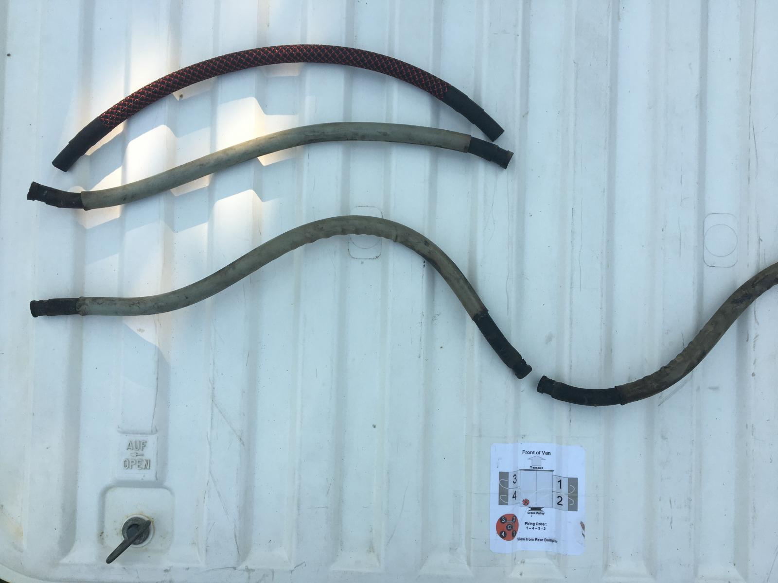

The Old Hoses:
After removing the old hoses, I pulled off the original plastic sheathes to see what the old hoses were. Turns out that the hoses in the engine compartment had indeed been replaced by the previous owner, They’re labeled “V FUEL D8x13 BMW 15 D8 >CR/CMD/NBR<”. At 8mm, a bit larger than the appropriate size, and being BMW, likely a decent quality. Looks like the hose linked below is almost identical to those I removed, but marking only slightly different.
https://www.amazon.com/BMW-Genuine-Fuel-Hose-13/dp/B00DD9JH4K
Old hoses:
Still, don’t know how long they were in there, but at least 9 years from when I bought the van in 2011. The larger diameter hose from the tank to the pump did appear to be original. Labeled “VRT VWTL52255 E 11x3,5 K DK 12 88”. I’d guess this “12 88” portion might be December 1988, since my van is a 1989 model, but that’s really speculation.
I’ve yet to replace the low-pressure return line from the fuel pressure regulator back to the tank, but I wanted to write down my experience here before I forgot all about it!

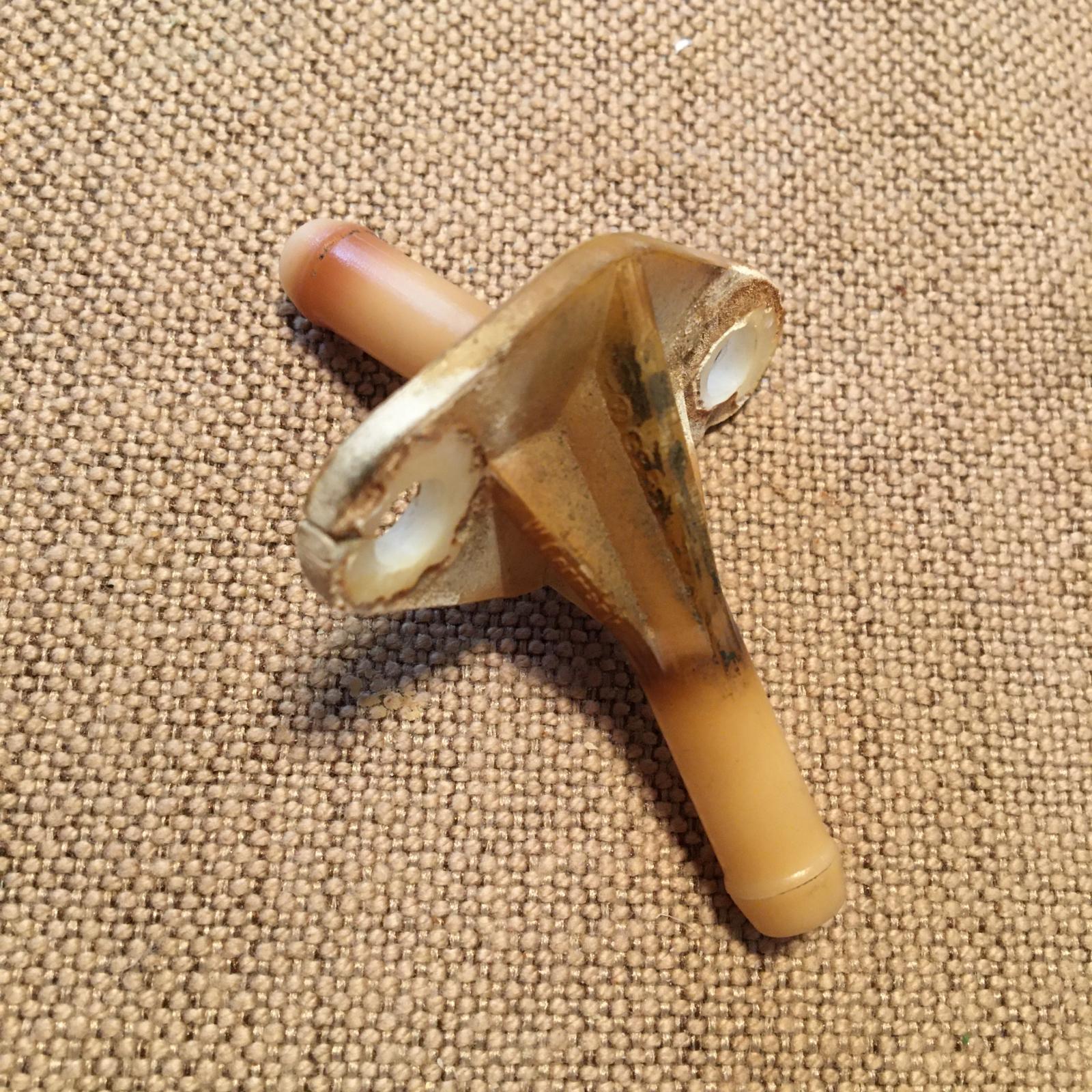

Old Firewall Fitting For Sale:
Get a vintage fitting for your fuel system here! Not leaking yet, but may at any time. You too can experience the excitement and angst of a Vanagon fire. Just $50! Laughing

My original gray sheathing was VERY still and pretty ugly. I'd say the difference is mostly cosmetic as I could have shoved my new lines into the old sleeving. I hate to do a bunch of work and then still have it look crudy!
I think the original lines lasted about 20-25 years and vans that have not had theirs replaced yet are now 30-40 years old. Still some "hanging in there", but you never want to find out exactly how long these last. Now a good questions is "How long will new lines last?" I'd say that new lines are much better than the original ones, but at the same time fuels have changed a lot. Our lines are now subject to a variety of fuel blends unseen in the '80s. So, my answer to my question: "I dunno". Think
Bottom line: If you're unsure, replace them.
My big fuel hose from the tank to the pump now has a date written on it in silver Sharpie and I made a sticker I placed on the firewall that says "NEW FUEL LINES 8-22-20".

[b]Plastic Line Replacement, Fittings, Grommets, and Clamps:
This is great, Jim. Thank you. I am going to do this set up on mine. I definitely like having the barbed connector on the engine side of the firewall.
I'll need a couple of these because the old ones are crispy: https://www.gowesty.com/product/tools/25191/vw-cable-tie-barbed-mount?v=
You're right on that clamp at the brake T looks pretty hard to get to.
Still available?

I just want to reiterate the use of the right clamps here, just like new cars m today. Okay, and my family gets 0.25 cents per crimp.

1/ Were the injectors rebuilt and tested? If so, by whom?
2/ Whose fuel line bulkhead fitting did you use?

PostPosted: Sat May 08, 2021 10:05 am    Post subject: Re: Replacing Fuel Lines and Fuel Line Research - with Pictures Reply with quote
J30R14t2 is the newer standard and has far less permeability still.
Gates Barricade and similar.
The last R9 I took off had hardened significantly though it was just a few years old. I didn't look close enough to see any microcracks, just a cut to the inside gave it a quick glance and kept going.

PostPosted: Sat May 08, 2021 10:37 am    Post subject: Re: Replacing Fuel Lines and Fuel Line Research - with Pictures Reply with quote
Nice detailed posting indeed! I have dealt with the polyamide plastic fuel tubing for decades. I still have a bunch of different sizes of it. Cohline makes a tool for pressing it onto the fittings but I have never used it. I always took a cup of very hot water and put the end of the tube into it. After heating it push the tube onto the fitting. It pre-dates PEX tubing but acts the same way. It's memory makes it contract onto the fitting. Look at any K-jet car. You will not see any of those joints clamped. Belmetric has a nice selection of Cohline tubing and fittings.
I used to be a purist and only used Conti 7 mil hose. I now use Gates Barricade 5/16. It is readily available and works fine. I usually use ABA screw clamps since that is what that the manufacturers used on FI hoses. But I recently did my 91 Carat and reused the blue spring clamps on the Barricade. I really need to get some of that cool looking abrasion sleeve.
Thanks.

PostPosted: Sat May 08, 2021 1:57 pm    Post subject: Re: Replacing Fuel Lines and Fuel Line Research - with Pictures Reply with quote
please be aware that the J30R14t2 standard does NOT ensure the hose is rated for a 225psi working pressure. there IS 100psi working pressure hose that has a J30R14t2/J30R7 rating. and there IS 225psi J30R14t2 hose.
the J30R9 rating assures it has a working pressure of 225psi and will always work. you must do careful research to ensure your J30R14t2 hose is also rated for 225psi.
-dan
