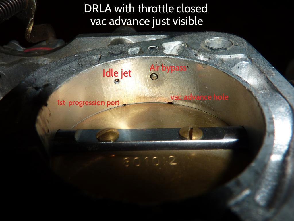

Are they installed already? If not, set the butterflies so that the bottom of the lowest progression hole is just barely exposed. Check that they are all showing, ie. you don't have a bent throttle shaft.
Borrowed this image from the gallery so you can get an idea, look at the hole on the left.
Another one, i think this one is a bit too far open

They are on, and running, I just wanted to check everything over on my settings
I suppose I could pull the plug covering the progression holes and check that way.
That is the best way-may need a lighted mirror to make viewing easier. I bought a Husky brand tool like this at Home Depot that has come in handy.
