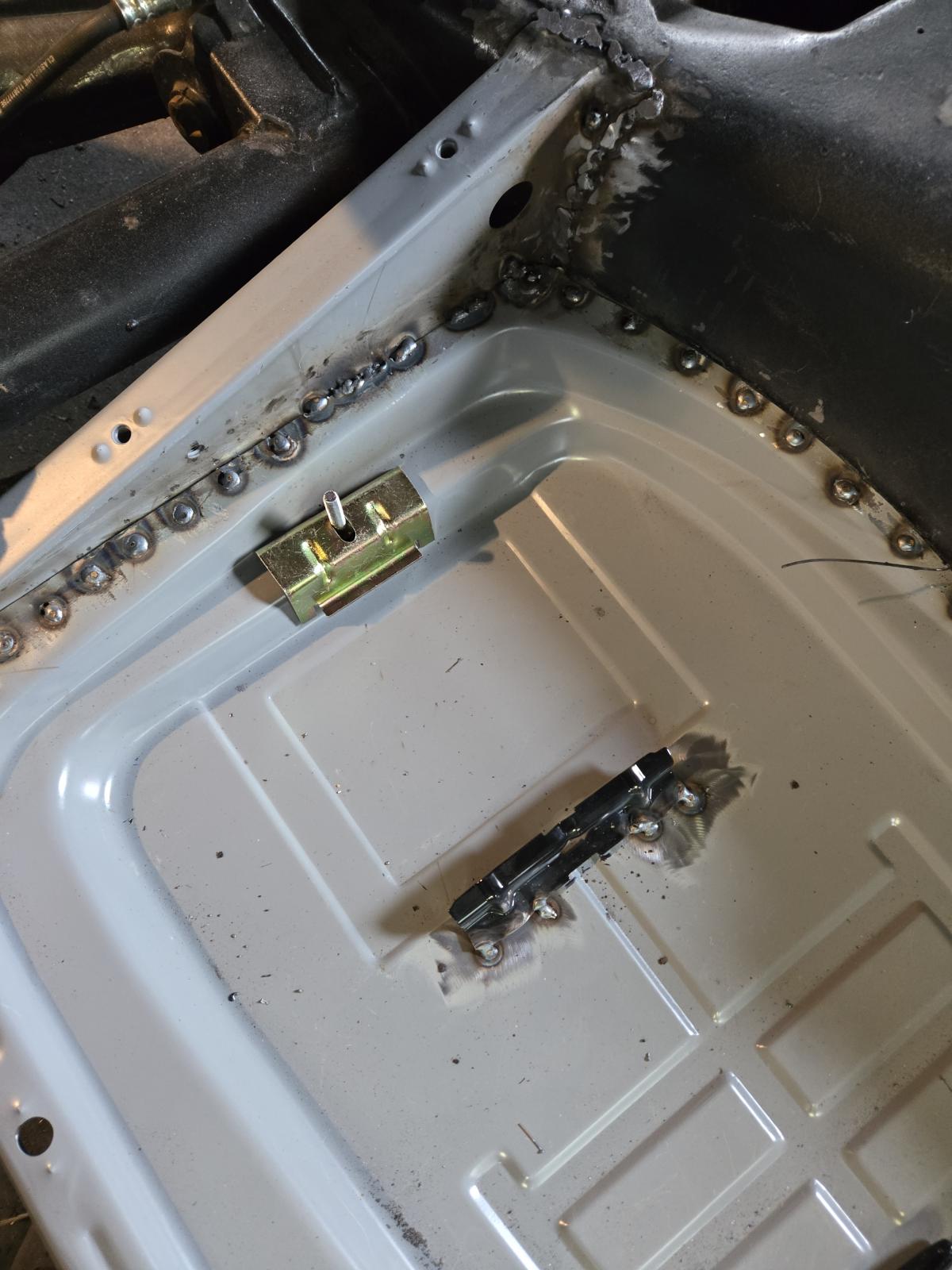

Compressor draws 15 amps, Hobart 140 draws 20 but the issue turns out to be the weird wiring in my garage. Long story short, I found the answer on the Hobart website and after changing the breaker, I was in business. Welded the pans in last weekend and the 140 worked perfectly the whole time and the house did not burn down. Not the prettiest welds but they are strong. Thanks for the offer though.

Those aren’t bad. Dress it up with the grinder and it’ll look factory. Good job getting it done. Now that you did all that work how much would you charge for it?

The welding was the easy part thanks to YouTube, I would do that for $500 I understand that customer prep is probably not usually the best though so I understand that shops don't believe it when you say it is ready to weld. Prepping everything was what took time. The Wolfsburg pans are nice and I had to do very little to get them to fit properly. I tacked it down and dropped the body on the pan to be sure but all of the holes lined up perfectly on the first try. I had a lot of welding experience with tig back in the '90s but not as much with mig (metal has to be clean either way) and it took me about 10 hours over two days to get it all together. The recommended settings from Hobart were almost perfect and I'm super impressed at how easy the 140 is to use. Now I need to figure out what I'm going to coat it with, I thought Por15 but after some research I think epoxy prime and Eastwood chassis black.
