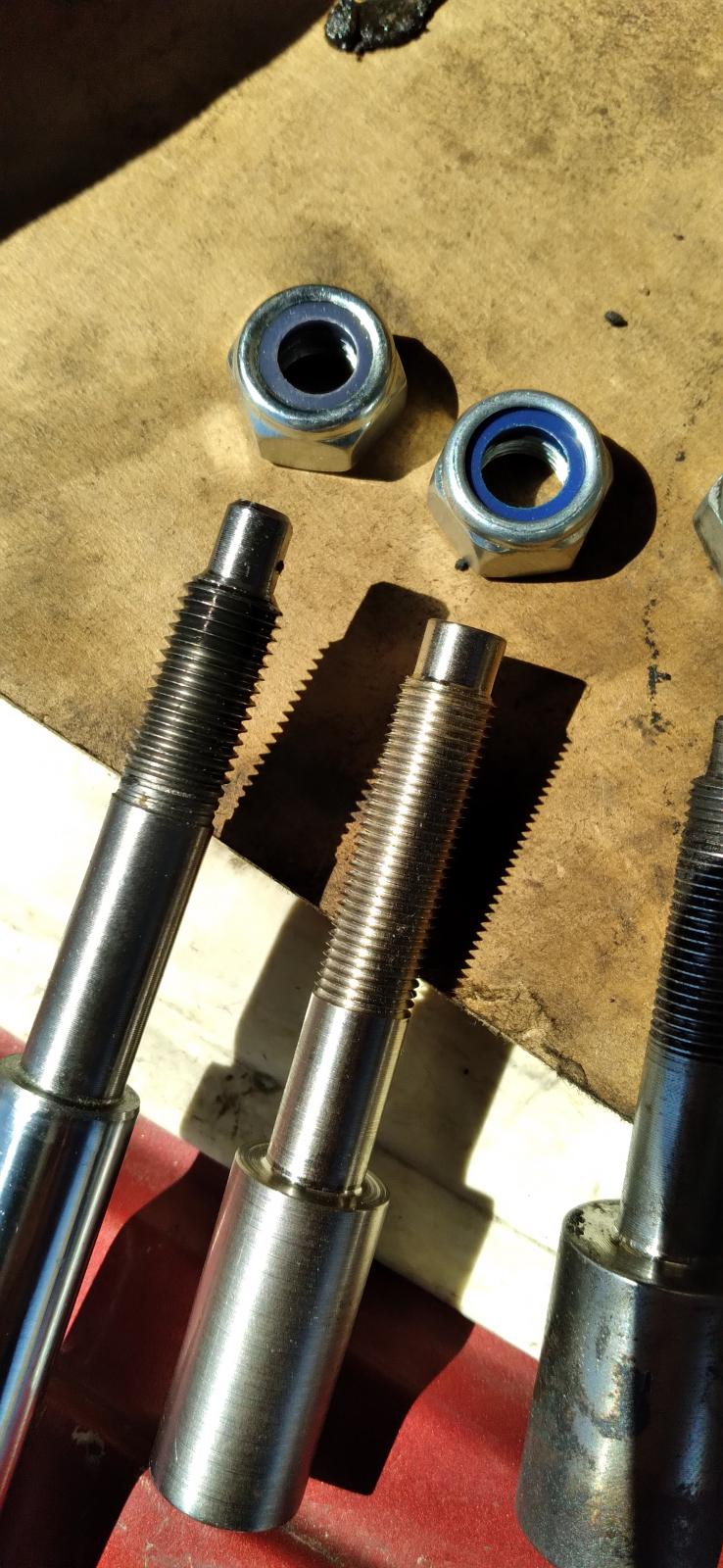

I broke a front OME shock on my syncro, so I installed Bilsteins. The Bilsteins feel better on the road. I also have GW progressive rate 2" lift springs. Note, the thread is different on the Bilsteins, which may be a problem if you have shock extenders. I kept them off. Just needed to compress the lift springs more to get the nut on.
