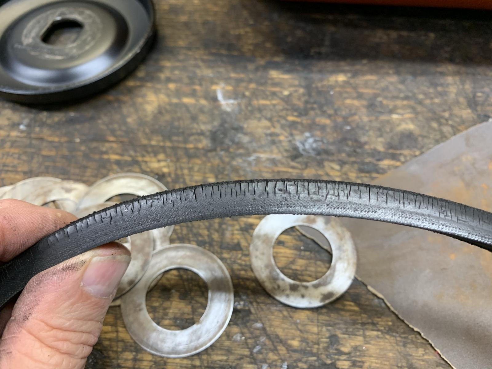

I found several leaves and pieces stuck to the vanes. I got what I could and hoped for the best, makes me wonder what got past and is further down line. Then I started looking at the fan belt and noticed the cracks. It’s 10 years old at least so I changed that too. If you look close you can see it’s been slipping and left glazed appearance. So it pays to check stuff every once in awhile right?

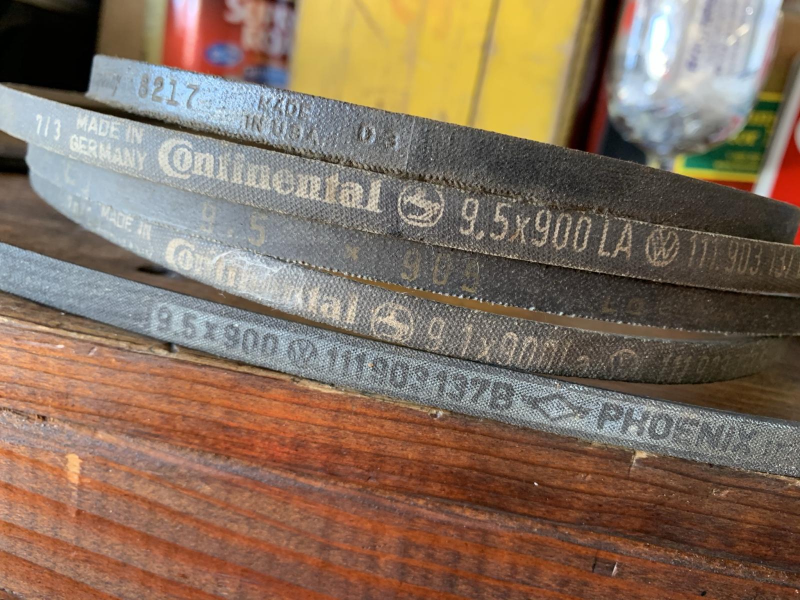

Here’s some old belts I probably should have thrown away years ago, they are just something to look at now

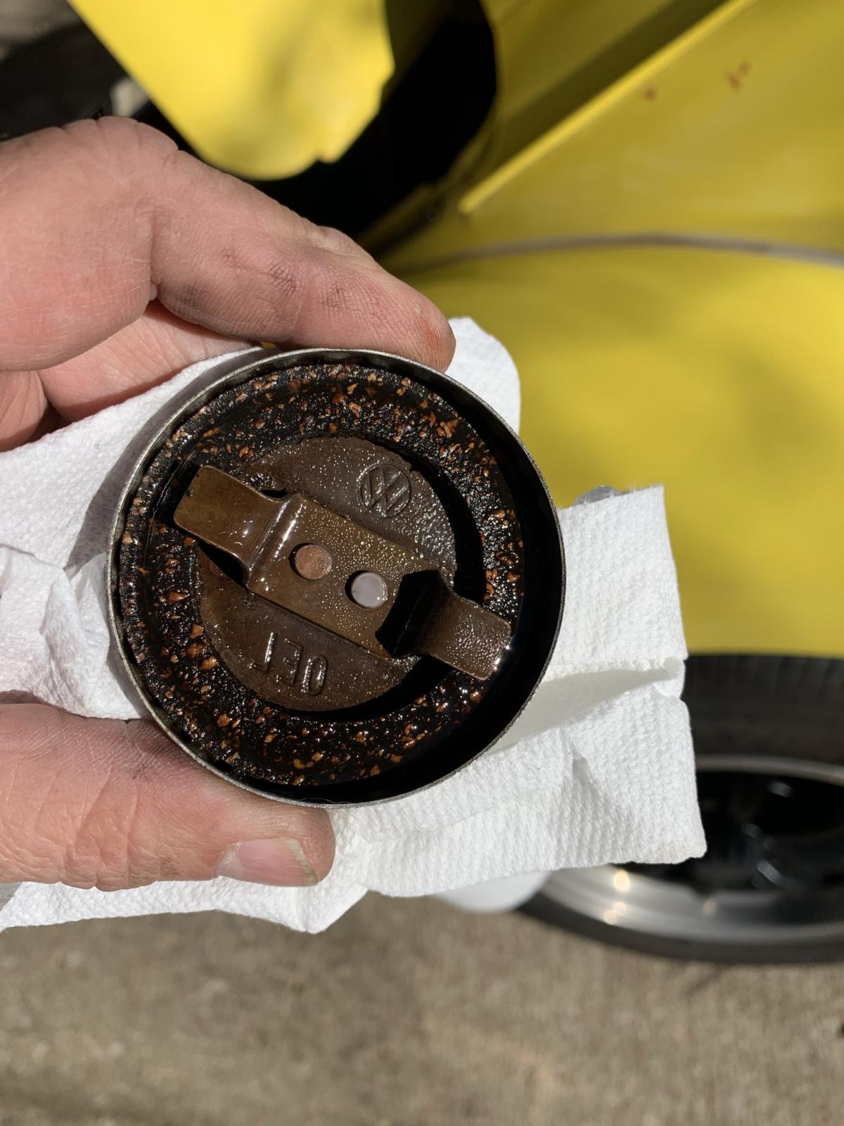

I’m looking at this cap again to see if I’m getting engine up to temp, don’t want to see any white gooey emulsified oil. This ones good so top it off and hit the road
