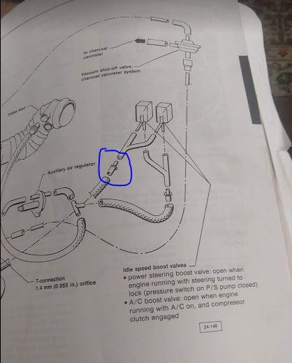

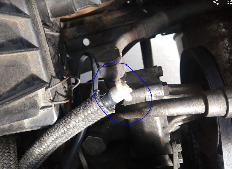

I'm going to mark this topic as resolved. After I removed the air box, I saw that one of idle boost valve hoses was completely disconnected (I think the idle boost valves were only around in 83-85's??), the nipple of the hose reducer had broke off, I must have broken it completely when I put the air box back in after I changed the plugs.
Here is a pic from the Bentley
So I took that broken part to the shop I go to and Norm said no longer available, maybe go to a hardware store, you might be able to find a brass one. Then he said you can just cap the ends of the hoses, you don't really need them. So I went home and capped the hoses
Golf pencil and electrical tape in the skinny hose
I wrapped the broken reducer with electrical tape and shoved it back in the braided hose
Then put the air box back, and had the wife start the van. Nothing. Then realized I forgot to plug the AFM back in, after that, started right up, idled just fine, maybe even a little too low, right around 800. Threw the pooch in the van and took off down the freeway 5-6 miles, then took back roads home. Got home, took a look again at the fixes, they seemed to have held, so we got shit loaded up and took off for Lake Mead, about 340 miles, no issues!!
Sunday, we took off for Lake Havasu State Park, about 140 miles away. No issues. Got to the campsite and parked, then wife said, can you move about 10 ft forward, so started the van back and POOF/POP sound and the van wouldn't start, so we unloaded the shit, took engine cover off and yep, the plug in the braided hose had blown out. I look on the pavement and there it was, so I took the electrical tape off, and put duct tape on it, shove it back in the hose, wrap some more duct tape around it and the hose and it started right now, idled just fine. Yesterday, drove home 300 miles, part of which was in 90+ degree heat, no problems, got 18mpg.
What do people use for capping hoses like this? Is there a chance I can find an actual hose reducer that would fit this? Should I just remove the hoses and just wrap the valve ends with tape?

Pipe dope on the threads of a bolt with a hose clamp will be effective.

Why not fix it? You should be able to get some brass fittings from the hardware store to cobble something together if you can't find the correct part. One valve raises the idle for the power steering load. The other valve raises the idle for when the AC is on. The auxiliary air regulator is also part of that hose system. It maintains idle speed during warm up. All handy features when they work.

If it's a simple reducer, hose barb on each end, try McMaster-Carr industrial supply. They have all sorts of things like that. Here's a fancy one in aluminum:
https://www.mcmaster.com/hose-reducers/choose-a-co...and-water/
But they have them in various types of plastics and other metals as well.
