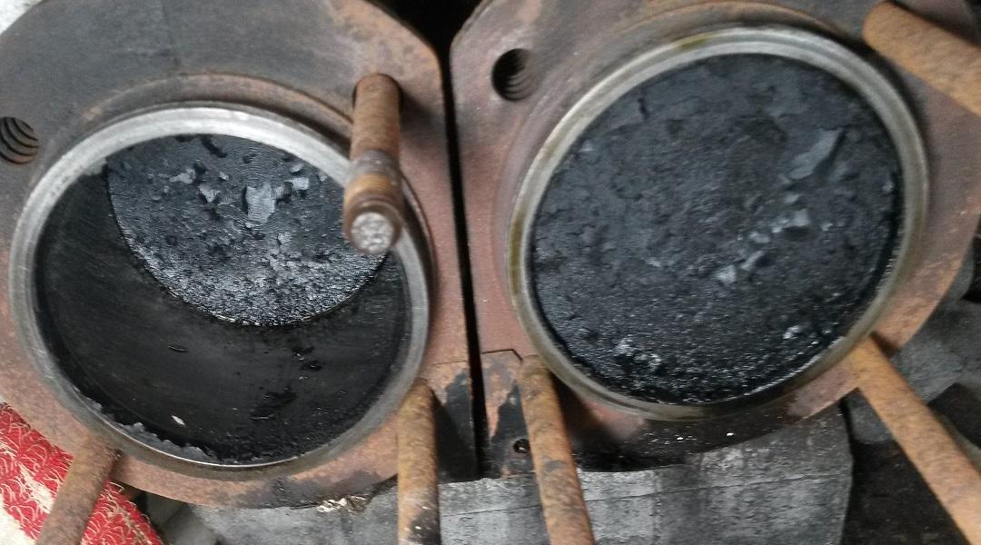

The crank TURNS !!!
Since cyl#3 was the one most likely to be rusty (was left with exhaust valve open and no header) and since it was in the early part of an exhaust stroke, I didn't want to turn the crank forward and possibly push rings into rustyness. So I put my torque wrench on the flywheel gland nut. And then, well before getting up to 10 foot-pounds, the crank lurch'd over an inch (as measured on outer rim of crank pulley) ~20°.
Cobbled a skateboard scooter under the charcoal grille base I used as a sort of wheel burrow when stashing this engine. (Both items pick'd from neighbor's trash.) Now I can move it so easily, it's a joy!
Cylinder #3 had none of the rust I was worried about; just some oil soak'd carbon deposits. Both (#3 & 4) pistons had an awful lot of caked carbon. Not bad tho, considering how long it sat in this position. It was surprising to see so much oil, 'cuz I had drain'd the oil when stashing the engine over 28 years ago.

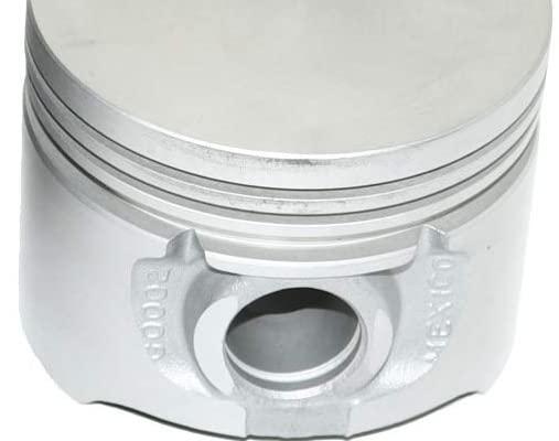

More careful checking of piston to cylinder gap shows that the out of round issue is almost entirely due to piston wear in the area near ends of wrist pins. I won't be using those pistons or cylinders, other than for mockup and comparison. Have no desire to go back to the 1500s either. Looking into replacement P&C sets, I got interested in Moresa. They're an original equipment supplier for the Mexican Beetle. And the price is pretty reasonable ~$175 USD per set at Amazon (free shipping). But what's most special about them is the side design in the area of wrist pin ends, where my old set shows excessive wear.
There's a problem, tho. For whatever reason (maybe due to low octane Mexican fuel?) the piston height from pin to crown is a bit short, and/or cylinders are a bit long, because...
vintagecarleds wrote:
The problem I have run into Moresa P&C kits is I always get too much deck height, right around .081-.091"
Using .081 in CB Performance's engine calculator page indicates 6.8:1 compression ratio, and .091 indicates only 6.7! If it weren't for this, I'd've already bought the Moresa set. Arrgh! I'm looking to have something more like stock compression ratio was in late 60s and early 70s, 7.5, according to my Clymer Productions reference:

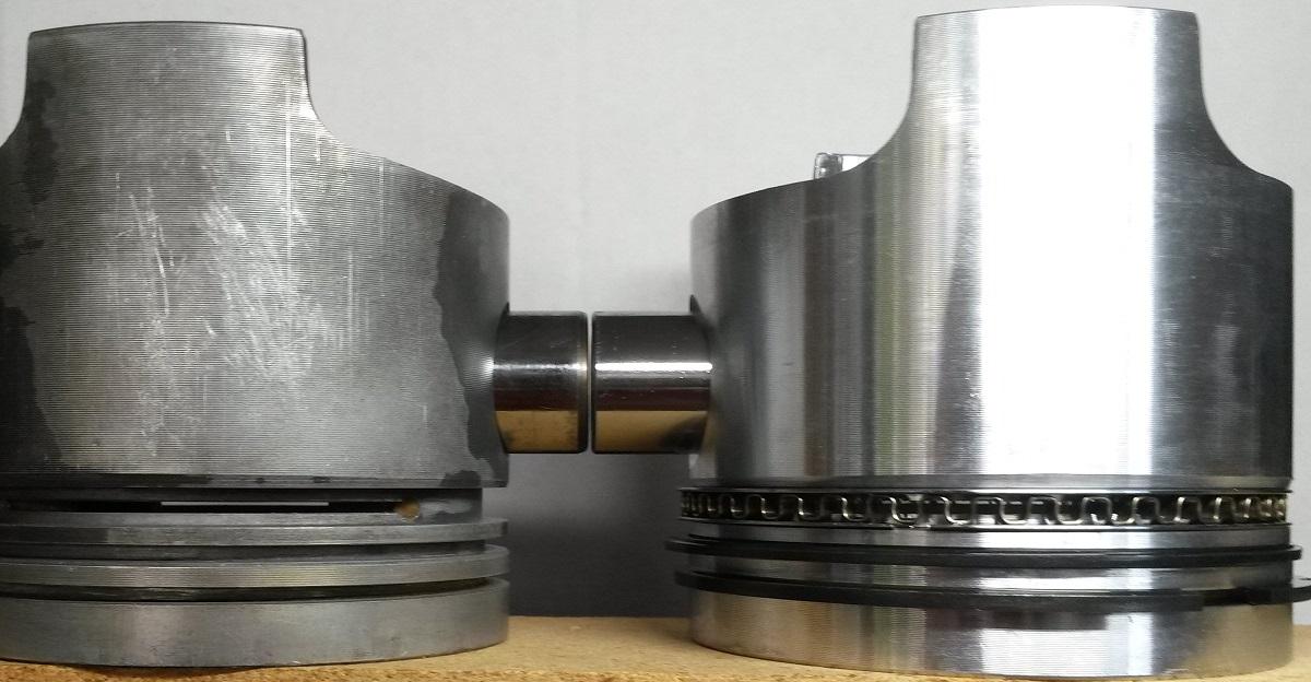

Pistons compare very closely with the used set, which was purchased 1981:
Best I can measure, they result in 0.069 to 0.070" deck height. This will give me 7.0:1 compression ratio (unless I can find a way to have 20~30 thousandths shaved off cylinder height, and get 7.3~7.4 CR).
