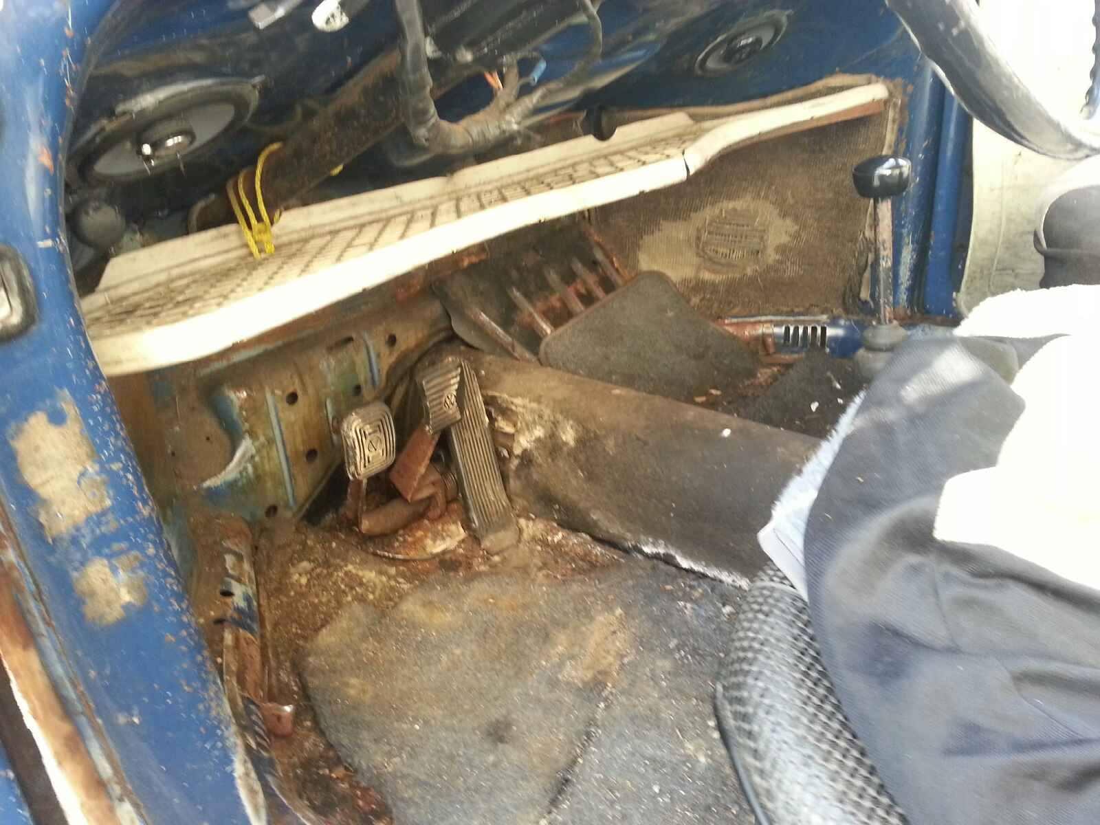

Onto the car itself. The only real rust that I have found is passenger floor board right behind the seat to under the battery tray. I have a new patch panel for it and it should be in there this sunday, hopefully.

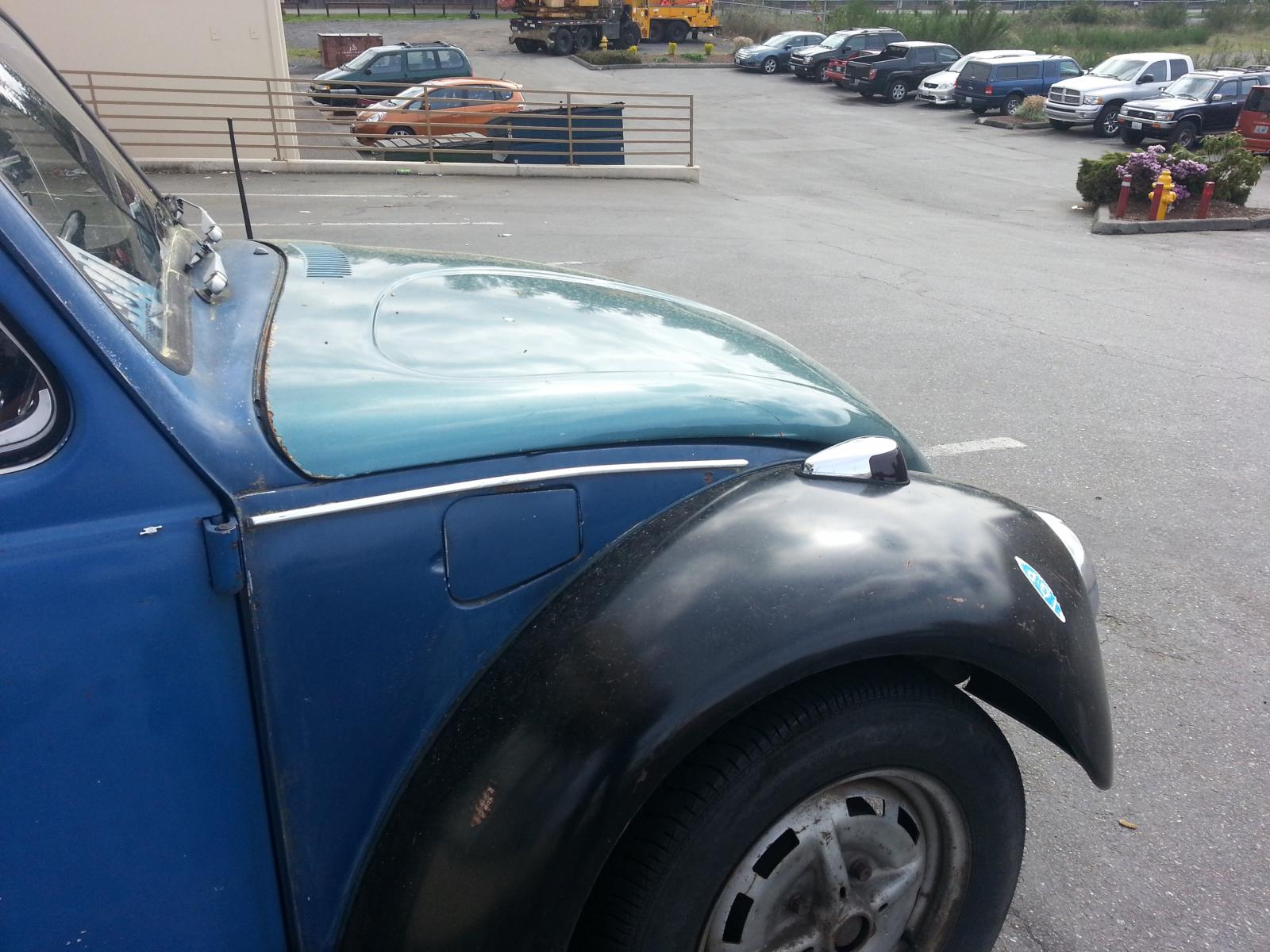

Next is the hood. Found a new one but wasn't from the right year so it fits a little rough. still looks a lot better in my opinion

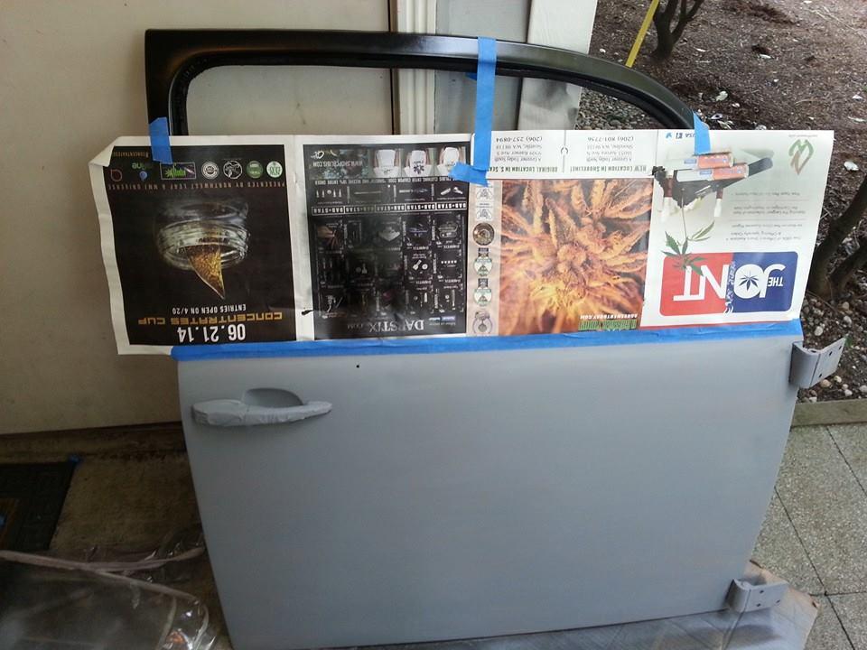

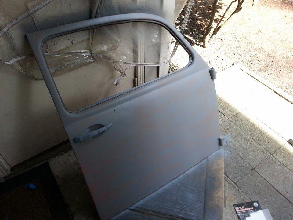

Got some one piece window doors, painting them the color scheme that I want the whole car
Finished product. actually doesn't look to bad in my opinion Surprised

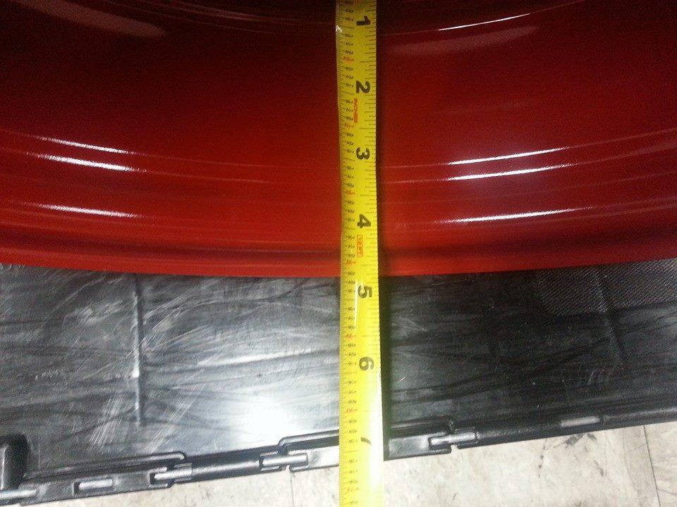

Got my front beam on craigslist, 5" narrowed adjustable ball joint. Also got my wheels in as well.

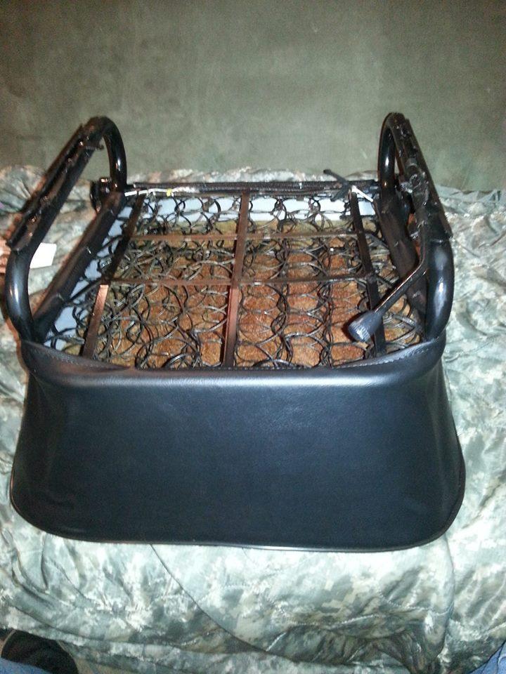

Started to re upholster my seats, then found out I have the upholstery for low back seats, I have high backs. Go figure Rolling Eyes

Also maybe you guys can help... my hood that I got Ive found is off of a later bug Sad so it doesn't quite fit right. Is there a way to get it to sit properly or am I screwed on this one?
I can actually put my hand inside the gap into my trunk.. very annoying

How does it fit down at the latch/apron area? If your car has been hit hard enough in the front the apron might have been shoved backwards a bit. If this is the problem you'll have to look at it & decide what the best way to fix it will be. You might be able to apply some light tension to the front with a come along and use a hammer and dolly to work it out. I'm not a body man but if the damage is slight you'd be surprised what you can accomplish with a cheap set of hammers and dollies. It's also possible that the hood is a bit sprung out of shape. It might help to open the hood and sort of pull up (not really hard but somewhat so Confused ) on the very front of it. Just stand at the front of the car and give the front of the hood a couple of tugs upward. It can help spring it back into shape.

Look in your spare tire well on the sides. Are there wrinkles there? Likely that the front got punched in a bit. standards 68+ should all take the same hood. Only differences being there are some out there without the vent for the fresh air box. Look at the old hood, any wrinkle or crease there, towards the middle maybe. This would indicate some front end damage. Like SBD said...it can all be worked out with some force. My bug had front end damage when I got it. It's squared away but the hood still doesn't fit like it should. Just got to the functional level, and no one would notice if I didn't point it out.

The original hood was pushed in a bit, enough to where it creased the passenger fender by the headlight. I beat the dent out to the best of my abilities and the front apron didn't look bent out of shape at all. I was messing with the spring on the latch trying to get it to lower a little bit with no luck. the only other thing I can think of is maybe the hinges got pushed up a little? Im not to sure..

Inner well of fender is probably banged up. Mine took a bit of pulling to get it to seat nicely again,but looked probably worse than your at the start.
