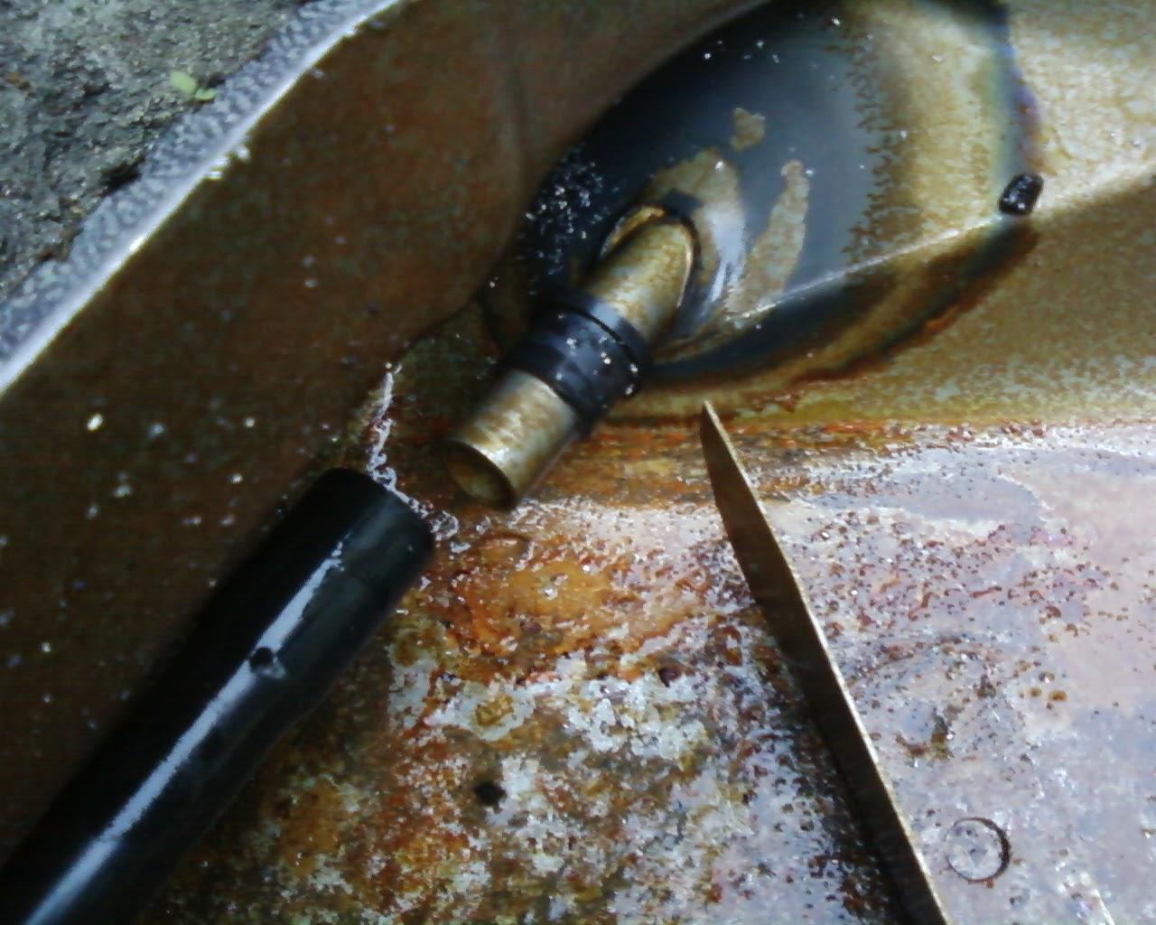

PostPosted: Sun Dec 13, 2020 8:54 am    Post subject: Re: No start when parked nose-up; otherwise fine Reply with quote
Food for thought. This is how the plumbing inside the tank looks. With low fuel levels, the pick up may be uncovered on a slope.

PostPosted: Sun Dec 13, 2020 9:11 am    Post subject: Re: No start when parked nose-up; otherwise fine Reply with quote
I agree, easiest thing to do is fill the tank, then park on the hill and see what happens. Then if no start, do the rest of the recommended tests.
This can also happen...
