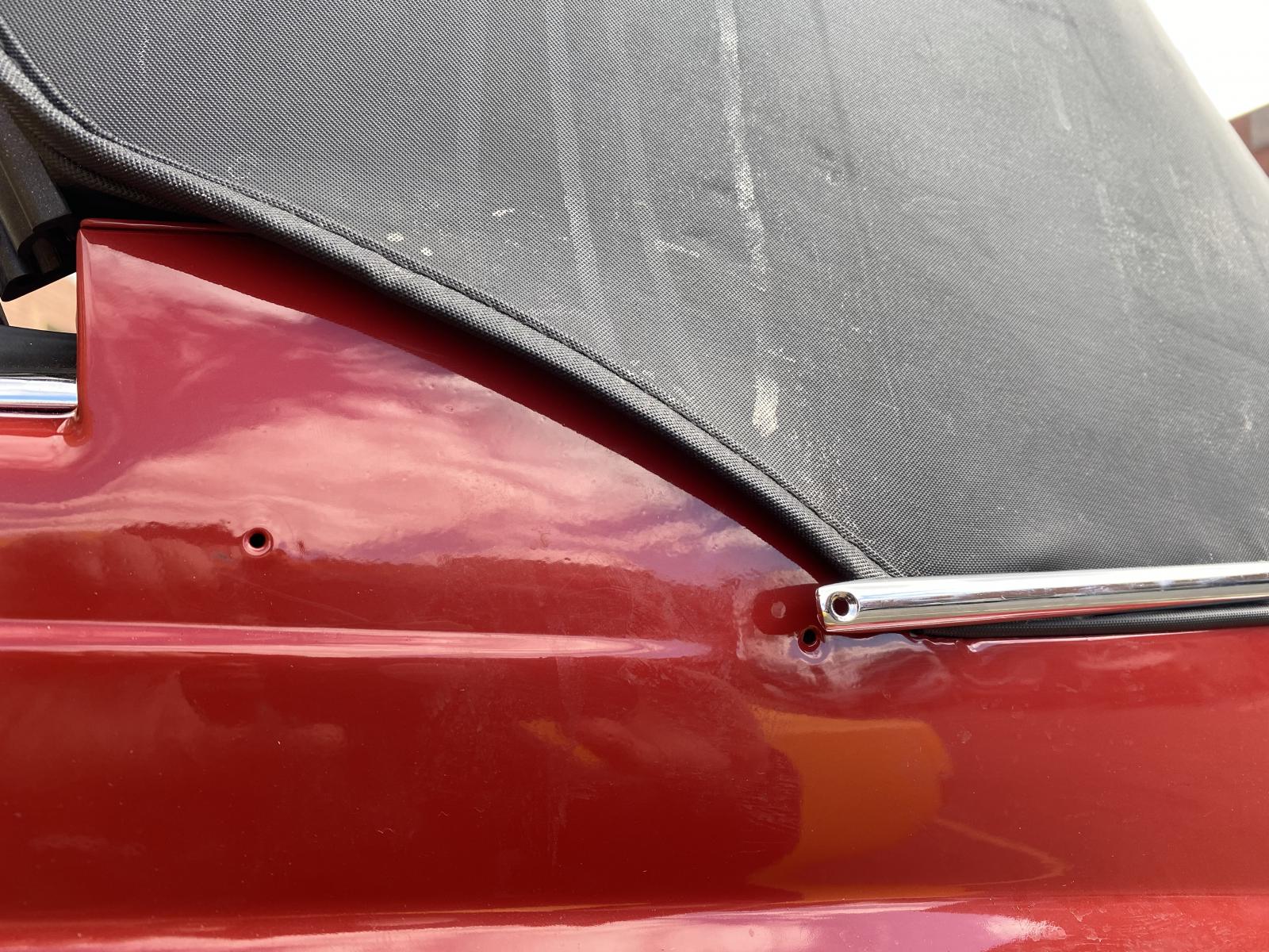

Putting on the top for my early 1967 Beetle convertible, the upholsterer noticed there was a hole near the top, but that the top didn't seem to cover it. Talking with Chuck, he said some convertibles had the hole, and some didn't, but they were to attach the trim which goes along the bottom of the top (if the trim was screw on). The "some had them, some didn't" seems a bit strange for a company that built thousands of these every year, so I wanted to see if others had this hole, and if their trim was screwed into it (I know the trim in my picture needs to be trimmed, no pun intended).
Chuck suggests the top needs to be stretched down over the hole, but it really doesn't look to be enough material to stretch. Does anyone have thoughts on how they have handled this?
Thanks!

I think there is supposed to be a metal snap fitting there, perhaps used to secure the top's boot when the top is folded open?

I think there is supposed to be a metal snap fitting there, perhaps used to secure the top's boot when it's open?
THIS _________________ Glenn

I'm sorry - I should have been more specific. I know the hole in the center of the picture is for the snap. I'm asking about the small hole right next to the existing trim (on the right side of the picture). _________________ -Harry

To hold the trim to the body.. hence a hole in the trim. _________________ Glenn

Ha! Yes, that would be the most likely/obvious answer, however I don't see how the top could stretch that far, so I wanted to see if someone could post a picture (or two) verifying the top over that hole. It could be the PO put it in that location, to make things fit.
Thanks, Glenn! _________________ -Harry

Define early 67??? Pre or post Sep/Oct VIN 157250033..hence the change
The change... basically means... the change to the rear U channel and a different rear chrome trim....
It also is why Chuck answered some had the holes some didnt. Early trim was heavy chrome and nailed on.. later trim was anodized like the side trim and pinched with screws at the end .
The hole is certainly for the end trim screw retainer.
Chuck is correct....Your top vs trim looks mispositioned. (see below)
Whether early without U channel or later with....the top should be pulled over over the body edge as to not allow introduction of water.. That way the top creates a drip edge.

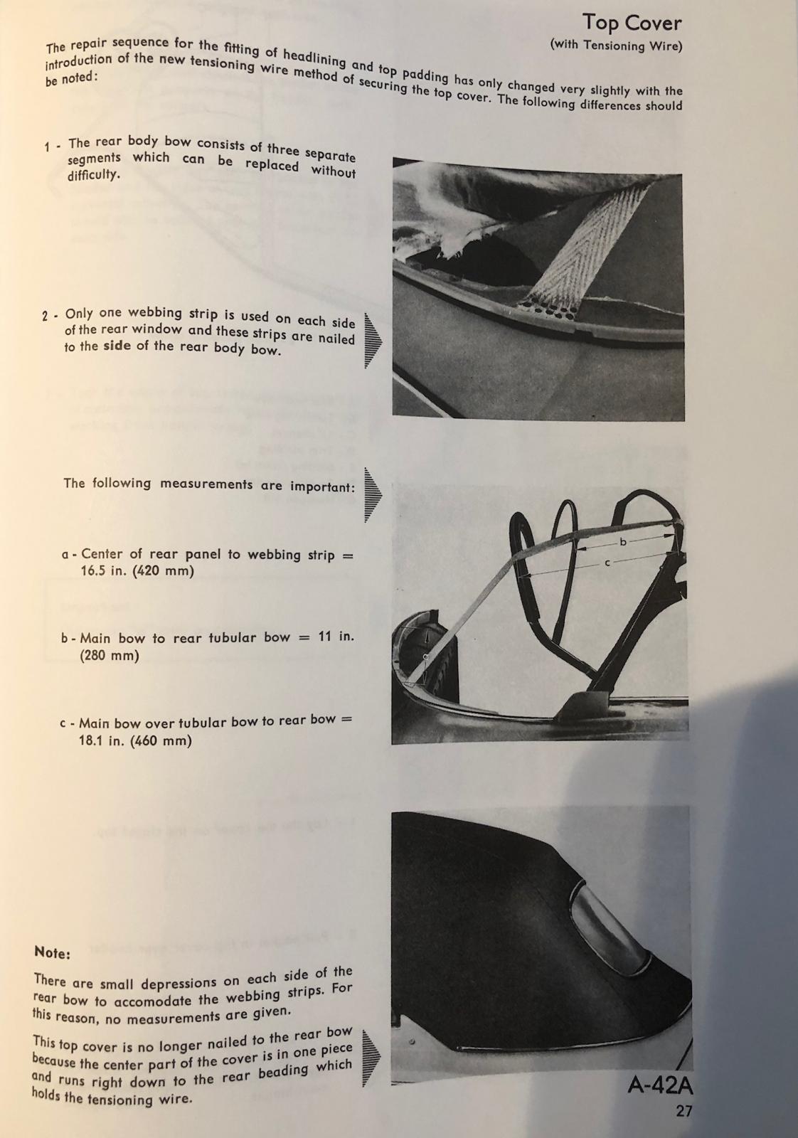

Here are a few excerpts regarding rear trim change around 1967
VOLKSWAGNUT wrote: |
Herrbern wrote: |
@Volkswagnut : are you sure this is not the nailed version that was discontinued ? Because my car has the U channel and the chrome molding that is an other version than the nailed one. And the car always had that. What I am sure of is that none of 68 verts have that molding. |
Am I 100 % sure.. no.. I wasnt even alive in 67..
Yes.. sorry I meant the nailed heavy chrome.
I think the trim was changed to an aluminum anodized version after the U lip was introduced ???
How are the 67 early 68 non nailed strip attached?
Seems like vaguely in my mind on one 67 I owned.. it has screws at the ends ??
In my research I have found information that indicates a change in part number for the molding at the U lip introduction VIN.
Molding rear support.
#151 871 431 to VIN 157 250 032
#151 871 431A from VIN 157 250 033 to VIN 158 469 660
It also indicated it lasted into 1968 production .

Well, this is what I found this evening in my documentation. Sorry for the quality of the pictures, as I had not enough time to properly scan the pages of my official VW book. But as seen on the pictures, the chrome strip for U channel verts exists and you even can see how it is fixed to the car. Like mentioned before, I have never seen a 68 with this molding and I suspect VW only equipped a few of 67 verts with this chrome strip for U channels. Like mine, on the pictures of the L41 vert you see that the strip is very narrow compared to the older chrome strips that were nailed in wood.

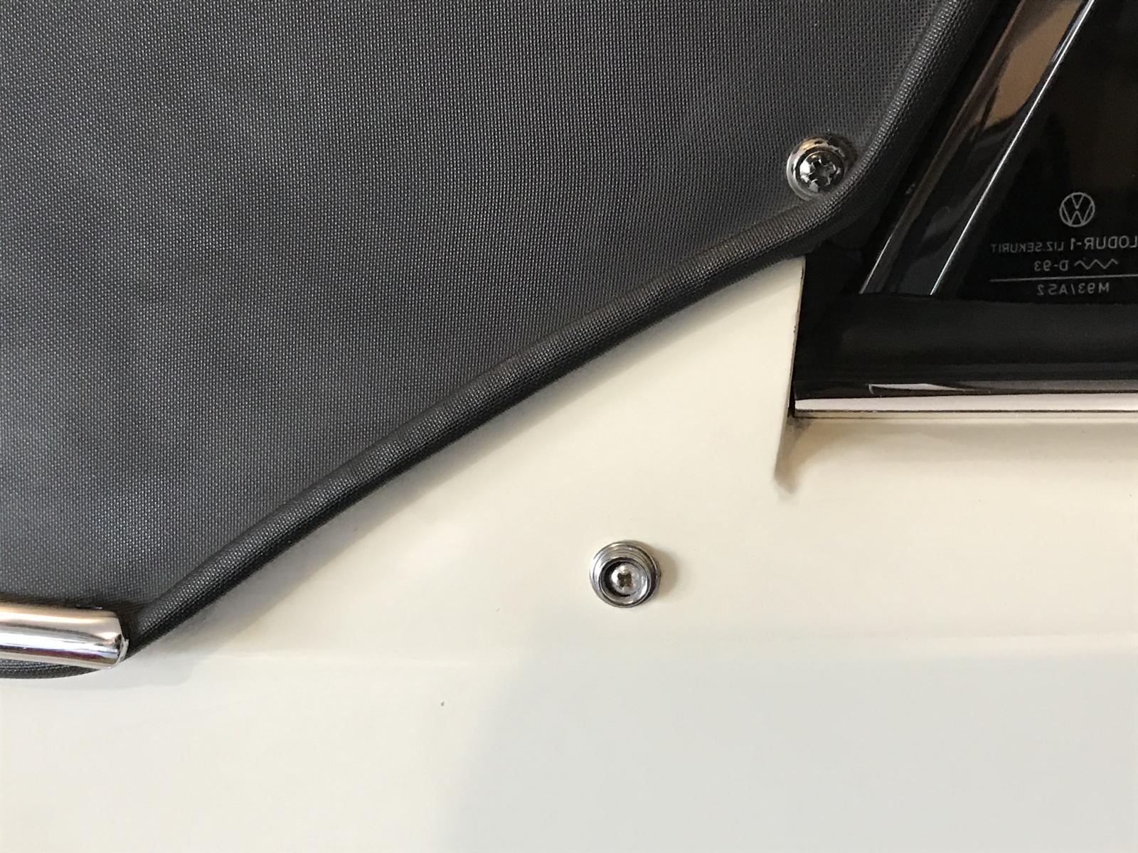

Here is a picture of the snap position on my Aug 66, 1967 convertible. Hardware and top are factory original.

Prime example ^ of the early 1967 pre U channel.. hard chrome nail on trim.. no screws at the end..
Thanks aircooled.

The car was the the end of August 1966 according to the Factory Birth Certificate. The top also doesn’t have tension cable, but is stapled on. 🙂 _________________ 67 Sun Roof / Born Sept 66 / Second Owner

Harry, judging by the original picture you posted in this thread it looks almost as if there isn't enough actual top material to pull down, and towards the front to properly cover the baseline profile and the screw/nail hole in the body. How does the other side look in comparison? Is there excessive material over on the right side? Something just doesn't look right there. I attached a couple pics of my very early production 67 convertible (Aug. '66) showing the two chrome tack strips, including the one above the window which was dropped "mid year" along with the change over to the "U" channel / cable attachment arrangement. My top is not a factory original top as is Aircooled's, I installed it myself back in the late 90's. However, it retains the original chrome strips which did NOT have holes on the ends of the base perimeter tack strips - as yours shows. Mine are exactly as the close up of Aircooled's shows - no screw hole. However, the trim strip above the window has factory screw holes on either end to aid fitment.
I'm sorry I don't have a really close up picture of that area on hand at the moment, as my top is currently down with the boot in place. I'm hoping these pics of my car with top up might be of some reference for you since I think you have an early production model year '67 too?
