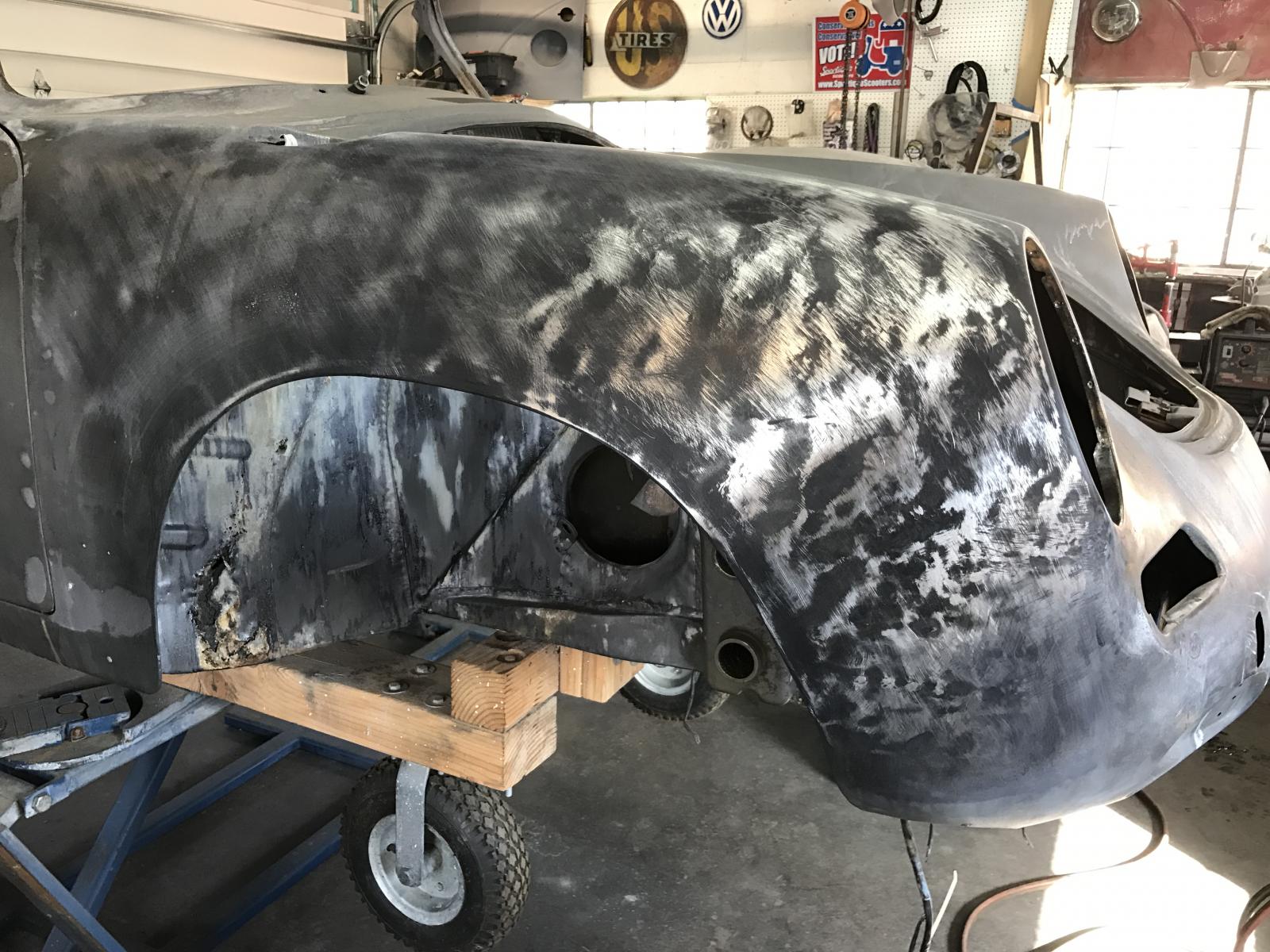

PostPosted: Sat Dec 12, 2020 7:49 pm    Post subject: Re: High spots Reply with quote
I finally got some pics. I mellowed out on the sanding and worked on smaller sections. I did have a couple high spots but not as bad as i firdt thought. I'll get her primed tomorrow and see what happens...steve

PostPosted: Sat Dec 12, 2020 9:34 pm    Post subject: Re: High spots Reply with quote
You can do more bodywork with hammers and dollies to bring some if the high spots down a little. But that may not be needed.
One thing is that many people have a habit of sanding down the filler to quickly or aggressively. If you sand too much off you end up having this problem.
To be safe you could reapply a skim coat and carefully sand it down with a flexible long block. Put sandpaper on hood curve, and bend block against the area as you apply sandpaper to the block and the sticky/velcro will help it keep shape. Something like a durablock or similar.
Technique is everything here. You don't want to sand too much of the the filler off. Also apply it all the way past the edges. You need to be able to "feather" it in.
Overall it looks like you have the right idea.
You dont want filler to ever me more than about 3/16" thick once sanded down. Ideally 1/8 " ... that may give you an idea of how close the metal work is. If its thicker that that then you need to do more work on the metal.
