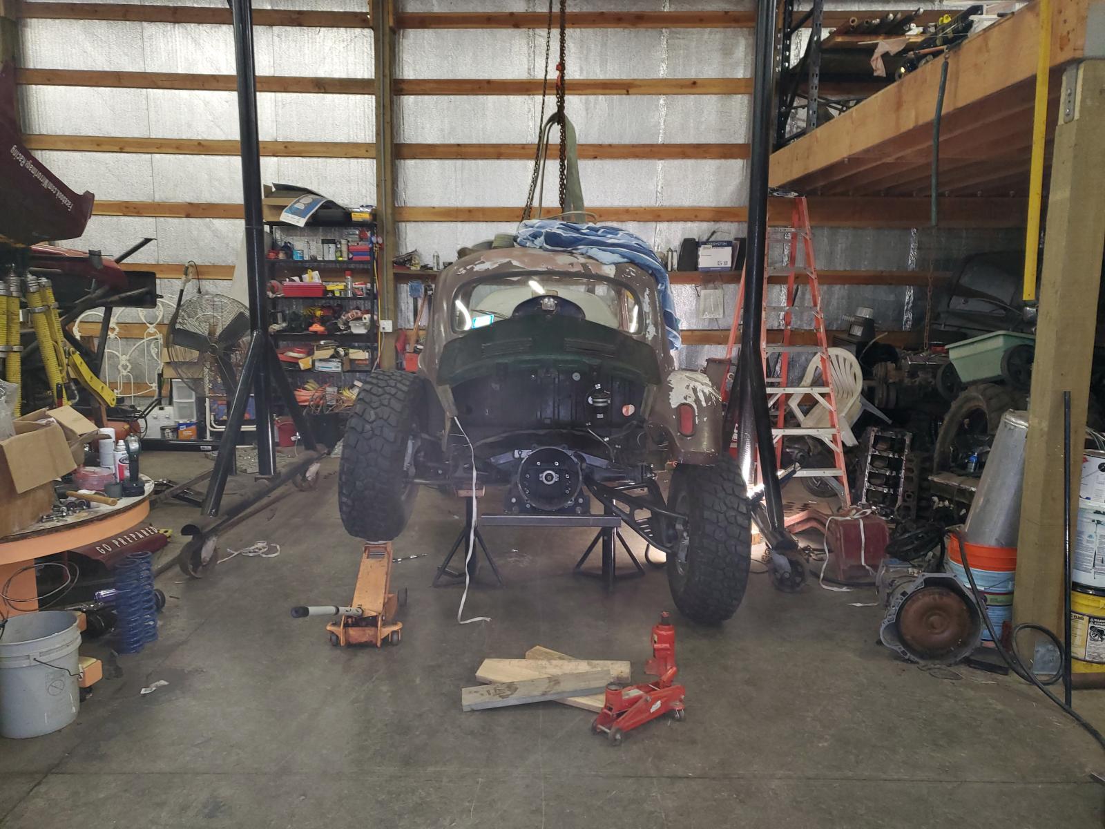

I assembled without torsion bars and cycled. Over 12"travel with type 2 cv's. Kind of hard to answer your question with the little info given. Axle length, spline lenght, shortest and longest measurements between cv's.
