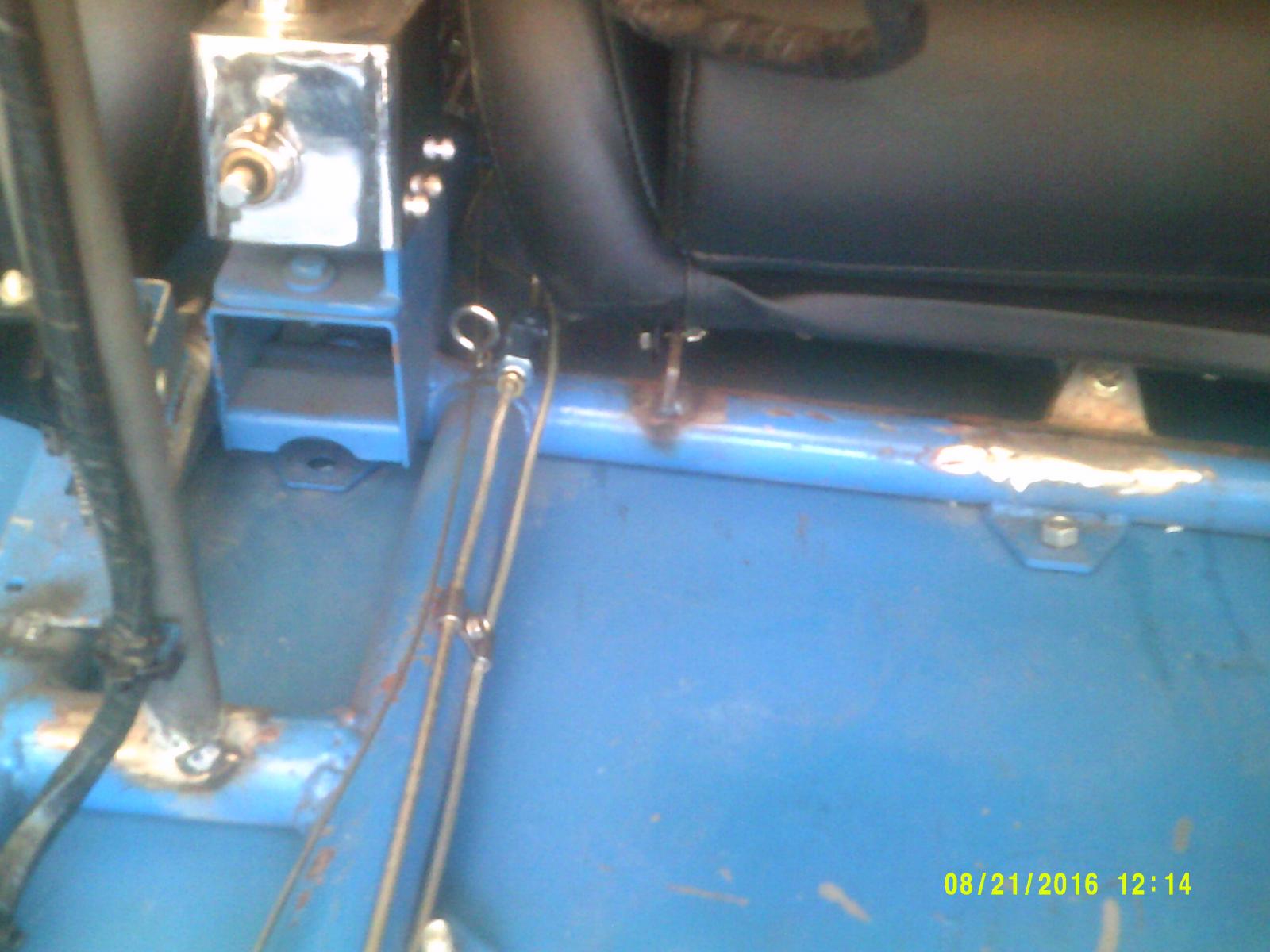

First pic shows the tabs for the front of the seat mounts and a double shear tab for the crotch belt whoch points straight to the hole in the seat for that belt.
Second pic shows the bar ( tube) and tabs for the rear seat mounts.

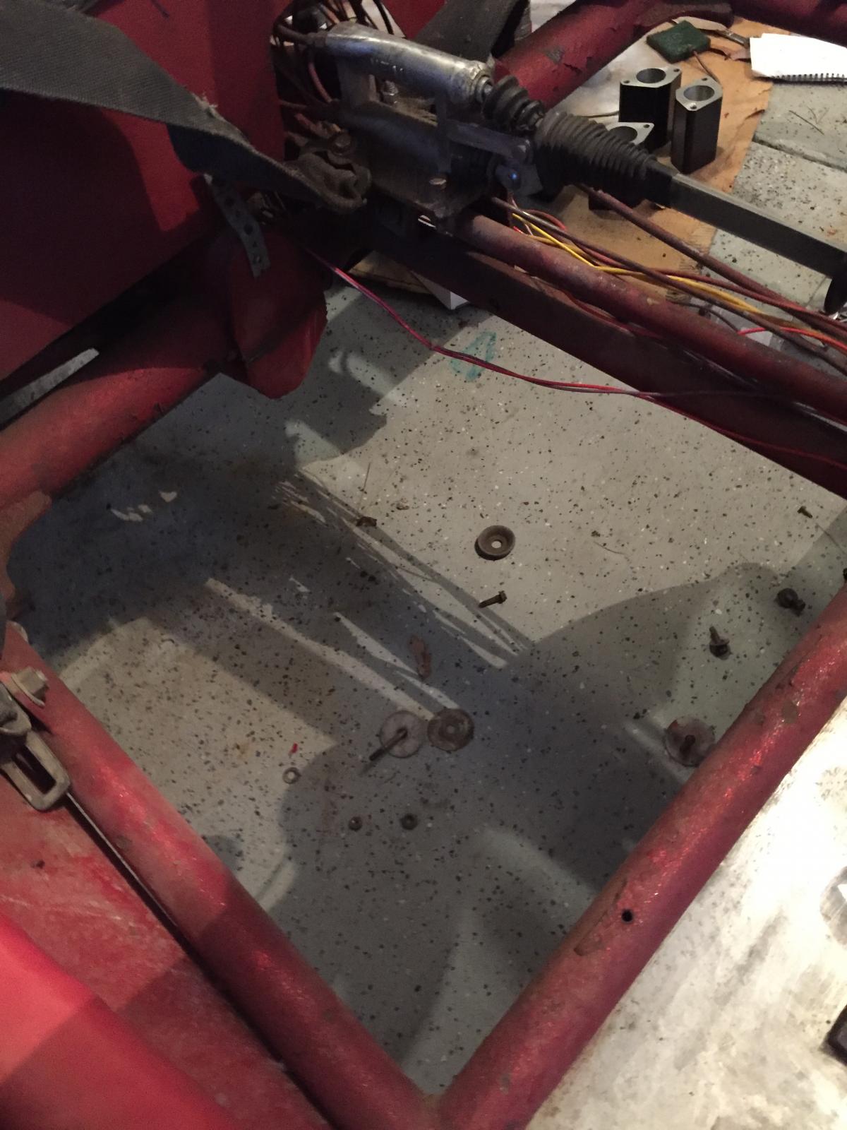

Thanks for the pictures and someone said post some pics.
I would like secure these brackets some how...the mrs want be able to drive so was going to put a slider in...thinking about the floor and gage that was mention and maybe some cross members supports all the way across.
Don’t have really any good idea to tie floor to back near Torsion bar going across

PostPosted: Tue Dec 08, 2020 2:35 pm    Post subject: Re: Front seats Reply with quote
Also think you can see from picture belts or already tied in frame good
