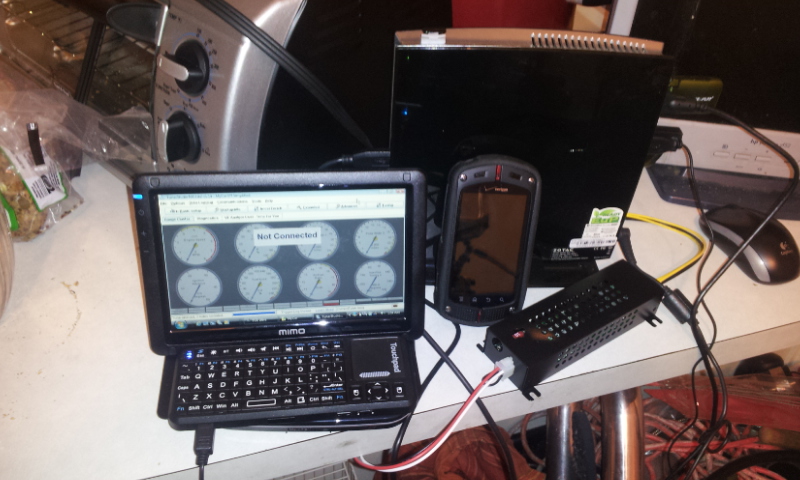

another way of doing it is to get a 80 dollar tablet from walmart that runs windows, and a mini keyboard and dc to dc converter. $110 total.
