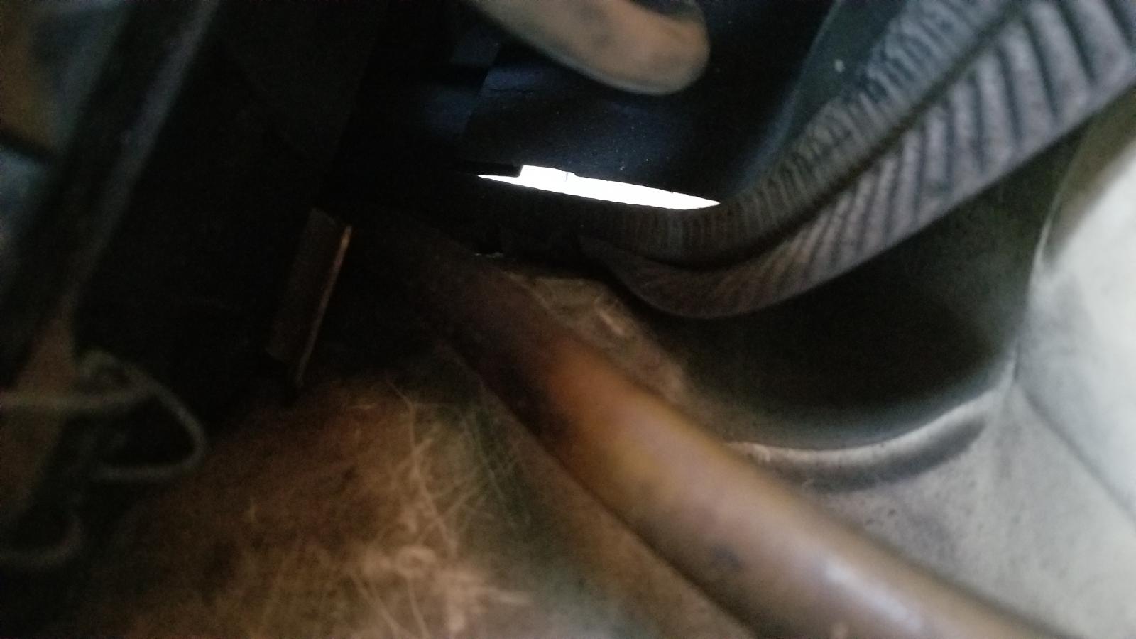

I've been reading a lot about maintaining an early air cooled engine.
Specifically, about over heating and the importance of the engine tin to keep hot air from the exhaust mixing back in the bay.
I'm pretty sure my tin and seal are not supposed to look like this
I clearly need to replace the seal.
What I'm not sure about, am I missing a piece of the tin?
I've read the comment that you shouldn't be able to see the ground from the engine bay. And I can clearly see through in a few spots on the rear drivers side.
Is that normal?
Should it be totally sealed, or just "mostly kinda with most of it covered" sealed?
I'm sure along with the seals I've probably got other air flow problems to take care of. But, this one jumped out at me as soon as I knew to look.

Find something flexible to seal the gap in the front. You don't want whatever you use coming out and getting sucked into the fan though.
Sealing around the AC compressor is a pain, which is why it is often not done. The smaller the gaps the better and keep in mind here as well that you don't want anything coming loose and getting into the fan.

The rest of the AC may be long gone. If that is the case then removing the compressor will make sealing the engine compartment easier.
Note that the AC was a stand alone system and not connected into the rest of the heating and ventilation system.

The original dealer install directions had you modify the factory tin section and to account for a poor fit, had a foam gasket to fill the gap around the compressor to reseal it. The quality was left to the tech installing the a/c.
A better solution is if you want AC on an air cooled engine would be to convert to a rotary piston compressor like the Sanden 508 or 709. I've seen compressor brackets for adapting these to that engine.
Also, the AC belt was a pain in the butt to access. There was a crank pulley that got sandwiched between the intake blower and the crankshaft. The belt ran behind the fan shroud. Never easy to change.
