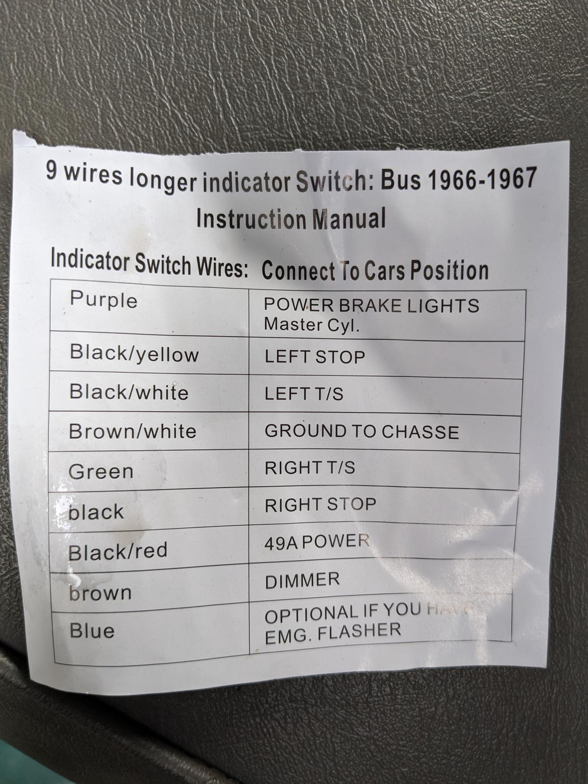

5) Identify all the wires coming off of your OLD (still in place) Turn Signal Lever's wiring harness.
My hope is that this next picture will be one of the most useful things in the tutorial for you.
Use it to identify the ends of your old turn signal wiring.
Don't worry about the wires I say are "unused", unless they ARE connected to something in your bus, in which case, LABEL them as to WHAT they are, and WHERE they connect to.

9) Find a large flat clean surface and stretch out your new turn lever's wires alongside your old one.
This can be important because this is the chance to see if there are any differences.
Since you took the time to label the wires of the old one before taking it out, you can now easily label the new one.
I have had reproduction turn signals levers that did not use all of the correct same color wires as came with the bus originally.
This new one (Jan. 2021) did, however.
This is why you need/want to compare the two to each other.
10) Label the wires of your new Turn Signal.
Have a print out of that picture I provided identifying the wires of the new turn signal.
Also, compare it to the old one carefully. If changes were made (on the old one) it's worth noting.
Even if you're not going to leave the labels on (after you're 100% done), labeling the NEW one makes it SO MUCH quicker to set it up once you've threaded it in.
IMPORTANT: If you're doing the same model bus as myself, and the two wires that I marked as "unused" are ALSO not used on your bus, then cover up the ends of them with electrical tape in a way that you could use them if you figure out what they are for, but that also they don't accidentally short anything else out.

12) Connect all of your labeled wires to their correct locations.
Getting lost? Maybe print out the picture I provided of what all the wires are, and/or consult your bus' wiring diagram.
Again; having labeled these before putting them in, even if only temporarily, will make this MUCH easier.

I found these instructions by DadaCheese very encouraging so I decided to put in my new turn signal lever. I am waiting for the salt to be washed off the roads by spring rains. I knew I would not be driving for several days. My old turn signal did not consistently activate the high beams and would not stay cocked - you had to hold it in place most times while using it, which can be awkward. I had ordered a replacement last year in anticipation.
Disassembly went OK. I dropped the parcel shelf to provide more room to play. My bus has had numerous wiring adaptations; I wasn't sure what I was getting into. I usually screw up something the first time I do it. Here's what it looked like at its worst.
There were a couple of problems with the new unit. The key to the wires was vague and open to misinterpretation. The listed wire colors did not totally match the wires from the new lever.
When I tried to screw the lever into the new cover, the machine screws supplied had too small a head and went right through the hole. I used my old cover instead. The headlight dimming was no more consistent than with the original lever. That might be the fault of the relay not the lever assembly. I never was able to make everything work as the wires apparently were going to the wrong terminals. In frustration, I removed it all again and re-installed the original lever. Thanks to DadaCheese I had diligently labelled my original wires and they all went back in the right place. Headlight dimmers work; signals work. I am only missing the turn signal indicator light on the speedometer. Installation is far faster the second or third time you do it.
If I was going to add to his advice, I would suggest that, when you insert the wires through the dash in Step 11, they go up and over the metal on the bottom of the speedometer housing, not underneath. That mistake provoked installation #2.

Hello all,
I have the joy of trying to fix a 67 non-USA
bus wiring. I bought a new WW turn signal, but as others have noted, the instructions don't match the wires supplied.
I was wondering if anyone had used one of these new turn signal switches with a 3 prong turn signal relay and an orignal 4 prong dimmer relay?
Thanks,
Chris
