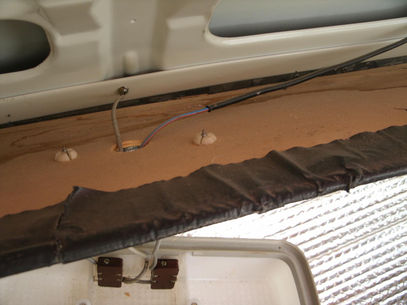

I'm trying to make the rear dome light (is that actually what it's called?) work with the new wiring dome light harness that I have. I have a new blue w/ red wire that runs to it, as well as a short ground wire that I am assuming grounds near where the light is.
This is the light that I have now. Can anyone tell me if it is the correct / original set up?
Thank you!

Let’s see the new harness.......

Here are the only two wires from the kit I have that are for this light. The dome light harness is already in place, with all the other wires connected, and the blue w/ red is the only one that runs to this light. The other other wire in this picture (which is currently taped to the blue w/ red so I don't loose it lol) is a short brown ground wire.
I didn't get any of the other wires in the previous pictures with my new harness and so am assuming that they came with the light. I don't have a replacement light so I don't have new wires for it :/
I don't mind getting a replacement, but if this is the original I'd like to see if I can make it work first
Spencer

Hello,
Your light fixture is wired correctly(green wire/jumper wire is replaced). Just go down too the hardware store and get some grey wire, if you want to refresh that fixture. One switch is for the two outer bulbs(hence: jumper), the other for center bulb.
But, the new harness will work. These pictures are the way it came form factory.
I hope this helps you out.

Thank you so much! That was exactly what I was looking for Very Happy

The bulbs you have in there look wrong......should have metal "titty" ends on them like the lastest pic

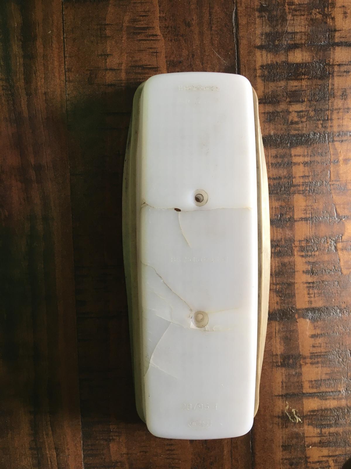

That whole light is a mess, broken switches, cracked lens, tweaked frame, I'd say it would be less work to find a better example, or a modern replacement.

I think the bulbs are p/n 6411

Sure, the lens is cracked(find one better in the classifieds, I did. thanks wes) and along with switches(mine were fine). And, straighten/flex the metal fixture over the edge of the work bench, easy enough. Even though the screws will hold it flat....
