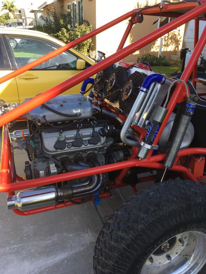

77charger
Joined: November 12, 2005
Posts: 1492
77charger is offline
PostPosted: Tue Mar 09, 2021 10:26 pm    Post subject: Re: Swap to water-cooled? Reply with quote
Did a honda 3.5 in mine.It fit my car great and was not too bad for cost got the engine,ecu,adapter plate for 1500,friend gave me clutch and PP bought some headers for 450 custom made,250 for fuel system,350 for complete cooling system cherokee alm radiator,probably another 350 in misc parts.
I did my own labor so that saved alot sold my old well built 2275 for 2500 at the time which was a steal.But love the honda as far as power goes instant and fast.
Ecotecs are also a good choice too
Click to view image

77charger
Posts: 1492
PostPosted: Wed Mar 10, 2021 11:14 pm    Post subject: Re: Swap to water-cooled? Reply with quote
Scott SD wrote:
Ecotecs have a huge following in the desert. Cheap, dependable, and fairly light. While I am not a GM guy, it does look like a good package.
I was going to go the ecotec route too but was going to be within 1/4 inche clearance if all went perfect with my measurements.Then o was going to have to get full asking price for my 2275 i was selling at the time which was going to be hard to do then.
But like said came across honda 3.5 deal for half price of ecotec route but both these engines are easy to get although i think the hondas are a lil more common and cheaper.Friend had issues with his found a complete replacement for 400 bucks.
Heres what the 3.5 looks like in it and old pic of vw

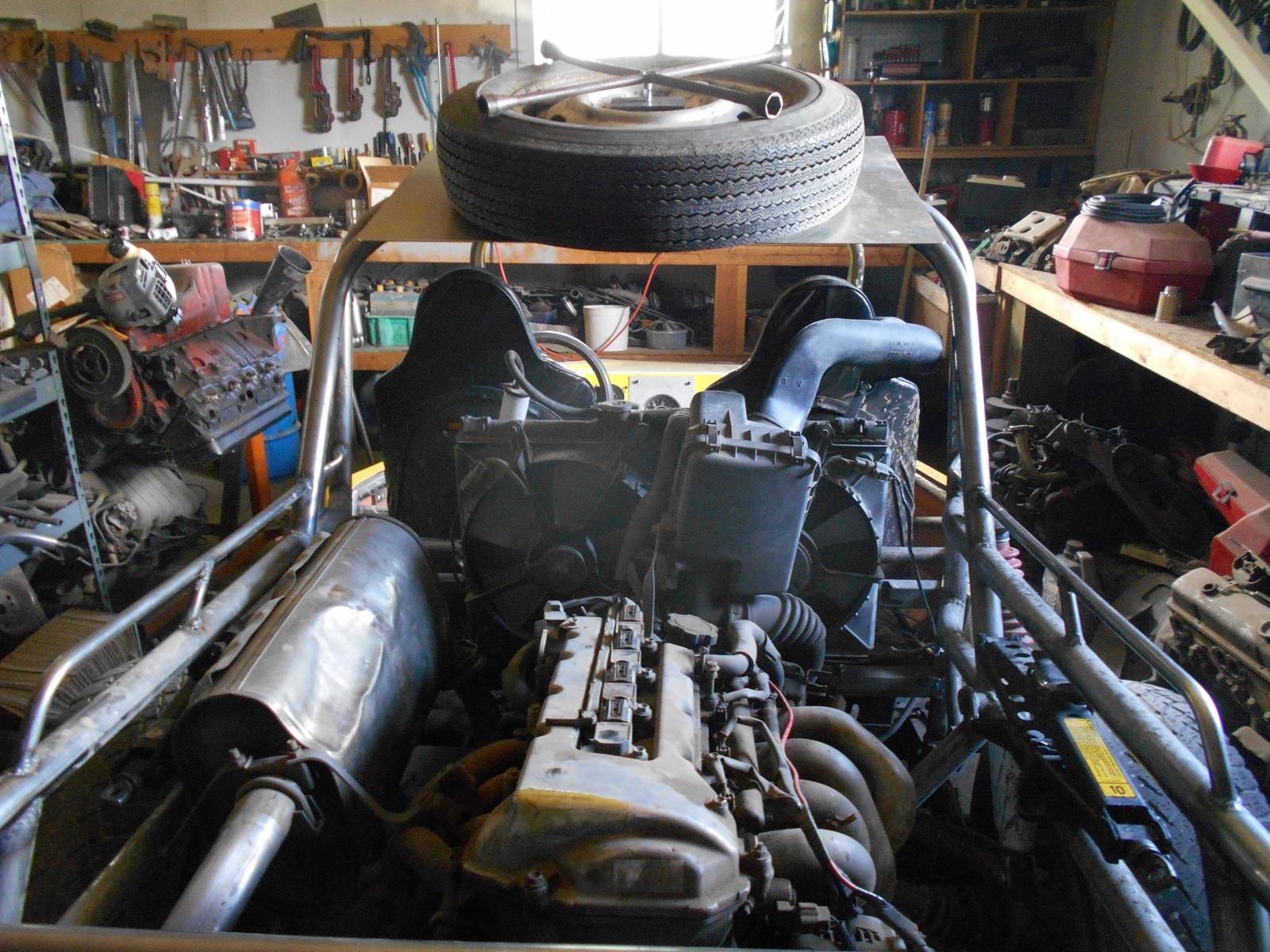

danielzink
Joined: August 03, 2004
Posts: 288
Location: Lansing Michigan
danielzink is offline
PostPosted: Thu Mar 11, 2021 12:47 pm    Post subject: Re: Swap to water-cooled? Reply with quote
I went Subaru so I could keep the "horizontally opposed" esthetic....
Granted I did 85% of my own work so I don't have much to add to the OP's question...
$600 for a rusted out 90,000 mile Legacy....$600 for the cut down harness..then various and sundry piping...sumped gas tank...eBay radiator etc...
I'd say I've got under 2k into it.
Just wanted to show another option.
