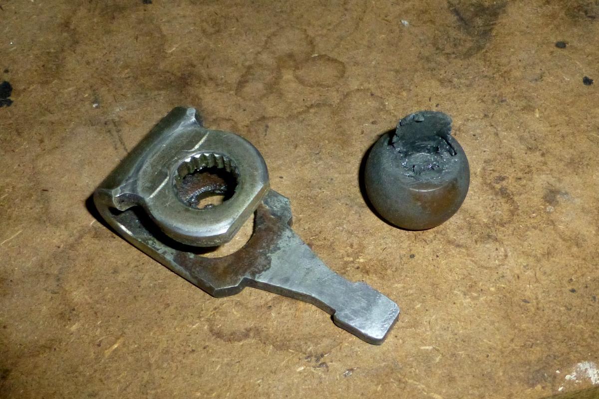

Failure of the ball & cup fitting that operates the arm on the 2WD trans caused problems with 1 & 2 on mine. Don't know if Syncros are similar in this regard.
