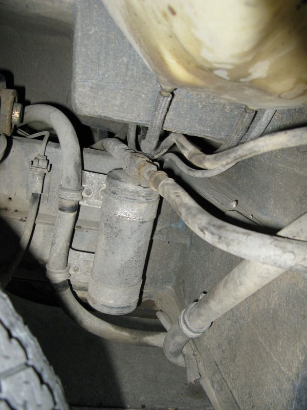

The plumbing hoses come in low behind the drivers seat close to the wall and run up to the evaporator. Look in the rear of the drivers side wheel well and you will see where they enter. Should be easy to cover up the holes. Up top there will be two holes where the housing was bolted and possible some staining on the headliner from the metal plate but not bad.

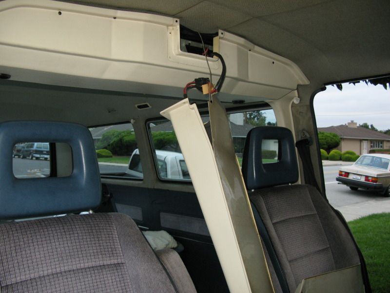

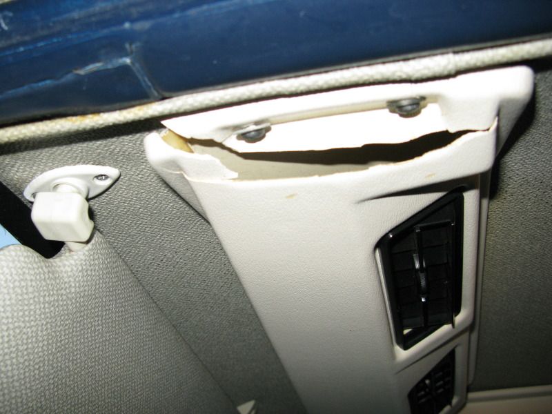

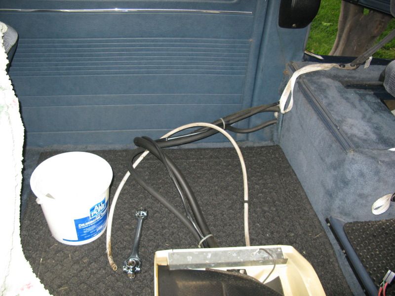

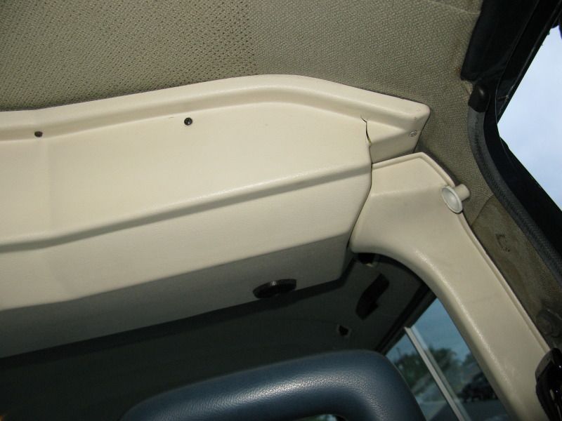

This is what I experienced.
I removed the A.C. ceiling unit from my 1985 GL tin top about two months ago. It took about four hours and some simple hand tools. I cut the hoses to pull them out. Everything removed weighted nearly 80 pounds. There are four holes to fill, two near the roof behind the front doors, for some drain tubes. And two low down behind the drives seat for A.C. hoses. There is some discoloration behind the unit, but no cuts in the fabric.
The only thing I haven’t removed is the engine support for the compressor. It looks like I would have to remove the distributor to get to one of the studs holding it down. My Vanagon is running so nice there days; I don’t want to disturb the timing.

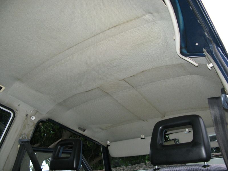

PostPosted: Tue Oct 30, 2012 2:25 am    Post subject: Reply with quote
Here are some photos.

PostPosted: Tue Oct 30, 2012 6:26 am    Post subject: Reply with quote
Awesome! Thanks a lot! I have a little carpet cleaner that I might try to erase those lines with. It's commin' out when I get back from camp!

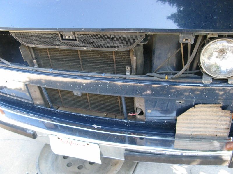

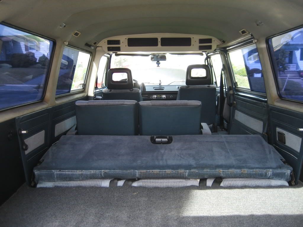

GT,
I removed mine this weekend. It was pretty straight forward. If you plan to remove the hoses, compressor, condensor, canister, you have to take the radiator loose to get the condensor out form the bottom. My headliner did not look too bad. there are a few extra holes visible now and I need to address the 3 holes in the drivers front wheel well to block. I'm simply going to put a metal plate over them for now as I am going to add a kitchen unit in the future an may choose to utilize them for electrical or plumbing etc.
I'll get some before and after photos up shortly
Jeff

PostPosted: Mon Nov 12, 2012 3:29 pm    Post subject: Reply with quote
before
after

PostPosted: Tue Nov 13, 2012 7:30 am    Post subject: Reply with quote
for me it was cost (not wanting to throw money at retro fitting and recharging it with the risk of it still leaking out and not functioning), aestetics (cleanliness and headroom, hated bumping into it going through the middle of the seats to get to the rear), opening up more room to work in the engine bay, and just all around dumbing down the van to the basics for reliability and less things to fail.
As far as the bracket, I have not removed it. The compressor comes off with 2 allen head bolts and the two tensioning bolts.
The engine bracket appears to be secured with 3 bolts, two appear to be fairly accessable while one is under some hoses. I'm planning to pull the engine and rebuild in January. So I will probably just leave that bracket attached until then.
