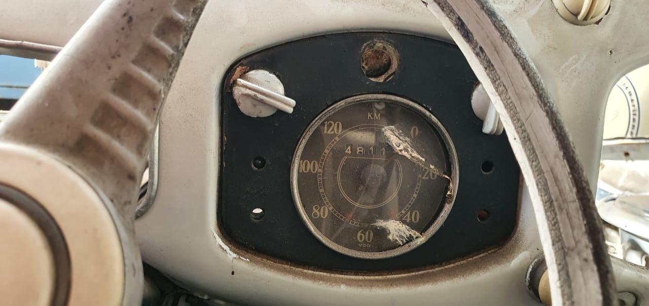

Hi guys, I need your help. Can someone give me the correct diameter of the ignition lock or the hole for it in the speedo pod? Some previous owner drilled the pod to install an aftermarket unit.
Also, has anyone restored it? I don't even know where to start.
Btw, I didn't find any thread with this info.
Thanks!

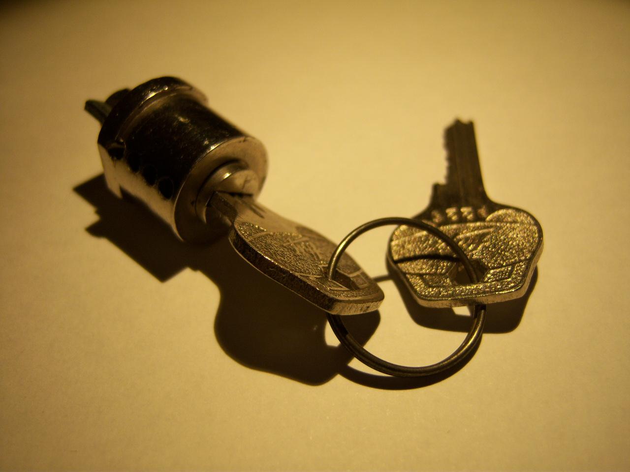

From a NOS ignition barrel and keys I have, purchased from a VW dealer many years ago, the barrel measures 15.85mm diameter, and the opening in the pod 16.25mm.
Hope this helps.

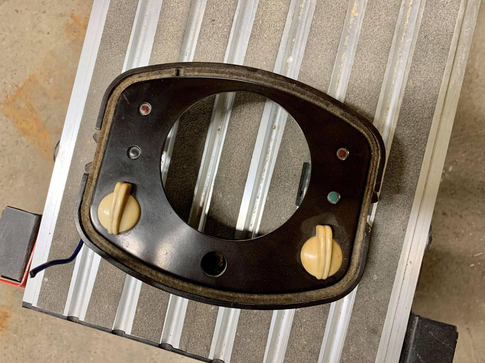

A new question arises. My car is a 52' deluxe. Can I use any pod (barndoor, standart splitbug or does it need to be a deluxe aswell)? I was thinking on getting any of those and paint it ivory.
I heard that the speedo hole is a different size. The one offered to me is 10 cm. Unfortunately my car is 80 kilometers away and my city is in quarantine. Can't measure mine at the moment.
This photos were sent to me by the seller. What do you think?
Thanks!!

100mm is a deluxe pod. Will work well for your car, looks like a nice, complete pod.
Standard pods are 95mm speedometer opening.

Thanks John! So, that pod should have been ivory in the past?

Yes, that is correct.

Look closer and you will see remnants of the original ivory paint inside the ign lock hole and around the perimeter of the speedo hole.
It would also provide a good means to color match some new paint!
That is a nice pod for sure !
