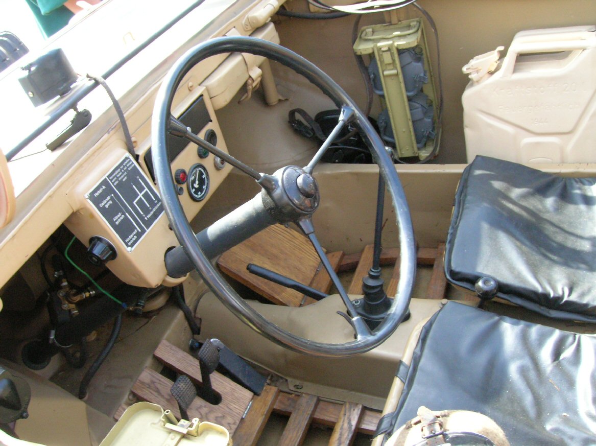

… here's pictures of schwim steering wheels, from thesamba gallery - i'd say, "YES, your memory is not what it was" - z

Yes, that first picture, I posted was my last discovery - found the other 3 first and then, that first one - now, I also know something about very early steering wheel ID - z

Does not look like a KdF/Kübelwagen/Schwimmwagen steering wheel.
This style was very common back in prewar and immediate post war Germany, built by Petri. KdF wheel is 40 cm, first thing to check. Also if it fits a pre 1959 steering shaft. Thirdly, the center part where the horn button fits is not at all this deep in an original KdF wheel (compare to first photo of an unrestored Schwimmer with an original wheel), there is also no notch/intendation in the center part where it fits the steering shaft tube.
There were about 60 000 plus original KdF wheels (this style) made from 1943 to 1947 so one might think it is not that rare. The rubber rim however was not very durable so not many survived and were swapped for newer incorrect Standard Beetle wheels like the restored Schwimmwagen pictured above (please note the hard plastic rim with no grooves).
I have seen original KdF wheels sell for 800-2500 Euros, similar period Opel, tractor etc wheels are not desirable and sell for very little money.

Again, a samba gallery picture - with a KDF steering wheel - has the groove - I know, it's not a schwim, but is of that era - Since no one can produce an original picture of a schwimwagen steering wheel, i'm gunna' assume the grooved-one is correct

Another Schwimm with grooved steering wheel - z

Schwimmers don't have doors!
oldtimervw
Joined: May 31, 2015
Posts: 38
Location: Germany
oldtimervw is offline
PostPosted: Sat Jan 23, 2021 4:33 pm    Post subject: Re: Need help identifying steering wheel Reply with quote
That's a VW82 Kübelwagen interior.

here's a period photo of a schwimmer with grooves just visible. I've noticed that some wartime vws had flat spoked steering wheels as in the second photo...
