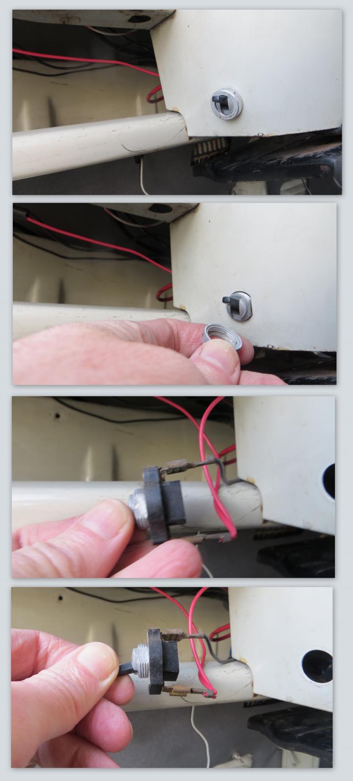

--Test/replace/look at connections to the front cab DOME LIGHT SWITCH (WW Part # 211947511C).

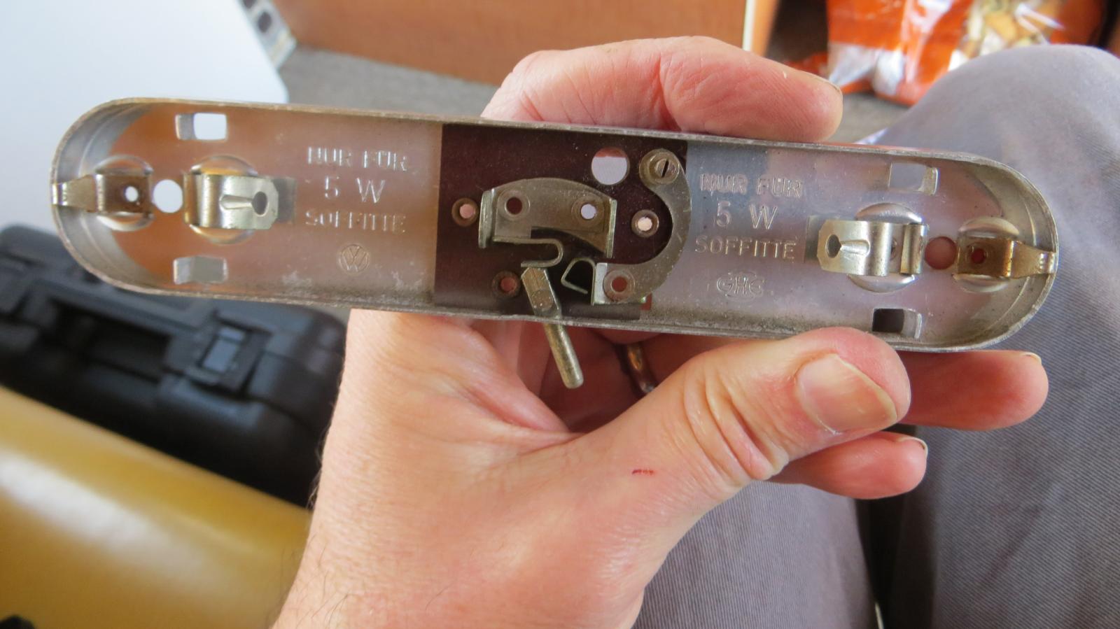

--Test/replace the dome light fixture (WW repro. Part #211947107A)

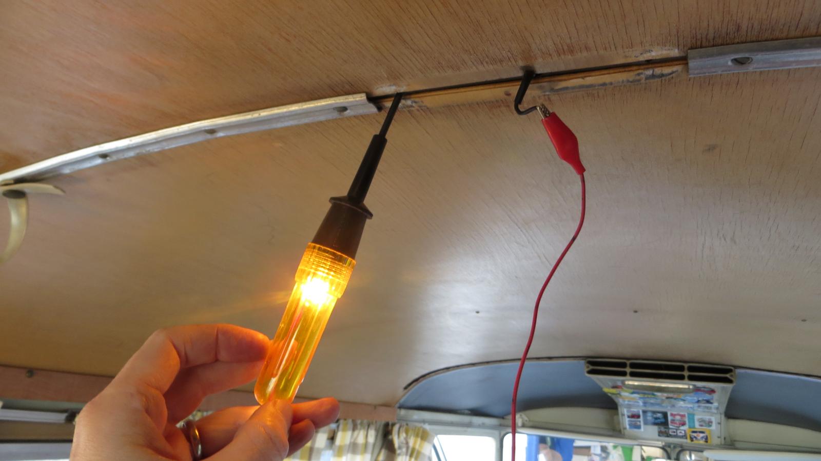

Put your meter on 12vdc and ground the negative probe. Use the plus probe to touch the toggle on the speedo pod both wires. If both wires show 12v then probe the wire at the dome fixture. If both wires don't work put a jumper to connect the two wires and continue on to the dome wire. If dome wire is 12v then clean up the dome fixture. Like others say make the ground good at the mounting screws. Like others say make the dome light on-off switch contacts clean and touching good.

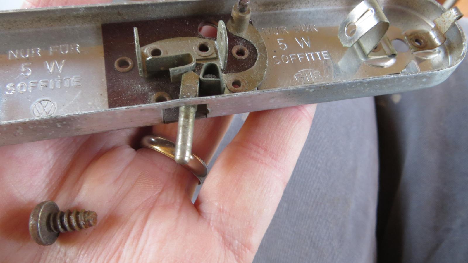

Was indeed as easy as cleaning things up and using some dielectric grease on the dome light grounding screws.
Got out both my volt meter and simple test light too; voltage was correct all the way through after cleaning connections on the front cab switch, and the dome light.
SO pleased that there was nothing wrong with the front to back wire. Front cab switch was fine too.
Look at how rusty the grounding screws get after 54 years!
