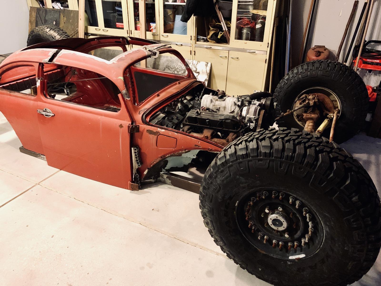

Guess we will start here with documenting a build that I’ve had going on for a few years now. The short of it all is a 1969 standard beetle, chopped, sectioned, slammed, front engine V8, airbags, cantilever front and rear suspension, and a completion date that is constantly being kicked down the road. So far, we have a half completed body, a half completed frame, an engine, tires, axles, transmission, transfer case, and a whole lot of welding. Enjoy!

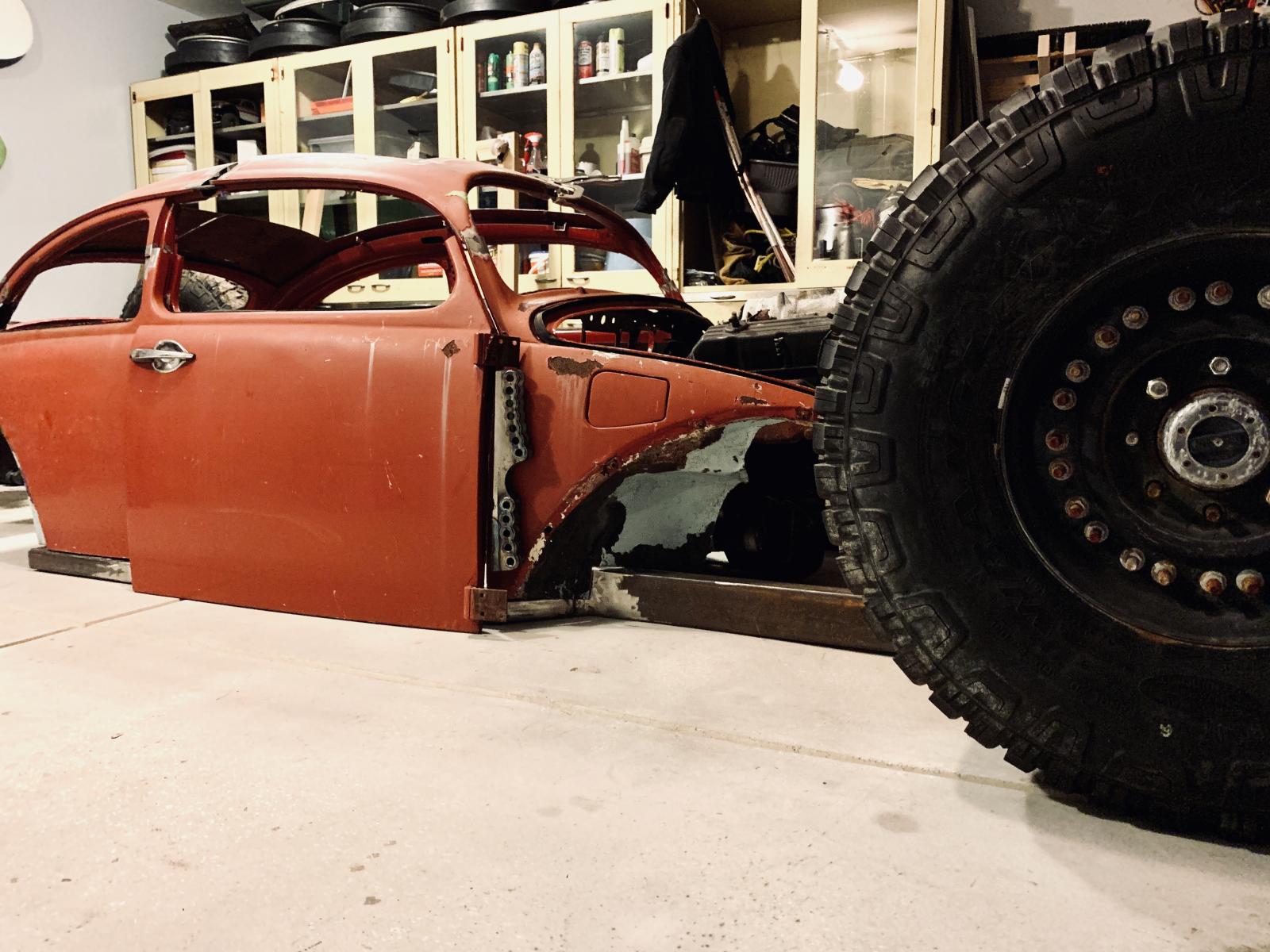

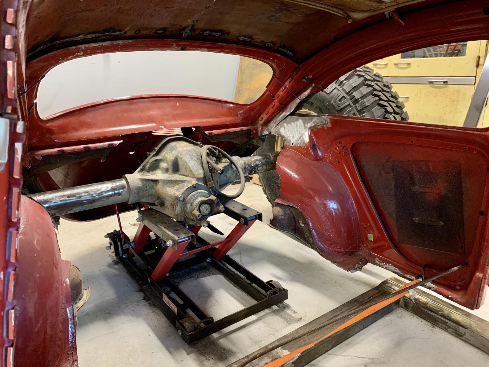

Not much progress today but I got the rear axle spring pads and shock mounts cut off, the rear axle body channels roughed out, and the body lowered a bit. It still needs to come down about 3 more inches but I still need to clearance for the differential. It’s slowly coming along.
Still need to clearance here
Sitting pretty close to where it’ll be
She’s tight but it’ll fit no issues with the bags completely deflated

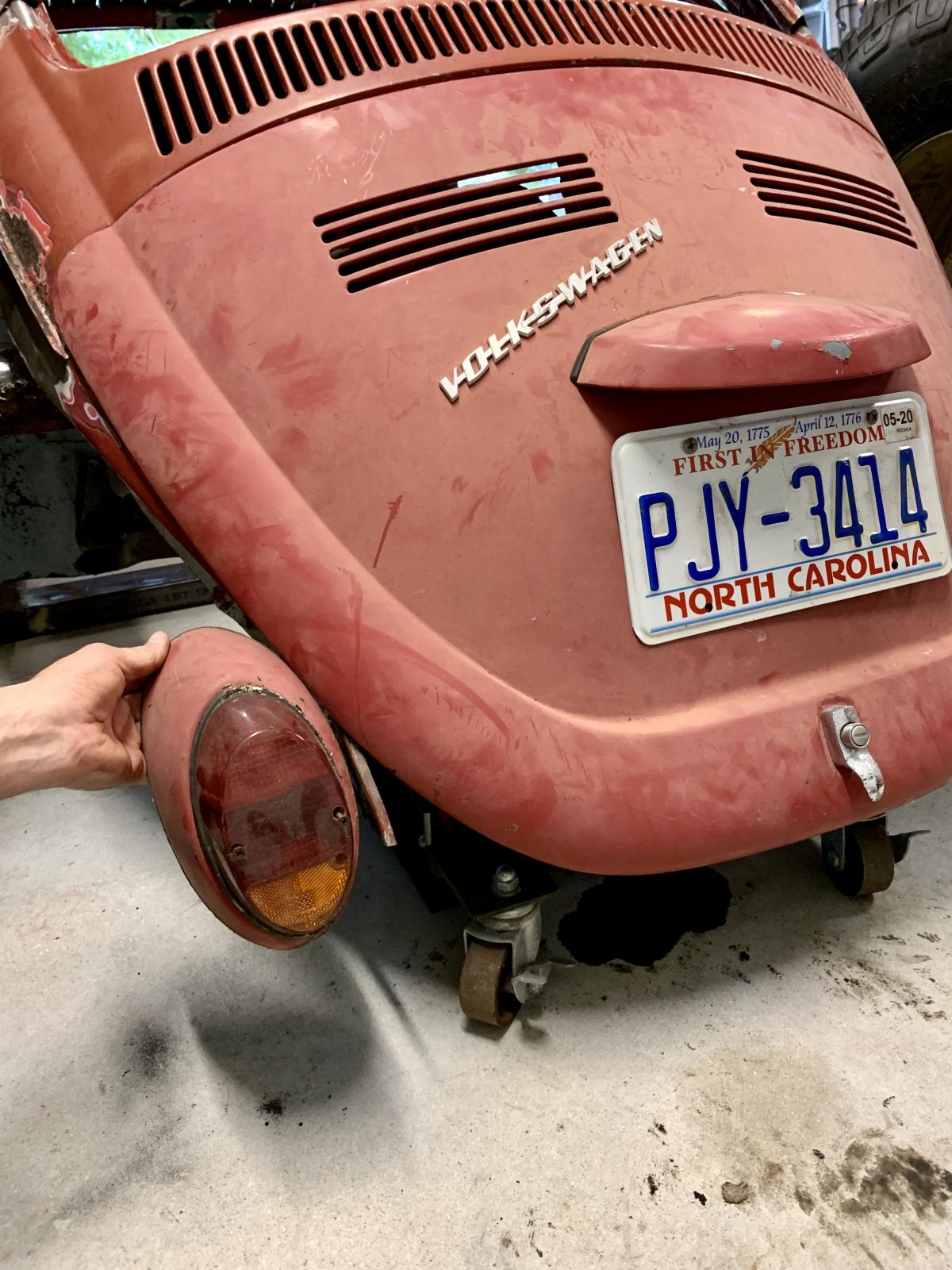

I’m thinking I’ll reuse the stock brake lights...thoughts?
Plenty of room for a rear radiator and fan

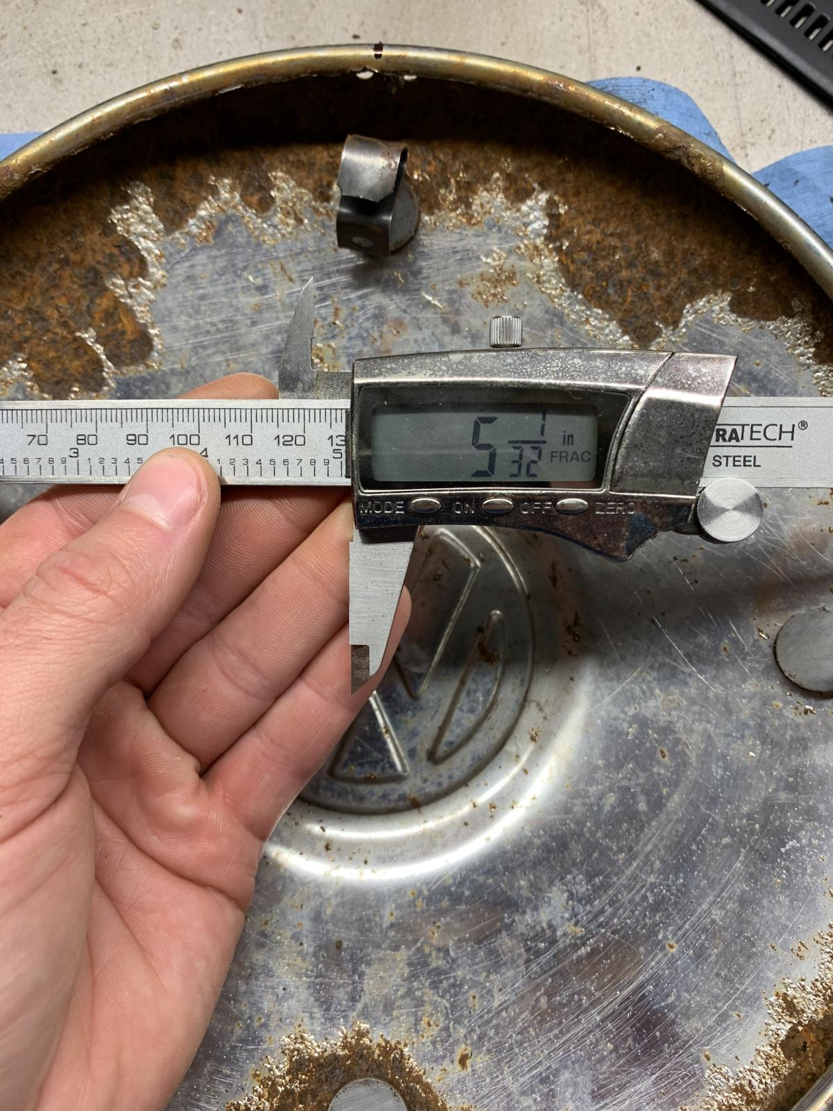

Worked on a bit of the hubcap idea today. Not much progress made and more thoughts than answers but I have flat style hubcaps from a 1972 beetle. I want to figure out a way to use early model (1965 beetle to be exact) hubcap clips to hold them onto an H1 rim. They clear my wheel studs without issue, I just need to locate spots to drill and rivet the clips onto. I went to Lowe’s and got some plexiglass and held the clips to the hubcaps with magnets. They look like they will fit without issues if I can find a way to get the clips onto the H1 rims. I made a template for the 8x6.5” bolt pattern, the radius of the hubcap and the radius of the hubcap clips. And that’s where I’m at. Thoughts? I figure I might be able to make a bracket to fit or a circle out of sheet metal that bolts on and holds the hubcap in place. More to come.

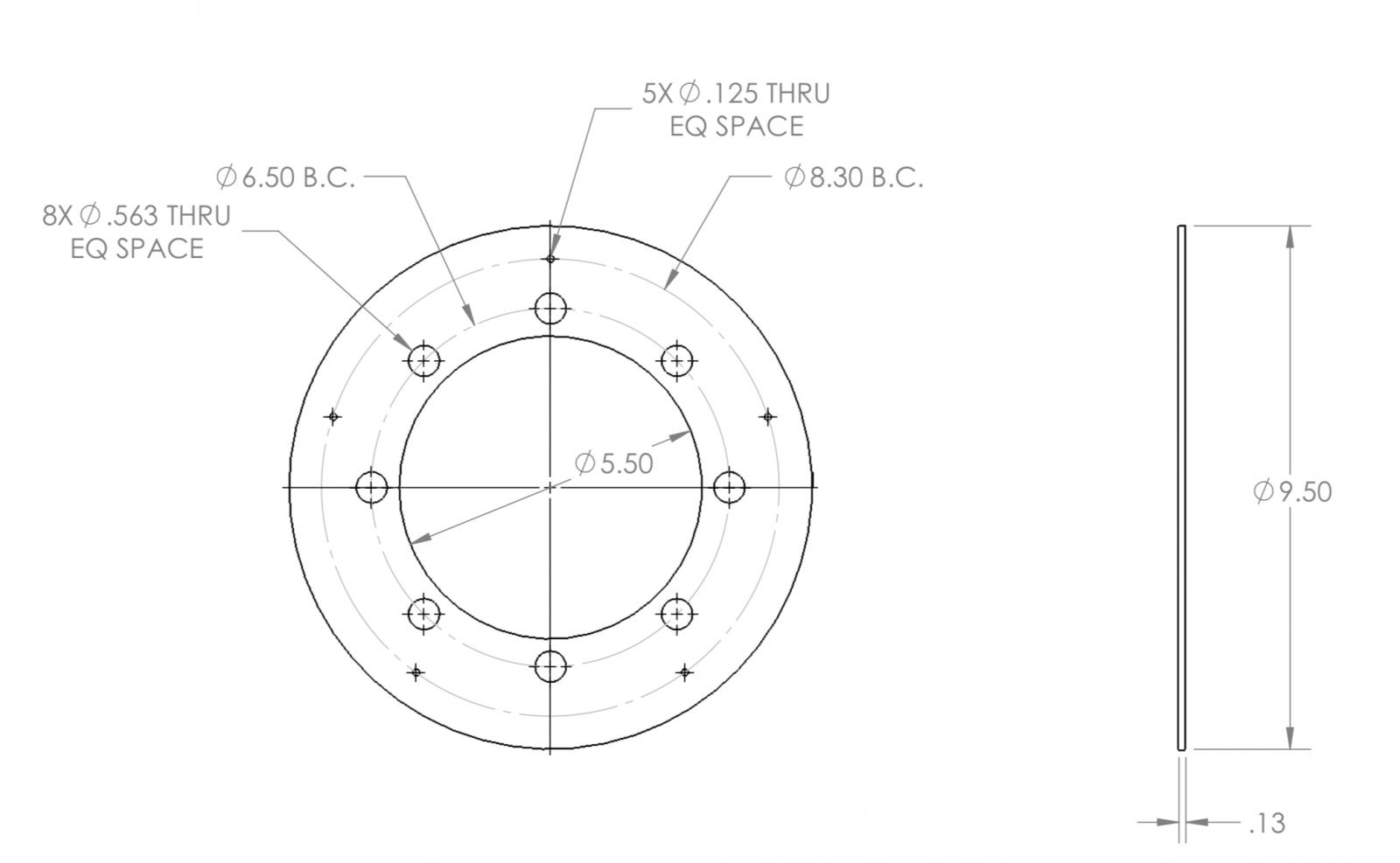

Came up with a company that will cut out some plates for me about the same price that the steel would cost. So, off to the water jet the design goes!

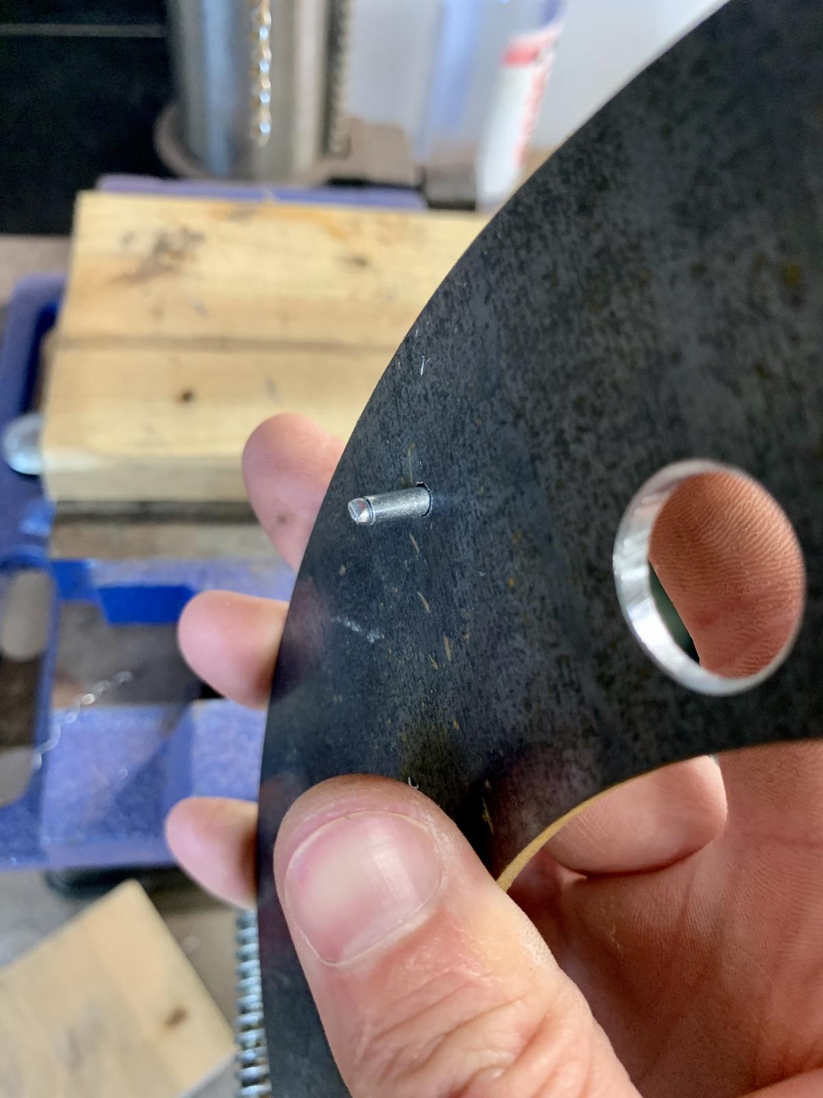

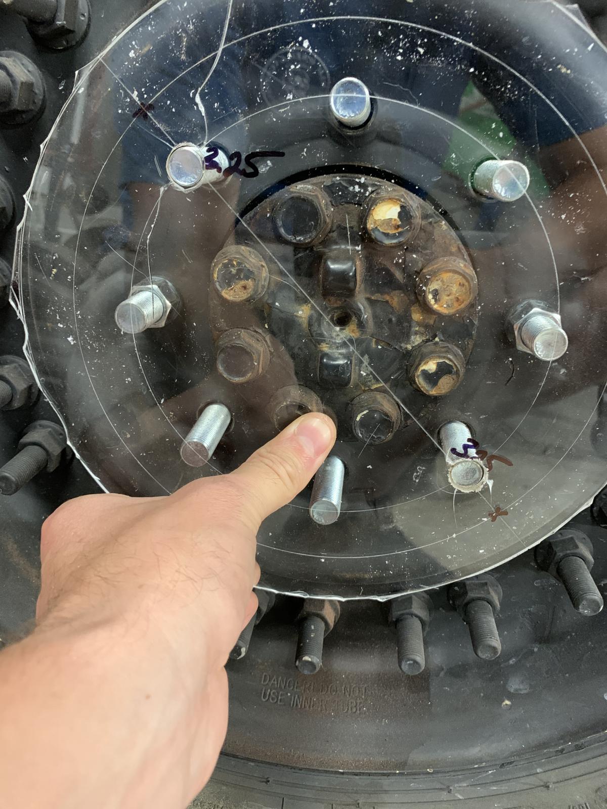

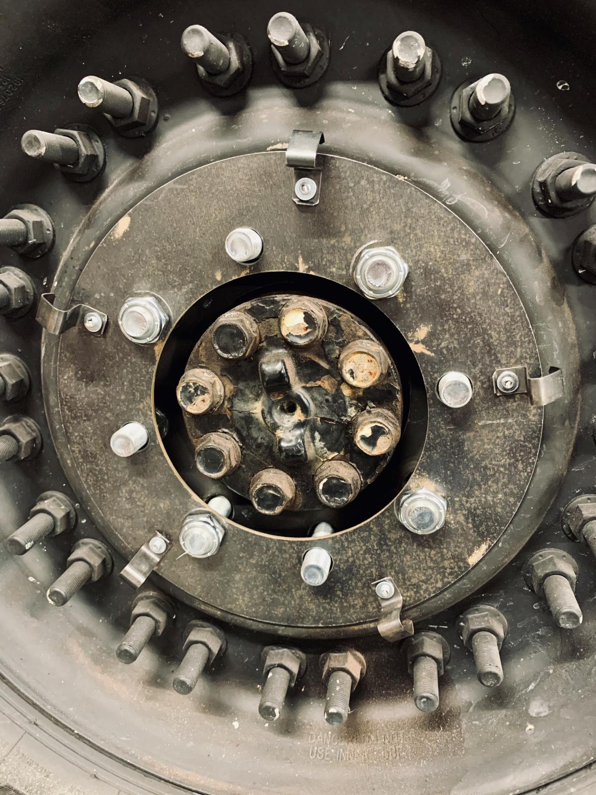

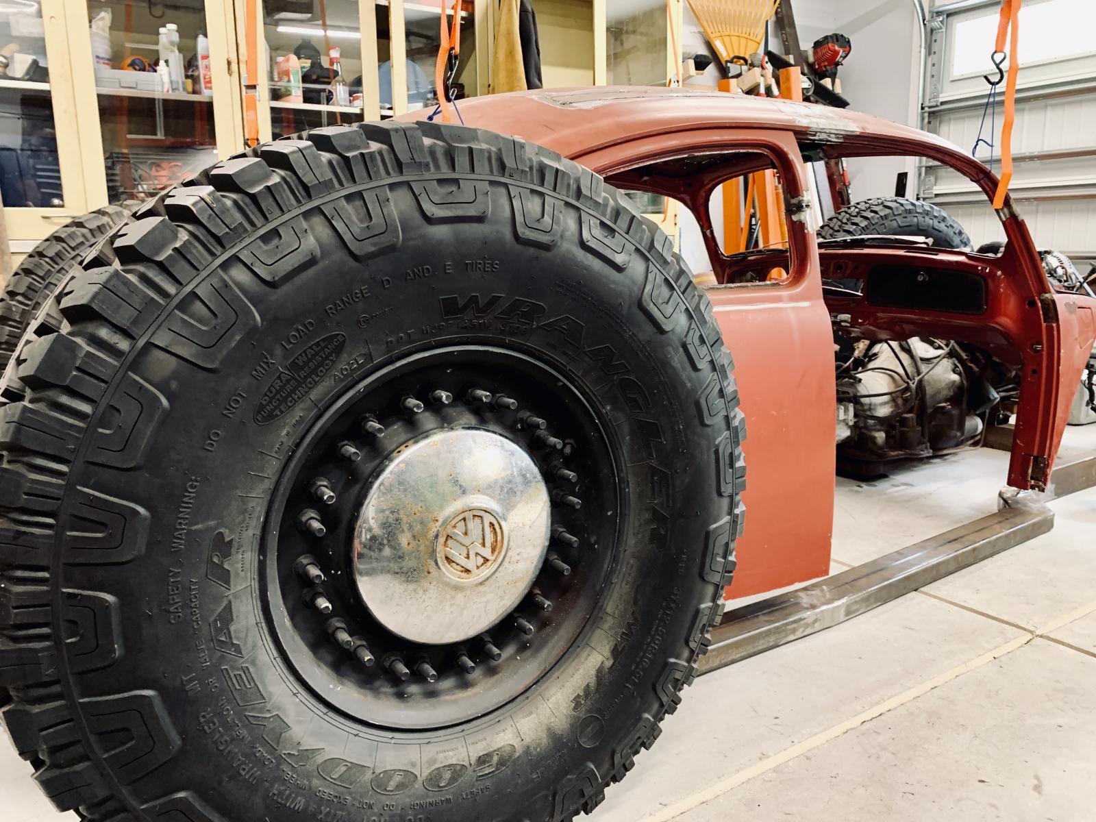

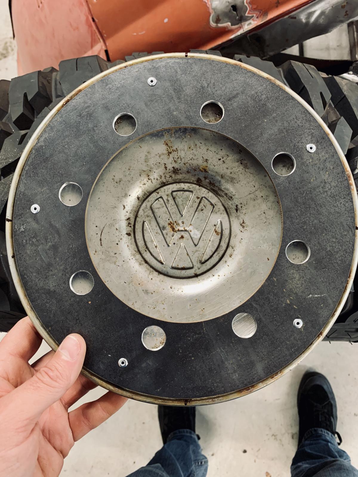

Got the hubcap adapters back from production and they worked like a charm. Now we have H1’s with VW flat hubcaps!! 🤘🏿🤘🏿🤘🏿
This is what they looked like from production
I undersized all the cuts because I wasn’t confident on the tolerances of their waterjet or my own measurements so I needed to drill the rivet holes and wheel stud holes to the final sizes.

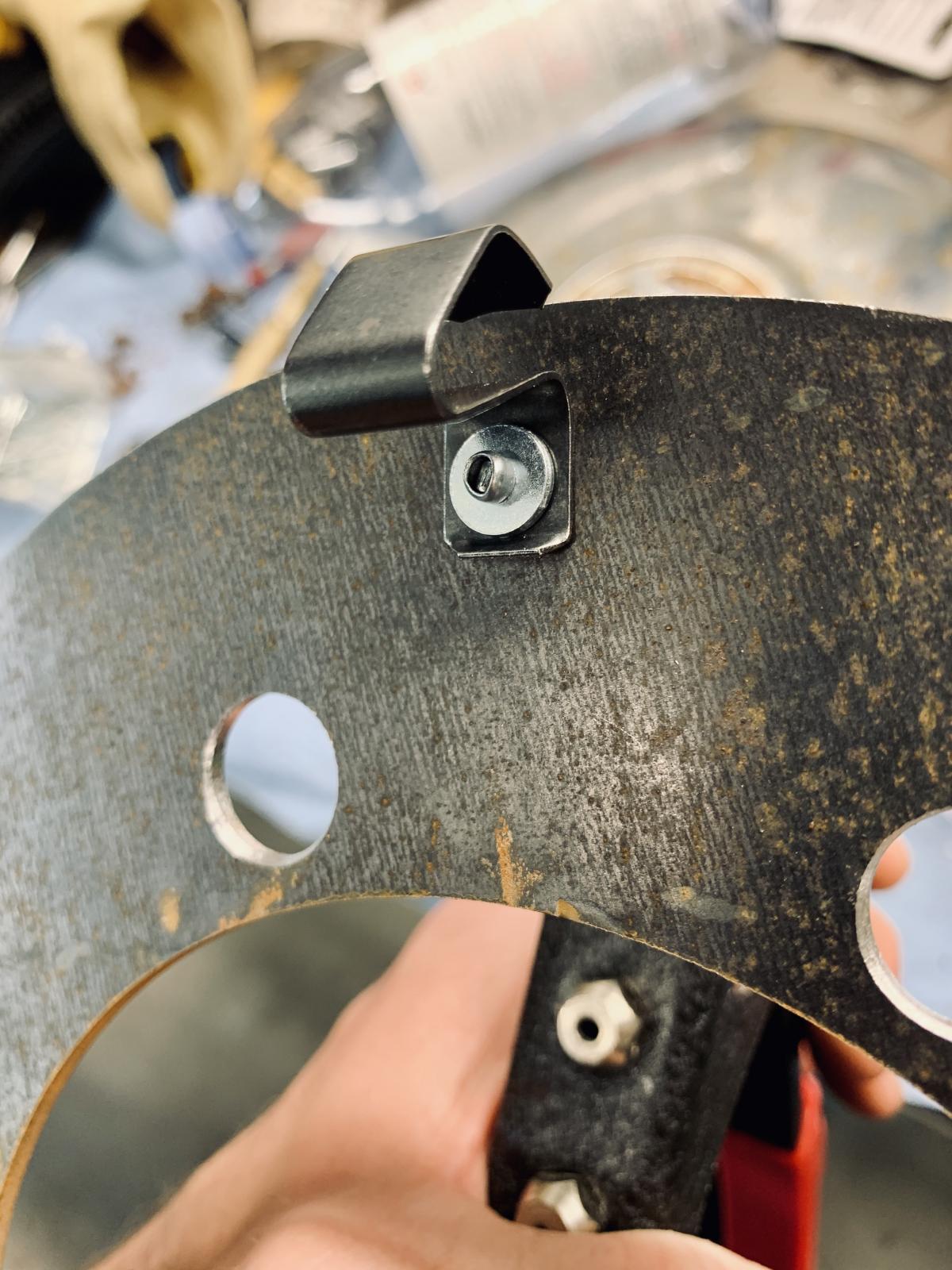

I used 1/8” blind rivets instead of the rivets that come with the VW hubcap clips. That lets me keep the position holes under sized and able to drill them out easier if they ever need to be replaced.
I positioned the clips, used a backing washer for the rivets because the clips use almost a 3/16” rivet and I’m using 1/8”. This allowed me to tweak the locations slightly if necessary based on the wheel stud hole locations...ie, if the hub caps are ever not centered, I can adjust the clip locations so it doesn’t look all cattywompas driving down the road.
Test fitted on the hubcap to check for figment of the clips. They needed to be bent slightly to grab securely but that was a simple fix.
All riveted on.
Bolted up to the wheel.
Gangster time! 😎 Not sure how sacrilegious this is but I think it looks damn nice!

finefettle
Joined: October 13, 2006
Posts: 702
Location: Shelburne,Vermont
finefettle is offline
PostPosted: Fri Jun 19, 2020 4:51 am    Post subject: Re: DeVerde - Hoodrat Project Reply with quote
Ok, that looks pretty bad ass.
Water jets are spot on so next time save yourself some labor and just put the holes you want in the cut file.
Nice job.

Just scrolling by I had a thought about that. See where you have the tail lights touching the deck lid? How about a curved cut in the tail light housings so the inside edge lays along the outer bulge of the deck lid. That would give you a pretty long curved weld to secure them, and they would open and close with (now being a part of) the deck lid.

Cool idea. Only downside is if you are stuck on side of road oncoming cars can’t see the hazards but... just carry flares I guess😬
That might be a cool idea...I’ll almost have to push the light into the deck lid half way to make the curves line up right though. I’ll for sure take a look at it and see what I can come up with. Maybe take just the lenses and light plate part, cut off the flared sheet metal, and bend up something custom all the way around that fits the deck lid? 🤔
