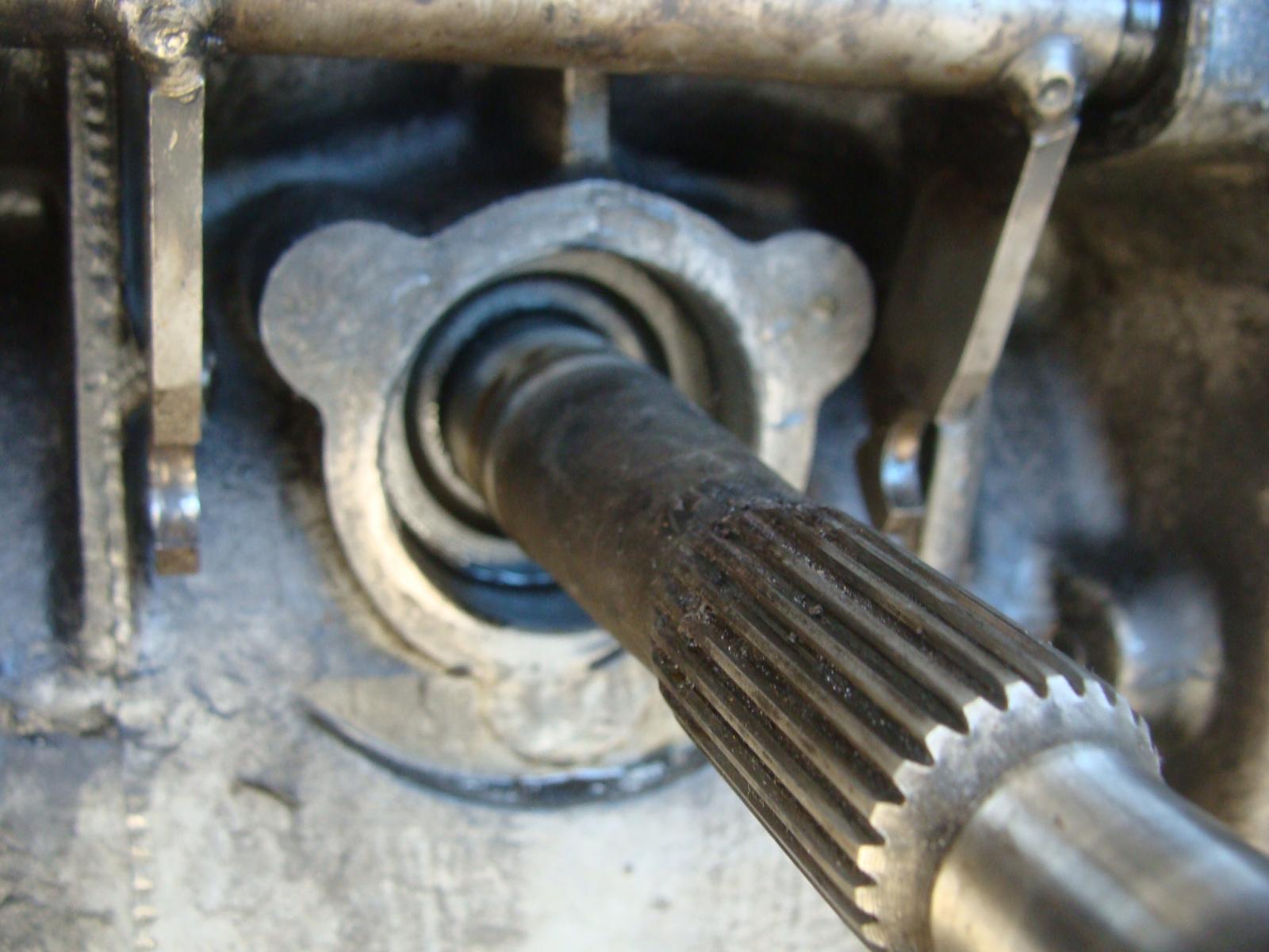

Chalk it up to a case of “while I have this apart I might as well change this...” So I have my transmission sitting on a bench because I wanted to clean up and grease the clutch operating shaft while I have the engine out. I figured, while I’m in here, I might as well change the trans. input shaft seal. I tapped the seal puller into the seal, and I had a nice tight grip on it. I had to pull as hard as I could and it didn’t budge. All I did was tear the seal apart. I tried getting at it from a few different angles, but it is too difficult to access. I even put a ding in the transmission surface near the seal, but it is outside of where the seal sits, so it shouldn’t be a problem as long as I smooth it out before ‘hopefully’ pressing in a new one. The puller below is similar to what I used. I tried tearing it out with needle nose vise grips and a small screwdriver, but I don’t think I’m getting anywhere and I’m worried about causing more damage. Any thoughts? Is there a different type of puller that might work better? I was thinking about trying to use a needle bearing puller on a slide hammer, but I think the puller might be too big. I wish I would have left the stupid thing alone.

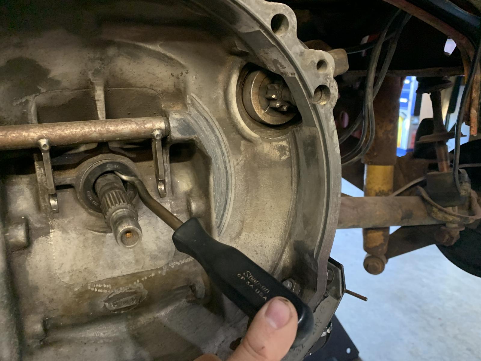

There's no turning back now. Do what Cusser said, or start picking away or cut at the rubber part of the seal and remove the bits to better see the metal housing. You can also use a sacrificial screwdriver. Heat up the tip and form a hook on the end of it . Get it in behind the seal, hook on to it and pull around the perimeter.

There's an awful lot of crunge all around the outside circumfrence of the old seal, and it's sort of welding (or at least sort of holding) seal in place. Use a knife to scrape that crap outa there, maybe even push the pointed end of your strong thin knife between seal and inside of cylindrical housing it's in. And don't be afraid to tap the seal a wee bit inward to help break it loose, so it's ready to move back in place and then out.

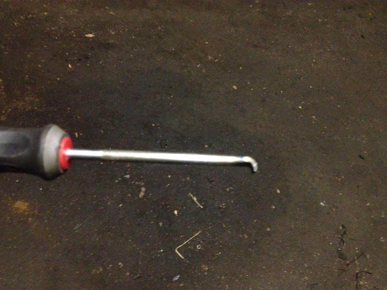

This is actually a cotter pin or key puller, it’s strong. The object here is to insert this about a half inch and get behind the seal and pull. You might try at 6 o’clock then 12 o’clock. Sometimes after years they get stuck but this tool never fails.
Here’s a better pic
So the name of the game here is get behind the seal rather than pick at the surface and having a hook type tool will aid you in doing this.
Here’s the old seal you can see where the hook got a bite on it.
Use a German Elring seal and lube the seal and shaft when going back in. Even a little lube around the perimeter. Never try to seal a dry hole😀

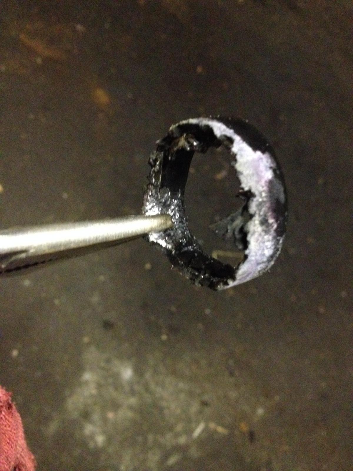

The seal has an outer metal ring behind that rubber surface. What ended up working for me after it was torn up was hooking the spike from the seal puller up under and behind that ring at around the 12 o'clock position on the seal. It popped out the first pull.

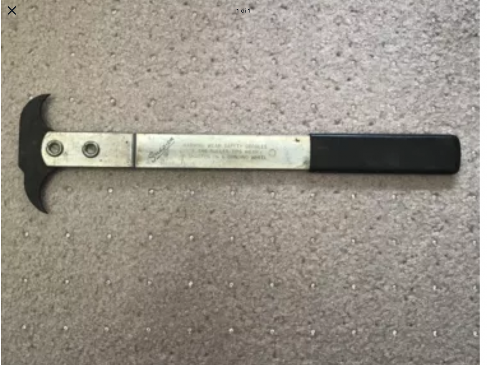

This air chisel attachment looks awesome, but I can’t justify $92. Thanks again for the great info.
I owe you a beer my friend. After spending tons of time trying to dissect this seal and trying to split it to get it out, I gave the screwdriver technique a try. I had it out in about 10 minutes. I bought a cheap Hatbor Freight flat head, heated it up and made a hook at the end. With the help of Vise Grips and a hammer it was out. I did bang up the bore a bit when I initially used the seal puller, but it seems to be near the outside edge, not where the seal sits, so I should be OK. I’m assuming I should put some Permatex or something similar on the new seal just to be safe. Any recommendations? Thanks a million.
