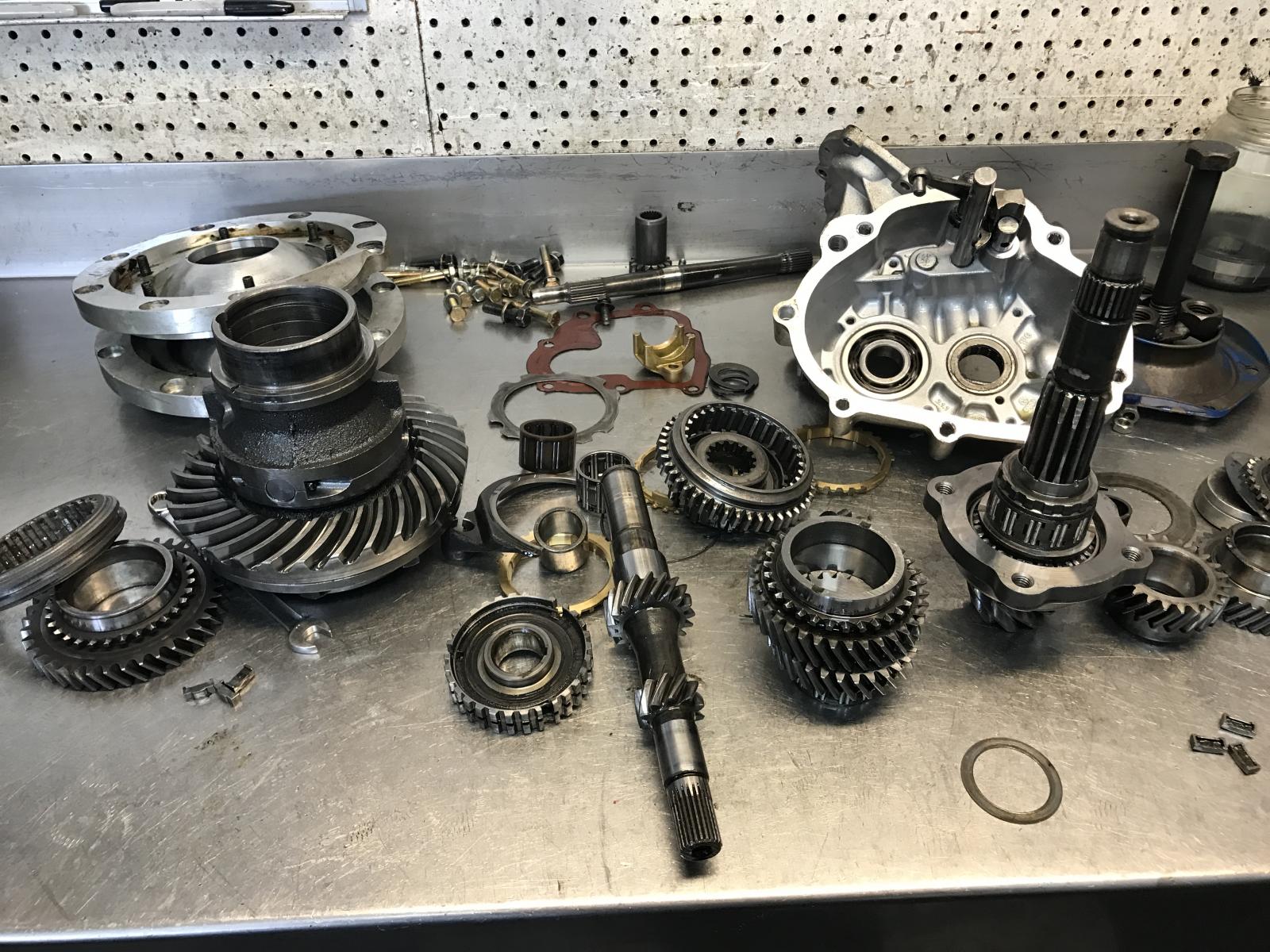

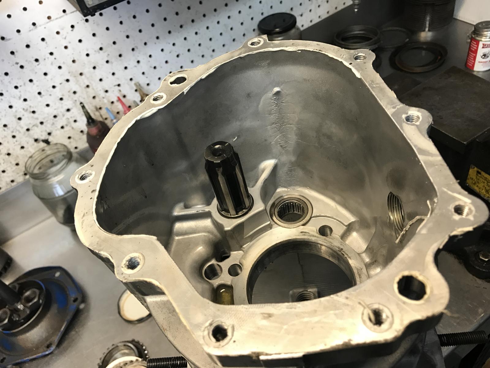

Be cautious about buying from fancy vendors with a fancy website, they are not what they appear.
This "built" gearbox was brought to me because it was jumping out of third, kinda strange as that is not the normal problem. Found the fourth gear thrust washer left out and a host of other very "rookie" mistakes.
Notice the dowels are left out of the case and the great welds on 3-4 hubs
I'll post more as I get it back together.

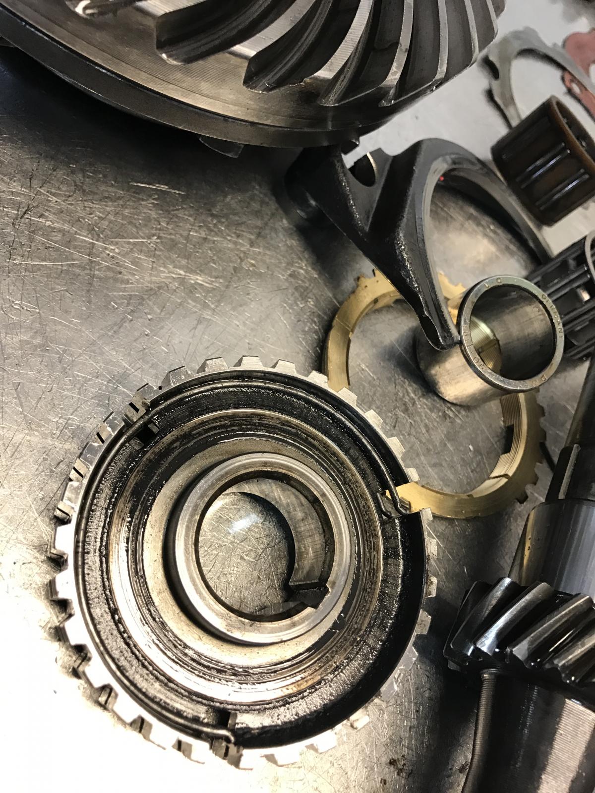

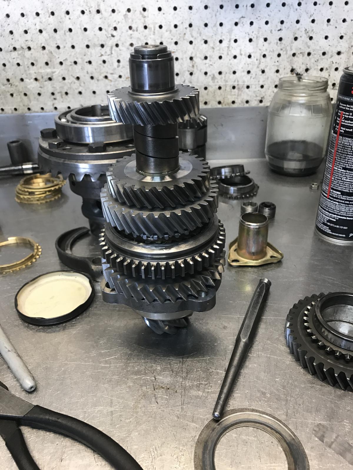

More junk
Some of the stuff cleaned
someone should step away from the hammer, this will require a trip to the lathe.
The way I remove the small pinion nut even tho I have this
Badly pitted 1st gear race
Pinion nut back ot with early 1st bearing and another race
The grinder gouges on the splines are from the previous shop and believe it or not will not effect the pinion.
1-2 slider bieng modified for late shift rail
New synchros
Modifying 3rd fixed gear for wider snap ring for 0 clearance
Finished pinion assembly

I have had to deal with two brand new boxes from the trans shop with the biggest ads. One took forever to get and made all kinds of noises right away. The other was leaking as soon as it was filled with lube. Those were for buddies cars I did the engines for.
Scott will be building my next boxes.

sweet!!!! this is the kinda crap Ive seen oh somany times as has everybody else. great work go's unnoticed 99% of the time, crap...well it gets noticed. if somebody that actually knows the difference gets to see it .just be carfull you dont offend the moron that did it or you will get nasty grams from .......the moderator... as the moron's tend to complain when they get their panty's in a wadd from being outed.....for being a moron,cheet,scammer, clueless hammer wheedling... whatever.....gee I hope I dodnt offend anybody with this.sorry everett just trying to eaze up your in box. I truly apologize for any crap Ive caused on your doorstep. you have one hell of a site hear.
is there a reason you would need to beat the crap out of the carrier like that???wtf? possiably they just picked up the BFH instead of the little bronze finishing hammer...... Rolling Eyes no i aint even done a swingy thingy but I kinda doubt you need to bash the living crap out of it.

Well the owner of this box does not want to throw the original builder under the bus, so I cannot mention names, if he wants to, then that is his choice. Thanks for the replies. I'll get some pics of the mainshaft as it comes together.

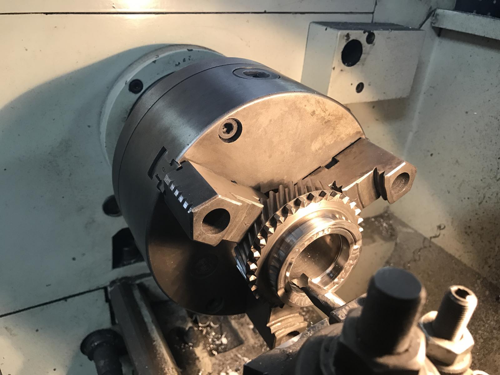

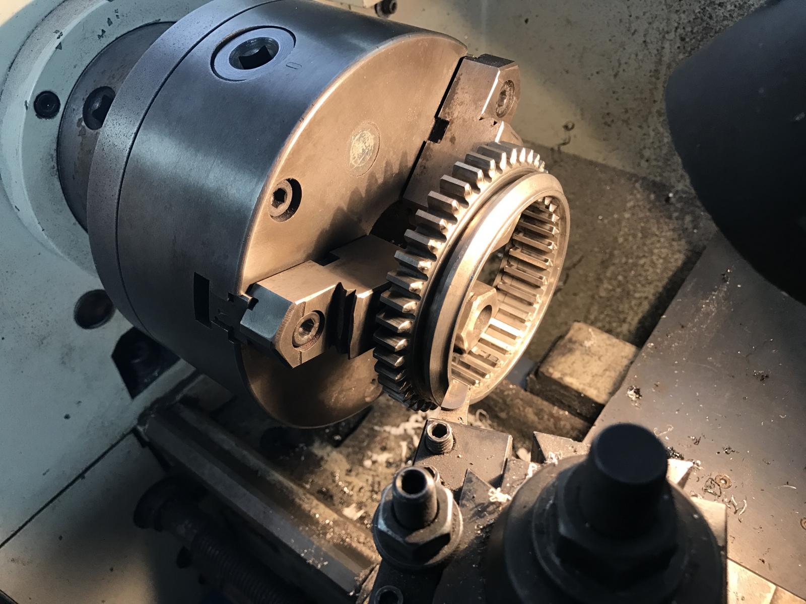

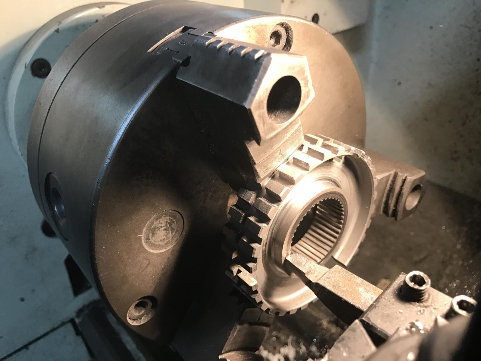

Boring the 3-4 gearsets to accept a modified 002 slider hub(after welding ect.)
Modifying a 002 3-4 slider hub for modified 113 gearsets
002 mainshaft ( often called a superbeetle mainshaft for no reason)
Modifying the 3-4 hub to accept an 091 snapring
pinion shaft assembled after setting end play on 3rd and 4th gears

So when you gather all of the strongest parts from various year and type transmissions, essentially every part needs to be modified to work together? Wow. Scott, you had told me a bit about what was involved when you built the box for my car, but I had no idea that much was involved. Are these things that you've figured out yourself, or did you work or someone previously?
Great pics, thanks for sharing.
