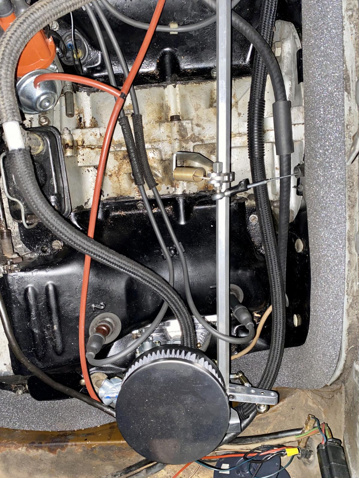

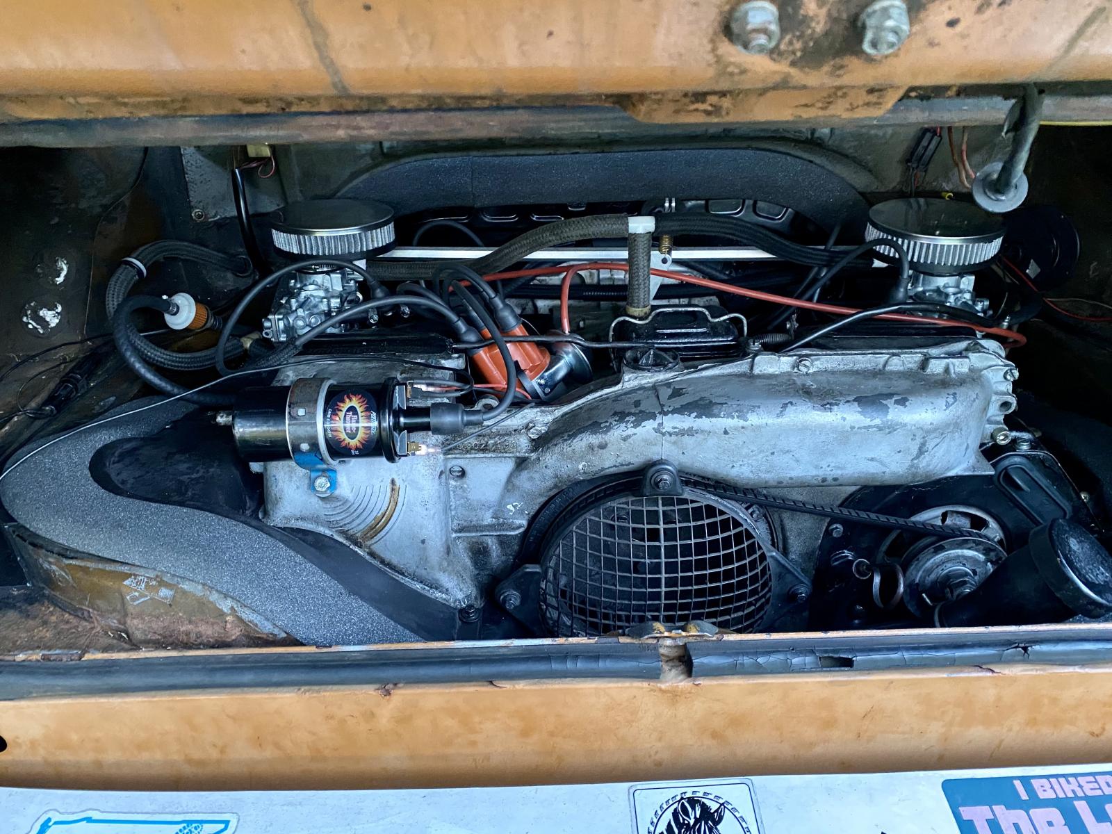

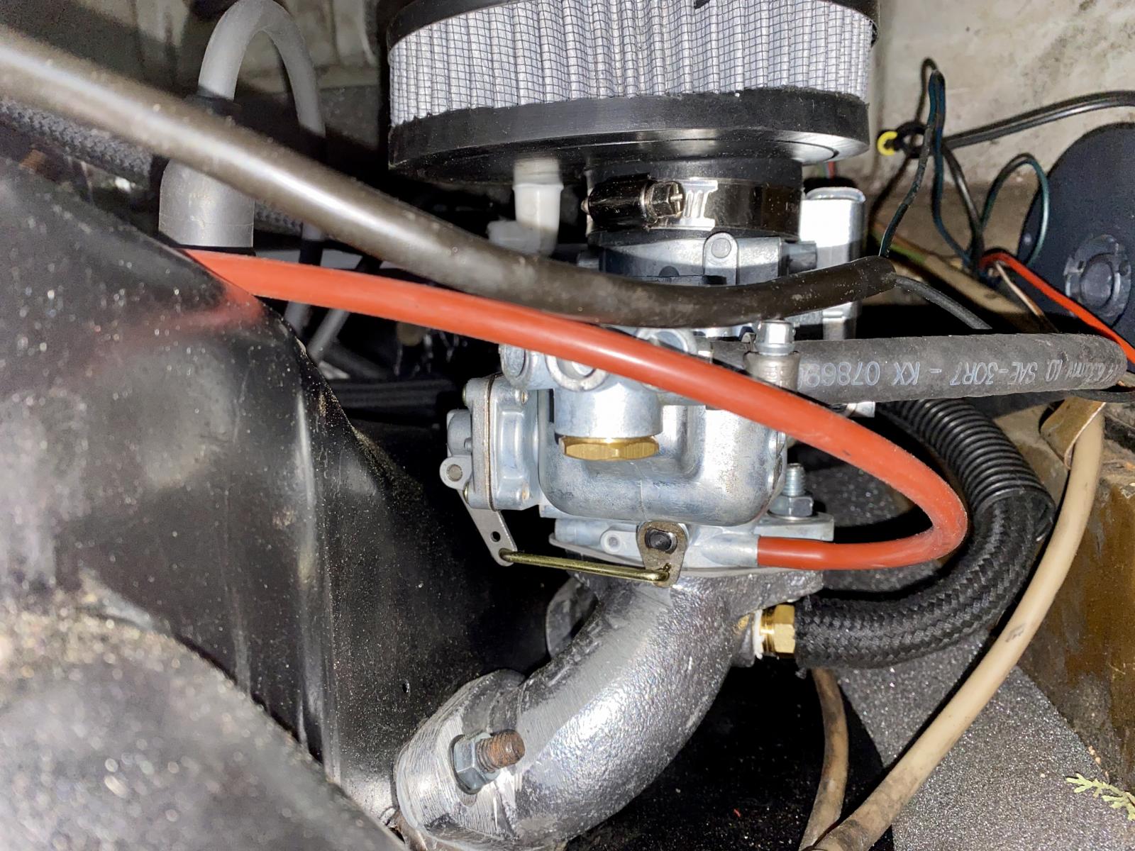

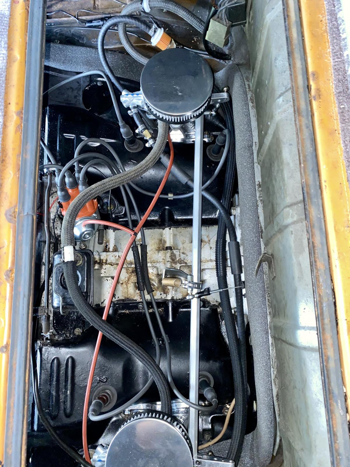

PostPosted: Thu Apr 29, 2021 6:01 am    Post subject: Re: Dual Weber 34 ICT carbs for 2.0 L bus Reply with quote
Here's what the Bus Depot kit looks like installed.
Notes about this kit so far:
1) Installed carbs on opposite sides (from what the instructions indicated) so the linkage would be on the firewall side of the engine bay. This allowed me to setup the linkage without a throttle cable extender, but I had to fabricate a Heim joint with a welded on barrel connector to accommodate the odd pull angle. I also had to cut down the 3/4 side lever on the hex bar to clear the firewall tin, so in hind site, maybe a cable extender, with the hex bar on the engine lid side would have been easier. Other than those issues, the EMPI linkage works pretty well. Setting the throttle pull on the bottom hole of the lever and the carb links on the middle hole of those levers allows the throttle plates to fully open when the accelerator pedal is depressed all the way to it's stop, and the throttle plates fully close when you let off the gas. The linkage is very smooth and it's easy to set the links so each throttle plate opens exactly the same throughout the full stroke. I had to add an additional spring to the throttle cable lever to pull the long throttle cable all the way back, as the springs on the carbs are not enough to do it. The EMPI kit came with the plate to mount to the engine, but no springs.
2) The short EMPI manifolds with thin gaskets initially concerned me that the carbs would overheat and boil off the gas from the float bowls after a drive, but so far that does not seem to be the case.
3) The manifolds did not come with hose connections for the balance pipe so I had to order 2 brass 1/4" MIP to 1/2" Barb fittings to accomplish the task. 1/4"MIP to 3/8" barb addapters are readily available at Lowe's and Home Depot, but the 1/2" barb is not as easy to find. With a single barrel feeding 2 cylinders each, I felt like a larger diameter balance pipe with less restriction at the manifolds would be better, and as well as the balance pipe works on this setup, I believe this is the case
4) As mentioned earlier, the vacuum advance ports on these carbs work beautifully. When I use my timing light and barely crack open the throttle, I get instant timing advance at low revs and the engine responds with quick acceleration. You also notice the timing advance when you get up to cruise speed and back off the throttle. you can feel the timing advance coming back in to give some extra pep under light engine load. Where I really notice the difference is on small rolling hills. with the old mechanical distributor, you would have to give more throttle to get over the hills, but with a vacuum advance, the engine has the beans to clear the hill without adding much throttle. Time will tell, but I feel like this will make a difference in fuel economy.
This engine was a mess, before I started. There was no foam seal around the engine, and there were several missing pieces from the engine tin. There were no cooling flaps installed, so I also added these and a working thermostat. I also had to seal up the holes from missing heater ducts and a big hole in the body from a prior A/C compressor install. My friend was complaining about the bus overheating (can't imagine why Rolling Eyes ) I did the customary valve adjustment prior to getting started with the carb tuning, and nearly all valves were loose. This is a hydro engine, so there should be none (2 turns in on the adjusters, engine cold). Compression numbers are #1-150psi, #2-130psi, #3 and #4 - 112 psi, so the "overheating" damage has already been done. The old center mount Weber progressive was totally hacked together with non matching pipes and JB welded on fittings. Tons of vacuum leaks. You can make the center mount carbs work, but this one wasn't even worth trying, so that's what led me down the dual carb path next
I'll add one last note on the distributor. I replaced the old Bosch .009 with a pertronix SVDA, as I've had really great success with this one on my own 78 2.0 bus. The new Pertronix manual emphasizes replacing the solid core spark plug wires with wound "mag" core wires to prevent EMF interference messing with the pertronix ignitor over time. The one on my bus failed recently after years of trouble free running, so I'm wondering if Pertronix may be on to something with the new recommendation for wound wires. They also emphasized using a 3.0 Ohm coil max. The Bosch Blue coil that was on this one measured almost 4 Ohm, so I replaced both the coil and plug wires with Pertronix brand ones. The wound core pertronix plug wire set is for a type 1 motor, so you have to fabricate some extenders for the #2 and #4 cylinders to get them past the cooling tin. The plug end connectors are crimped on, so you can't just use your old ones on the new wire set. Kind of a pain....
