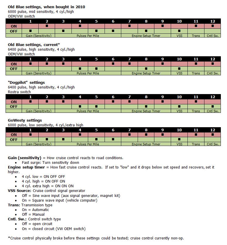

PostPosted: Sat Jul 12, 2014 6:41 pm    Post subject: Reply with quote
So its working ,but I do not see on GW's instructions where they say to set it at 4000 pulses . After trying other things I will now re set that,it functions under ideal conditions but has a bout a 5 MPH swing before locking in and dies under load.
I wonder if it would not be better to hook the Tach wire up and see what it does. Any way I am real close I decided to stop and have a nice cold Iced Tea . Comments suggestions ,fire away .

I don't know about the Rostra unit that, I think, GW sells, but on the AudioVox I put in our '90 Westy, the computer/controller must be powered down and back up when making changes. That is, if you change the options switches, disconnect the constant 12V source for the computer. When it powers back up, it'll re-read the switches and the changes take effect. At least that's how AudioVox handles it and it can't hurt to try it with the Rostra.

PostPosted: Sat Jul 12, 2014 8:49 pm    Post subject: GW Rostra cruise Reply with quote
It does say to make changes when off. There is one power lead which is ignition switched. No maintainer like a radio .
I might try it for giggles though. I changed the pulse to 4000 and it is better but still has a 5mph swing and does not like hills.

kamzcab86
Joined: July 26, 2008
Posts: 8590
Location: Arizona
kamzcab86 is offline
PostPosted: Sat Jul 12, 2014 9:02 pm    Post subject: Reply with quote
FWIW, my van has an old (circa 2000) Rostra in it and the instructions were included. Manual clearly states that if you make changes to the dip switches you must unplug the connector at the "brain" (for a minimum time; don't recall how long it is), then plug it back in for the changes to take effect... just as you describe.

PostPosted: Thu Jul 17, 2014 4:05 pm    Post subject: Reply with quote
16CV's wrote:
So if you've done this and have an A/T 2.1 2WD can you tell me what your pin setting are ? I have been playing with them and have had mixed success .
I've been going through old loose paperwork that needs filing away and came across my cruise control notes. Took the time to digitize it all:
Remember that my Rostra dates back to around 2000-2003 and the GoWesty settings date back to then. Most importantly, mine is not functioning (one component broke, another broke and went missing and I haven't done any work to repair it... yet).
