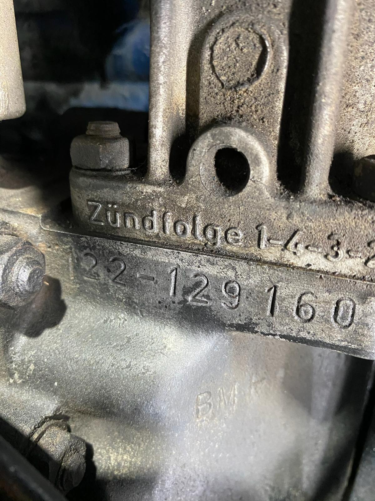

This is in a 1959 Beetle. Any ideas what it is? The number is 122-129160

122 is an industrial engine, looks to be a 1964 engine.
