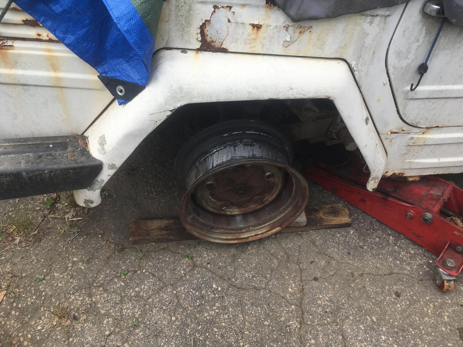

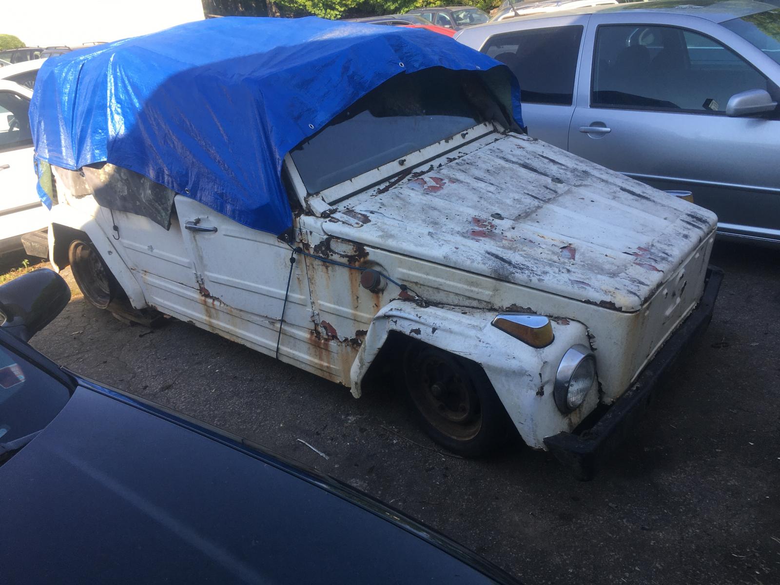

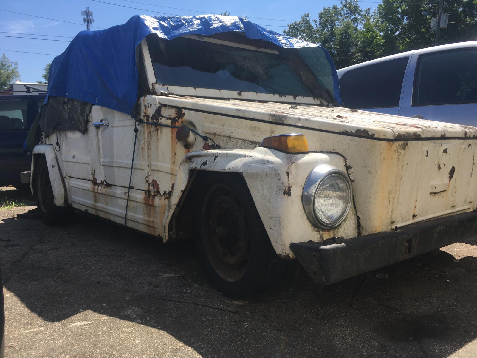

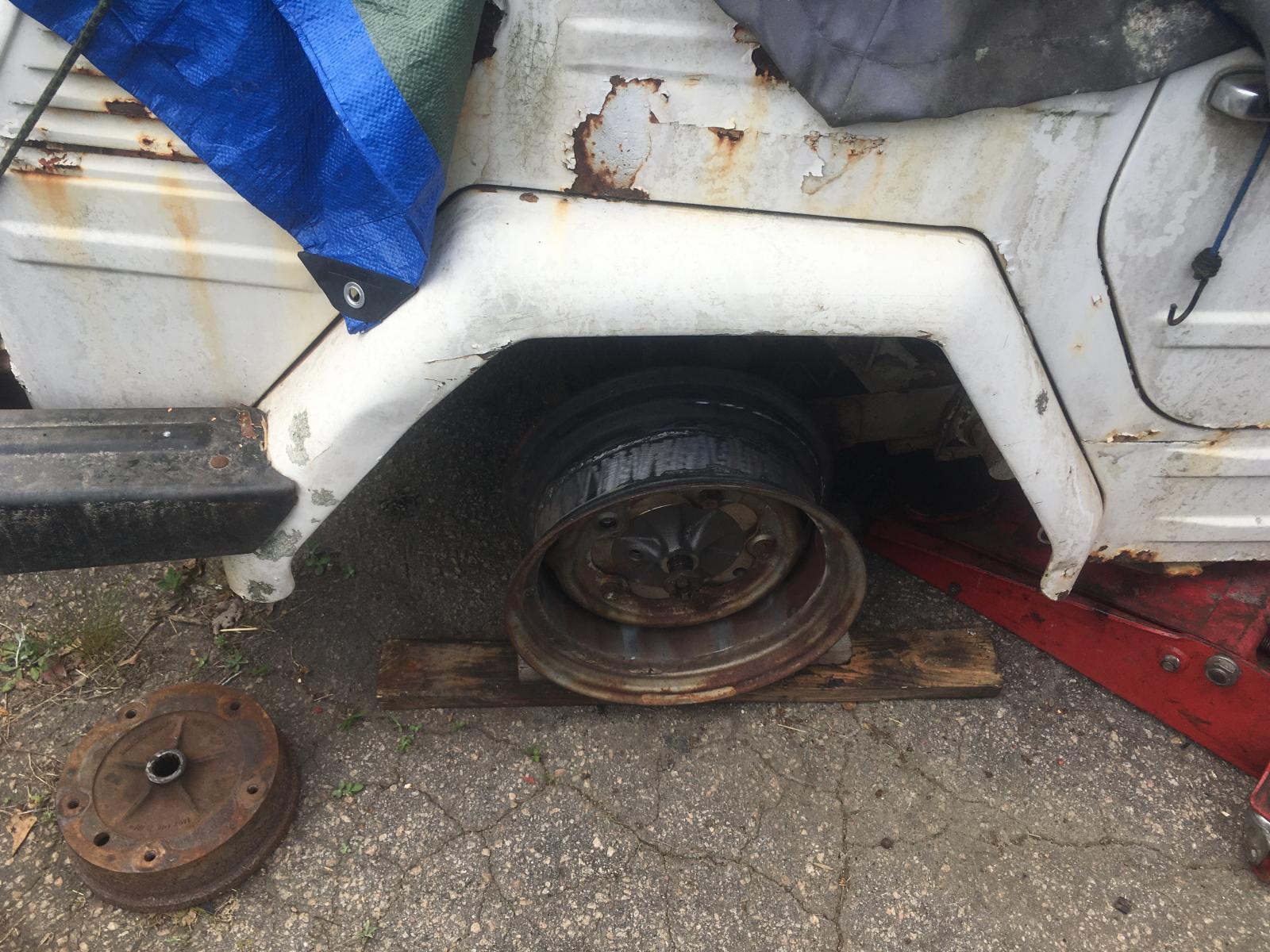

Instead of waiting for parts to repair the buzz box, I went down to the Chinese tool emporium & picked up a new Vulcan unit & finished up the wheels.
Just for shits & giggles, I mounted the first one up on the stock Thing drum.
The outer lip barely protrudes past the fender.
But upon installing the Beetle drum, it tucks back in under the fender.
And the high humidity is already bringing back the weathered look.

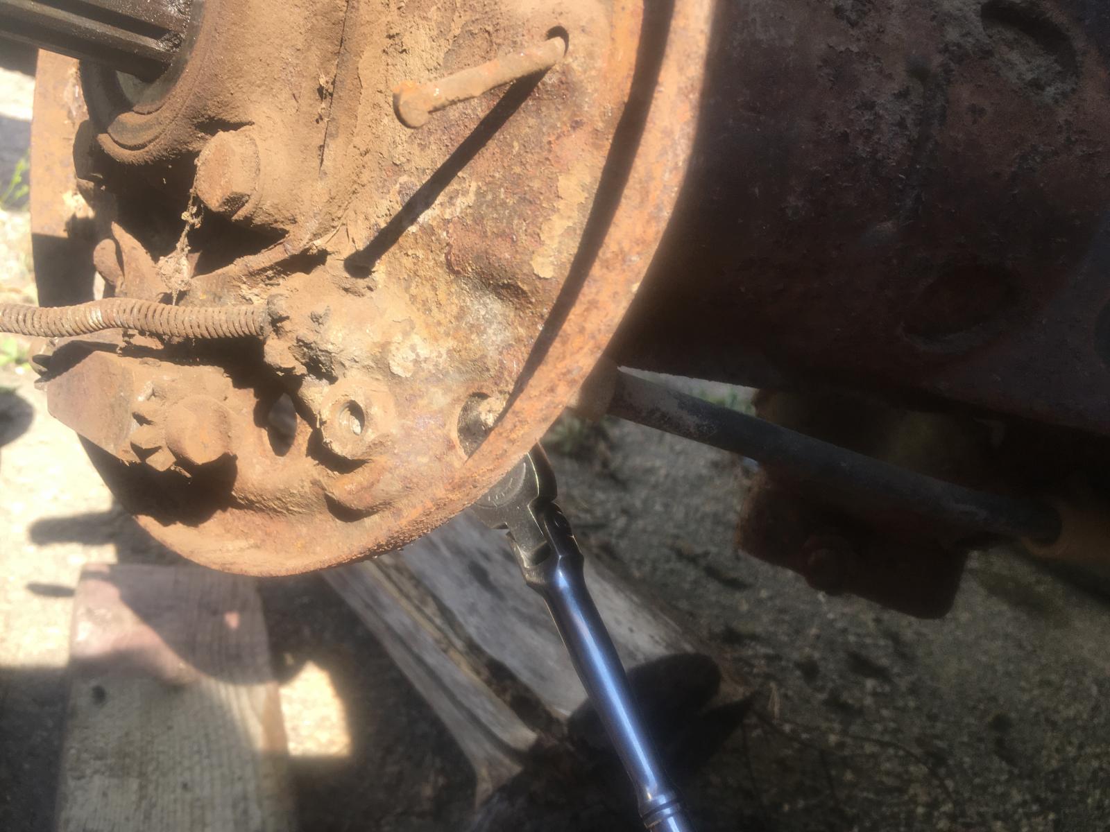

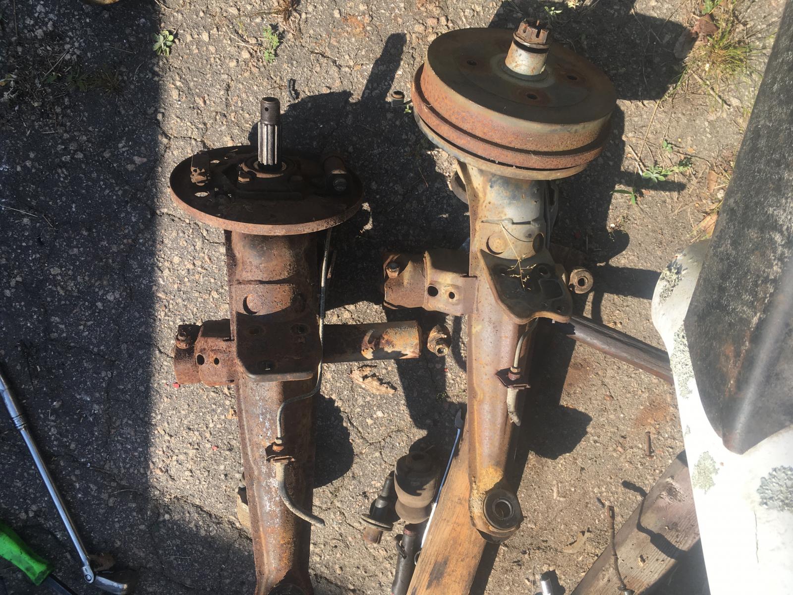

Today, with a few minutes to piss away, I just had to start the trailing arm swap, so I jacked up the rear & removed the wheel & brake drum & then removed the upper shock bolt.
With those out of the way, I chiseled 45+ years of crap out of the CV bolts.
And then hammered a twelve point socket into the bolt heads.
And zipped them out with the impact gun.

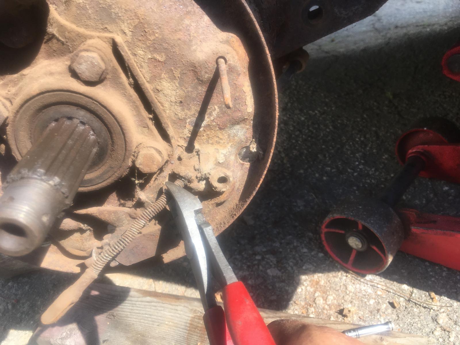

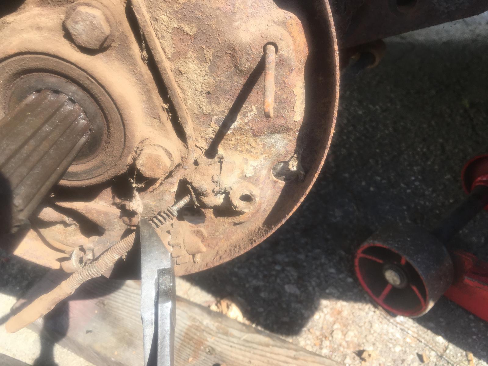

I then removed the bolt holding the parking brake cable to the backing plate.
With the bolt removed, I then slipped a pair of side cutters into the spring on the cable.
And compressed the spring & lightly clamped onto the cable to keep the spring out of the way while I fought with the retaining clamp.
And removed the cable.

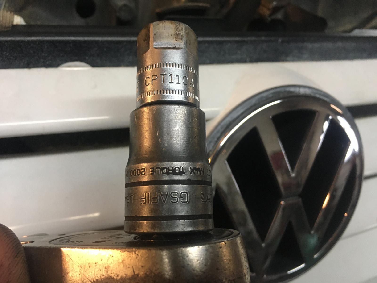

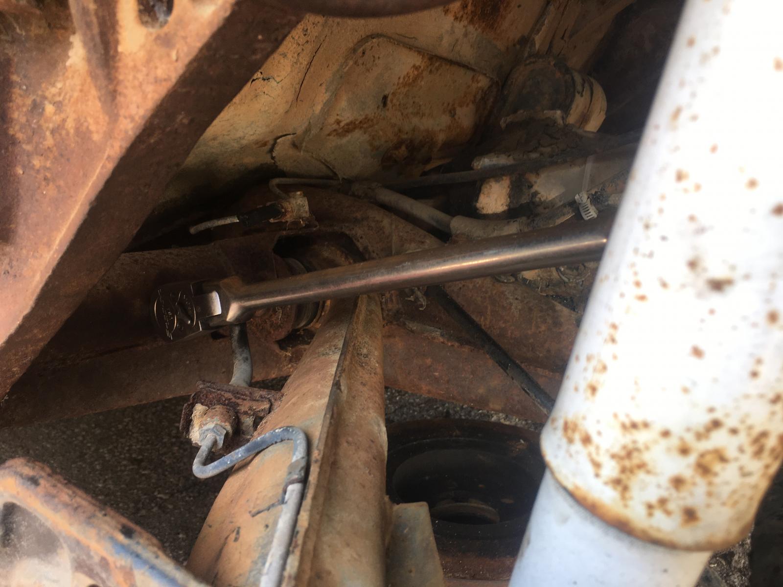

After cutting the brake hose, I then inserted a Snap-On17mm Allen drain plug socket into the trailing arm pivot bolt...
& pried on the ratchet with a pry bar. This not only increases leverage, but it also keeps my appendages clear of most of the rusty bits.
After removing the pivot bolt, I dropped the arm out of the way.

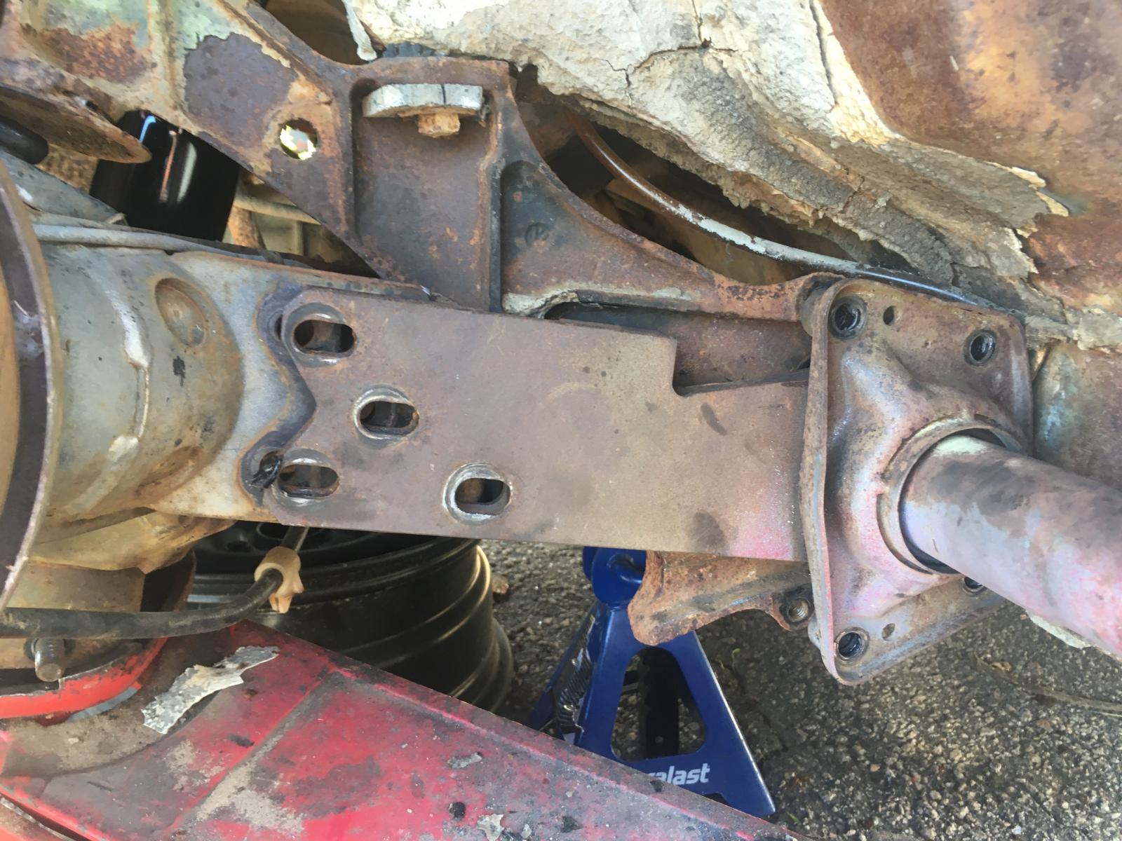

Setting the arms near each other, you can see the difference in the lower shock mount between the Beetle & Thing trailing arms, the Beetle ones are longer allowing the arm to be moved up while retaining full range of motion.
You can also see the difference in the bolt pattern for the mounting point of the spring plate.
I then bolted the Beetle arm in place & installed a new air shock to see where the arm would be at full droop.
This is where you can see the difference the lower mount makes.

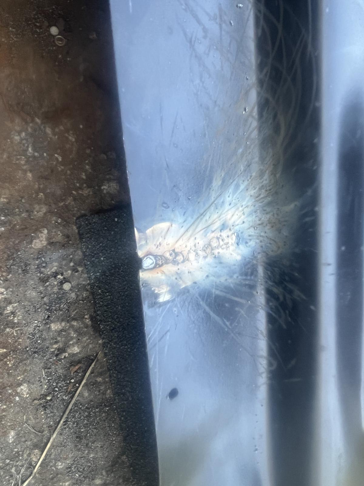

After thoroughly inspecting the welds, I was fairly confident that there weren’t any porosity issues but... I scored a tube of silicone sealant & schmeared a bead over the seams.

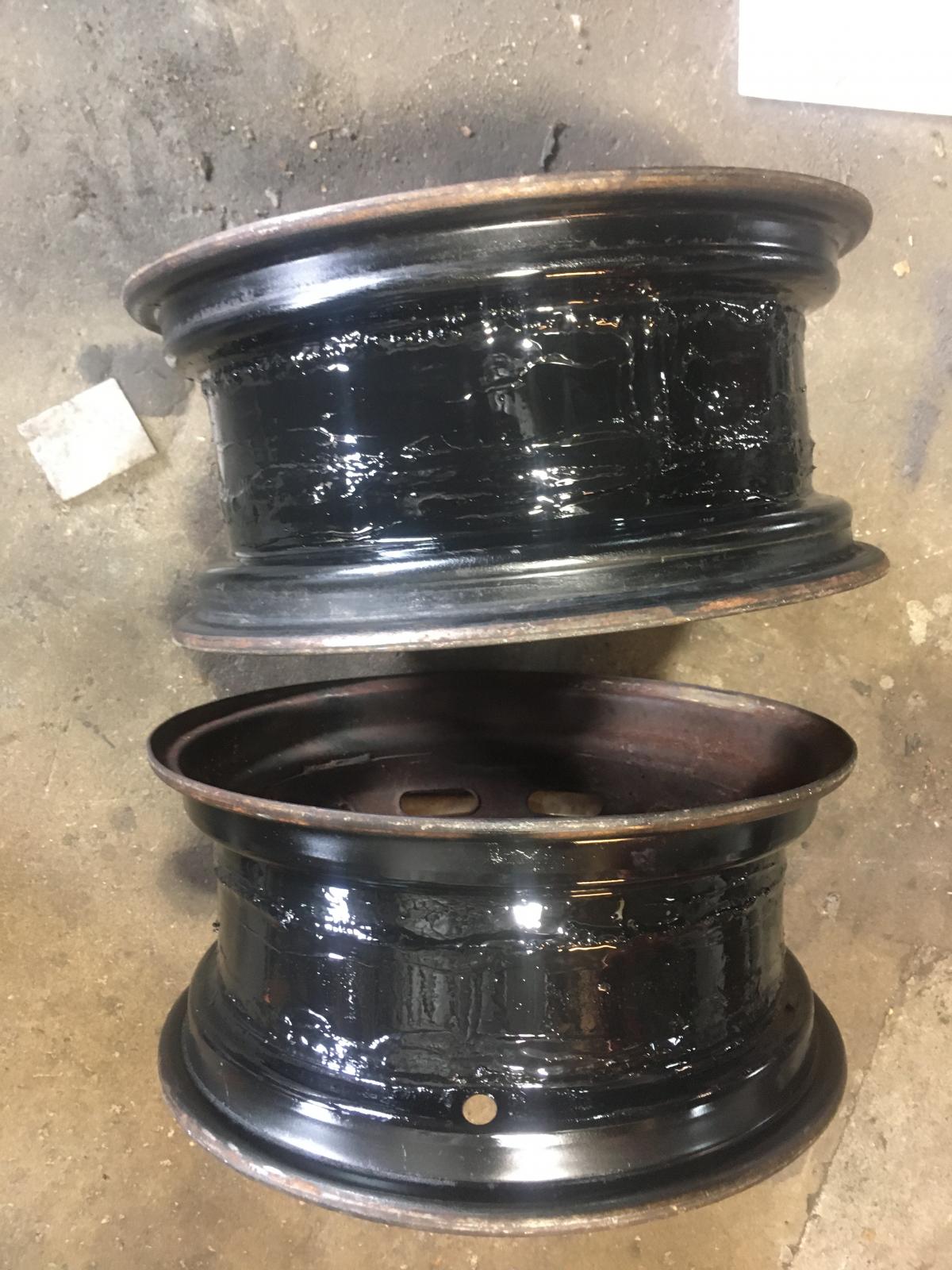

And, well... I lied. I decided to paint some shit after all. Confused
Then I swiped a pair of 195/65/15 tires off a Jetta & had them wrapped around the steelies. Believe it or not, these steelies were a good 3-4 lbs lighter than the alloys off the Jetta. Think
And then just had to bolt one up.
Yeah!!! THAT’S the look I was shooting for.

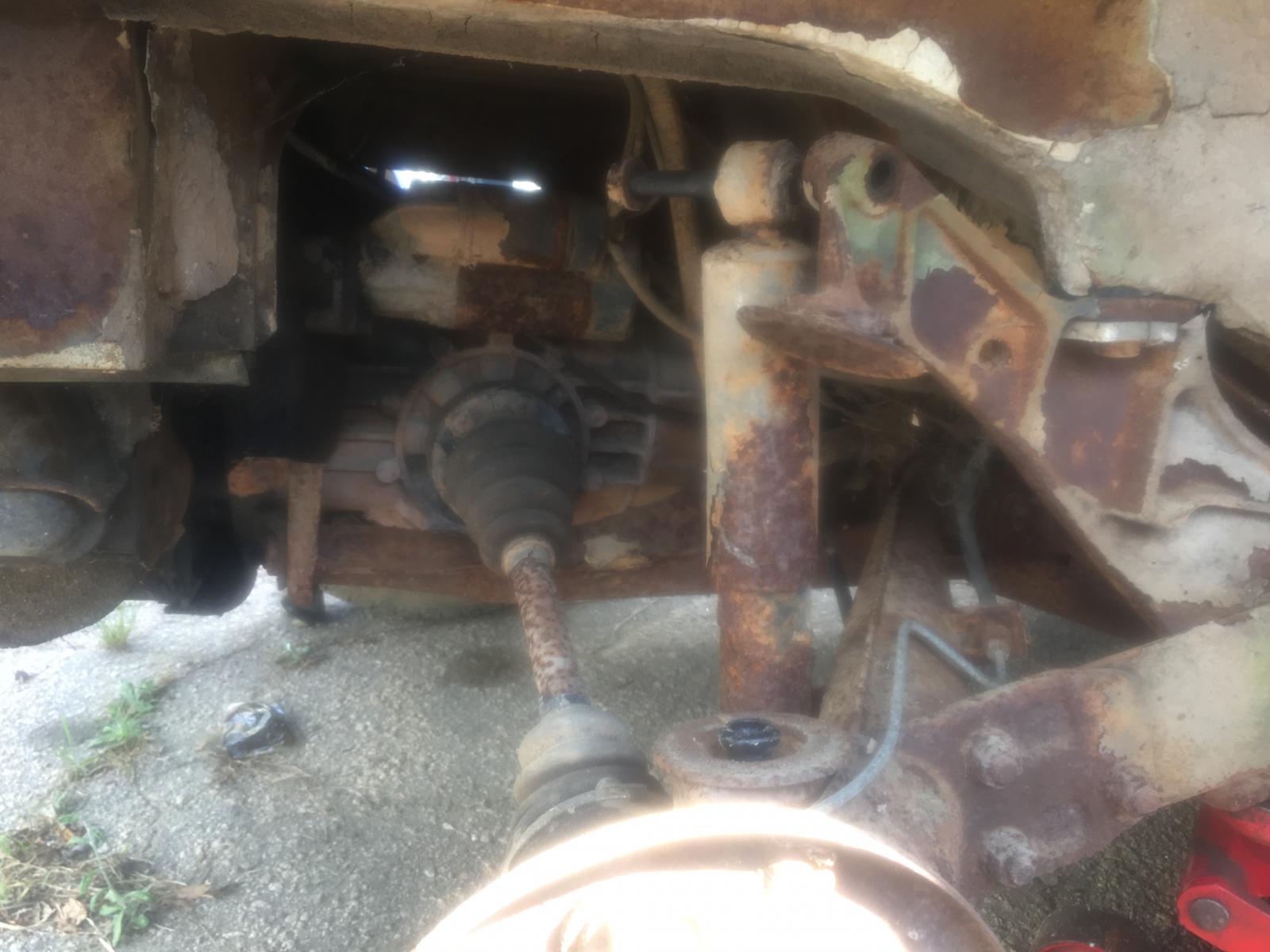

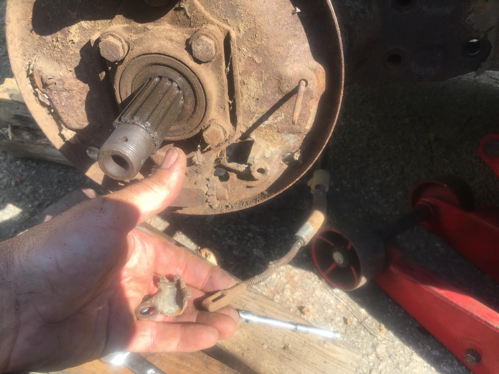

So I had to stop what I was doing & yank the last remaining trailing arm.

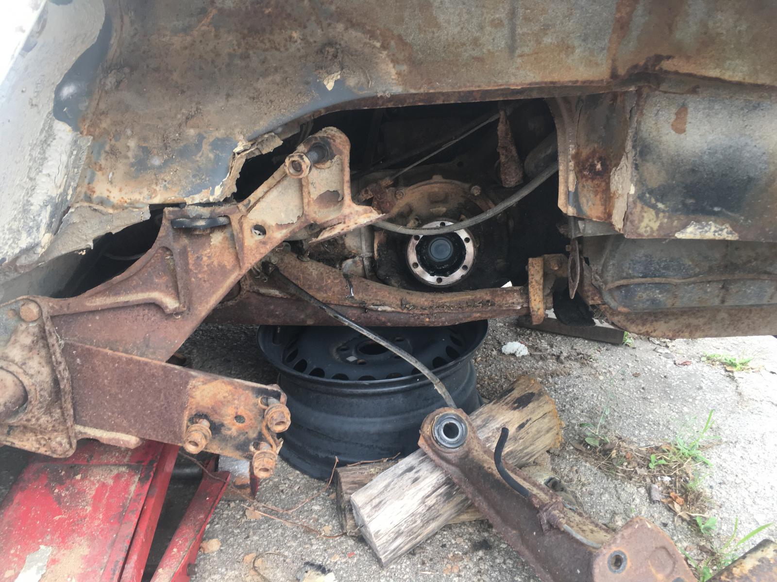

WELL! It’s a good damned thing that I didn’t drag this bitch any further than I did. Shocked I found that the castle nut was loose.
And I spun it the rest of the way off by hand.
After jacking it up & removing the wheel & drum, I chiseled the concretions out of the CV bolts & zipped the bolts out.
Huh, who knows how long ago that fuel line broke.
Worse yet, what appears to be wet & oozy is more like cured epoxy. Confused
Oh well, off with its last trailing arm.

Today I set my sights on installing the Beetle spring plate & torsion bar. The typical means of lowering is to reindex the torsion bars about two outer notches. Since I plan on swapping in the Beetle parts, I needed to get an idea of where that would be with the existing bits still in place so I removed the retainer & adjusted the Thing spring plate up two notches..
And then scribed a line where the bottom of the spring plate would now be.
I then rotated the trailing arm up to see where it would need to be clearanced.
Since earlier & later models do not utilize the fourth bolt hole, I decided to lop off the end where the fourth bolt hole was.
I already had a pair of double spring plates that had been notched for a lifted application, I had notched these before I realized it was not necessary to notch the outer plate so removed these from that vehicle & using the one from the opposite side, I flipped it & began to map out where to notch it for this application.
After removing the torsion bar, I raised the trailing arm as high as it would go to determine where the stop needed to be, I scribed a line on the spring plate & ground away until the new notch was to my satisfaction. If you look closely at where the bump stop should be, you can see that this is the lowest that the car can go before you would need to start cutting the stops off or cutting on the chassis.
I then removed the bolts attaching the leading edge of the fender to allow me to flex it out enough to install the new torsion bar & spring plate. After that was done, I lubed up a new set of urethane bushings & after several adjustments to the torsion bar, I got the spring plate bolted up & dropped the beast back down.
Here it is bearing its own weight again (on this side anyway.)

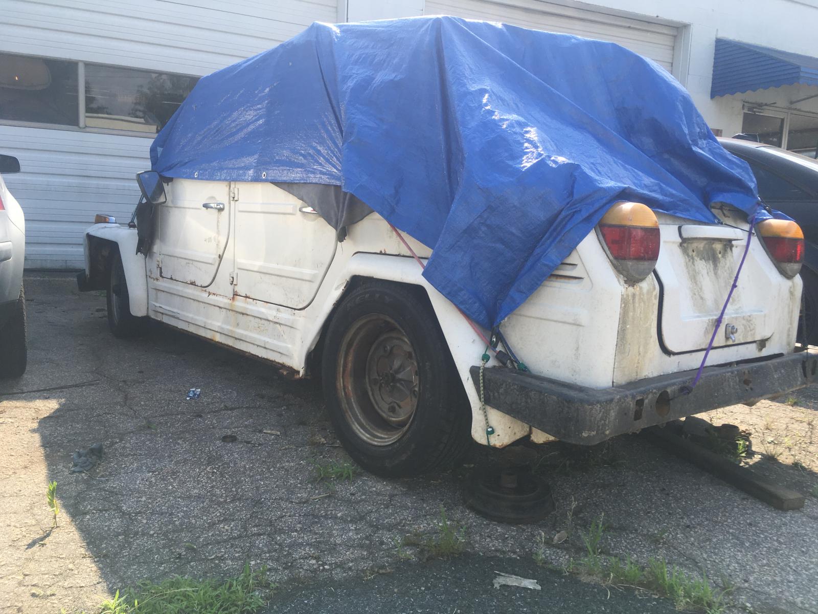

Having this turd in the way since I kinda forgot about it while playing with a few dozen different projects & flips, I recently put another VW up for sale & was contacted by a local artist that wanted the shell for some sort of display, but didn’t need the whole car & wanted a better deal.
So I struck up a deal, drug the car to his house, & pointed out what to disassemble.
That left me with the pan & title…. Now let’s see, what should I do with it now?!? Buy a buggy body & shorten the pan?
Oh yeah, the Thing.

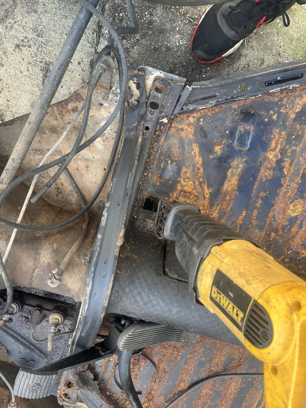

After dragging it back to the shop, I commenced to lopping out the old pans.

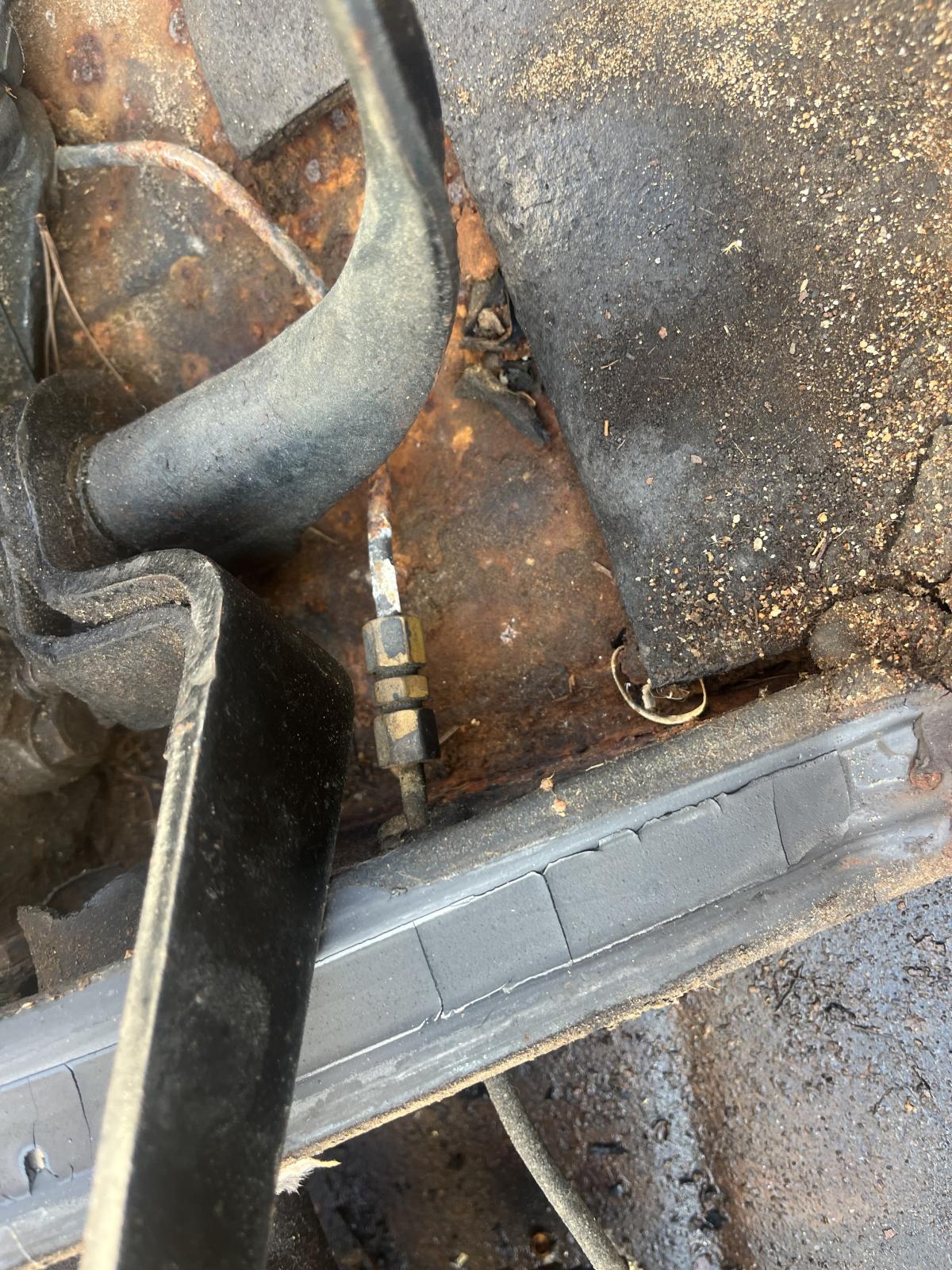

Ah yes, the obligatory compression fitting on the brake line.
Oh, and the complete lack of a pedal stop and the push rod for the master cylinder…
After breaking a saw blade, and realizing that the shade had shifted away, it stopped being fun & started to suck, so I packed it up & called it a day.

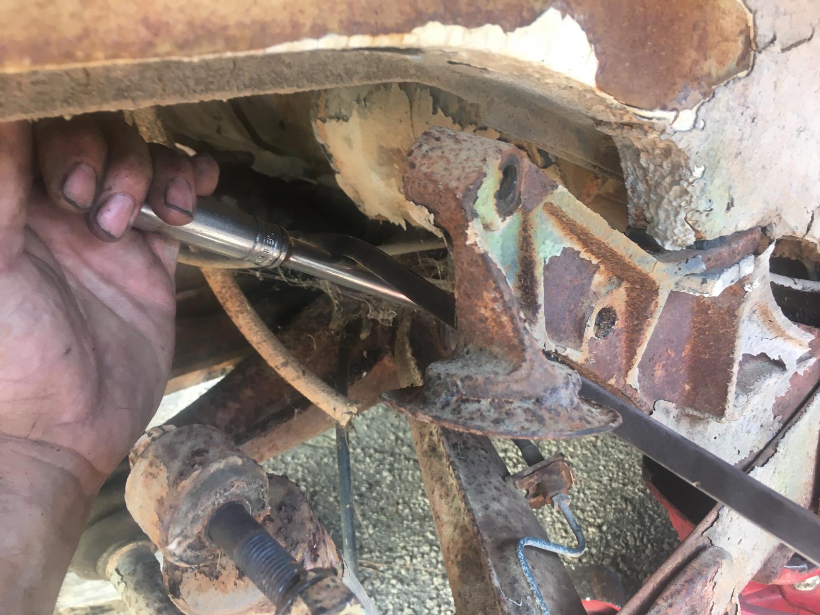

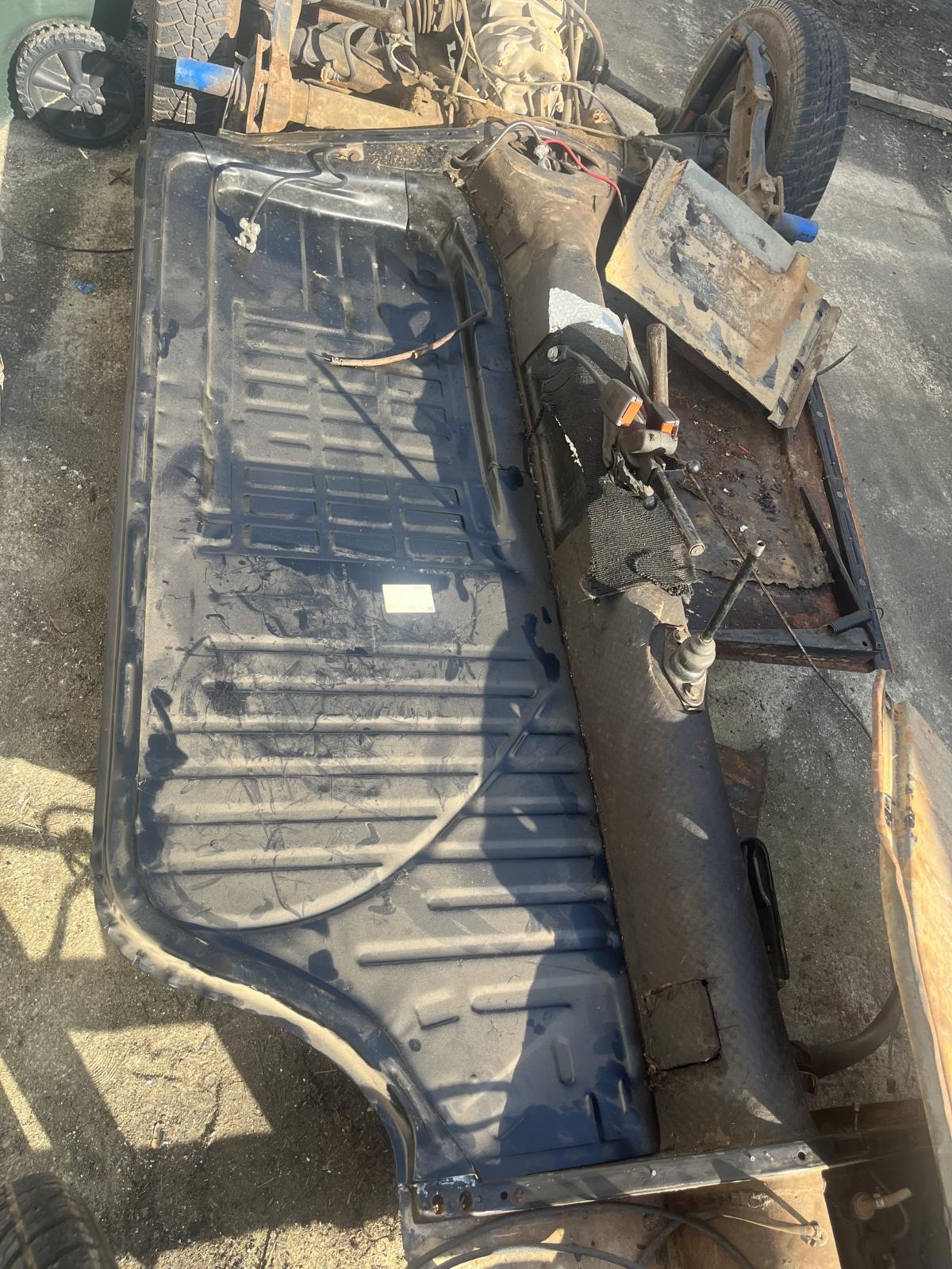

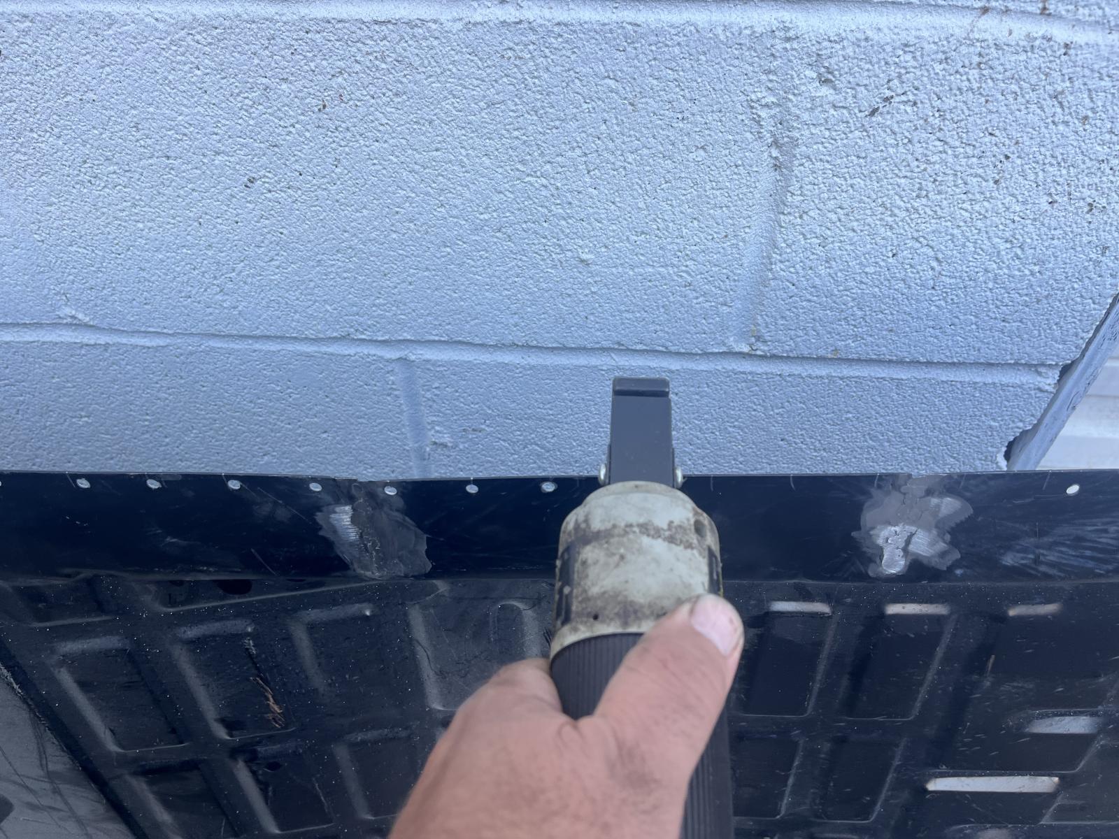

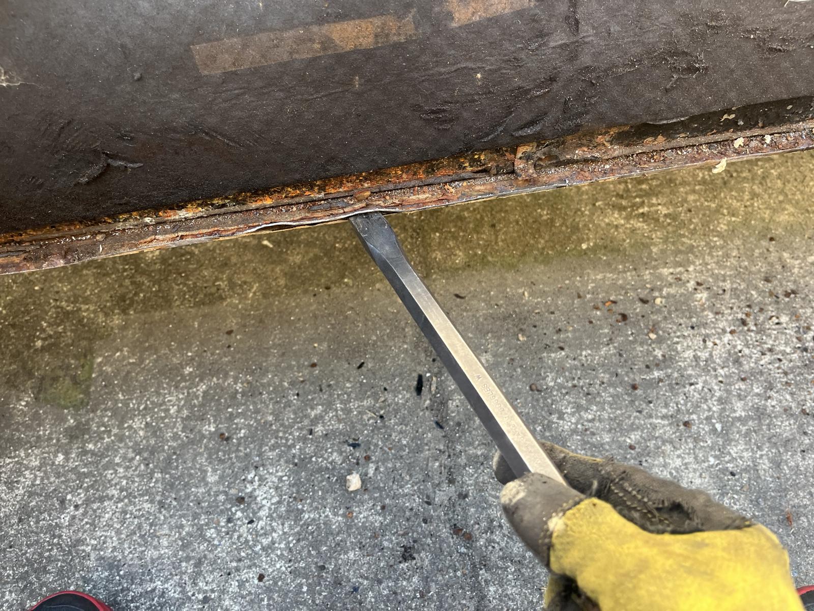

This morning I grabbed my trusty chisel & proceeded with my “ribbon cutting ceremony” & removed the remaining layer of the old pan on the passenger side.
And laid the new Thing pan into place.

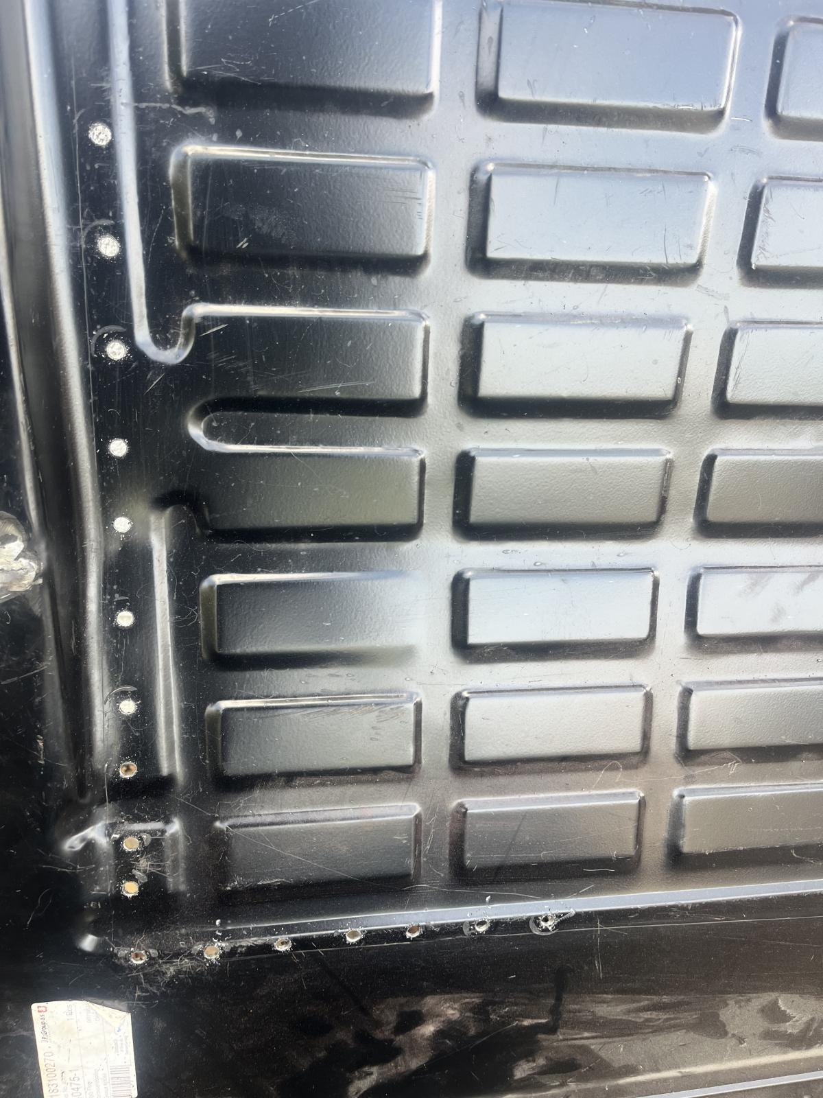

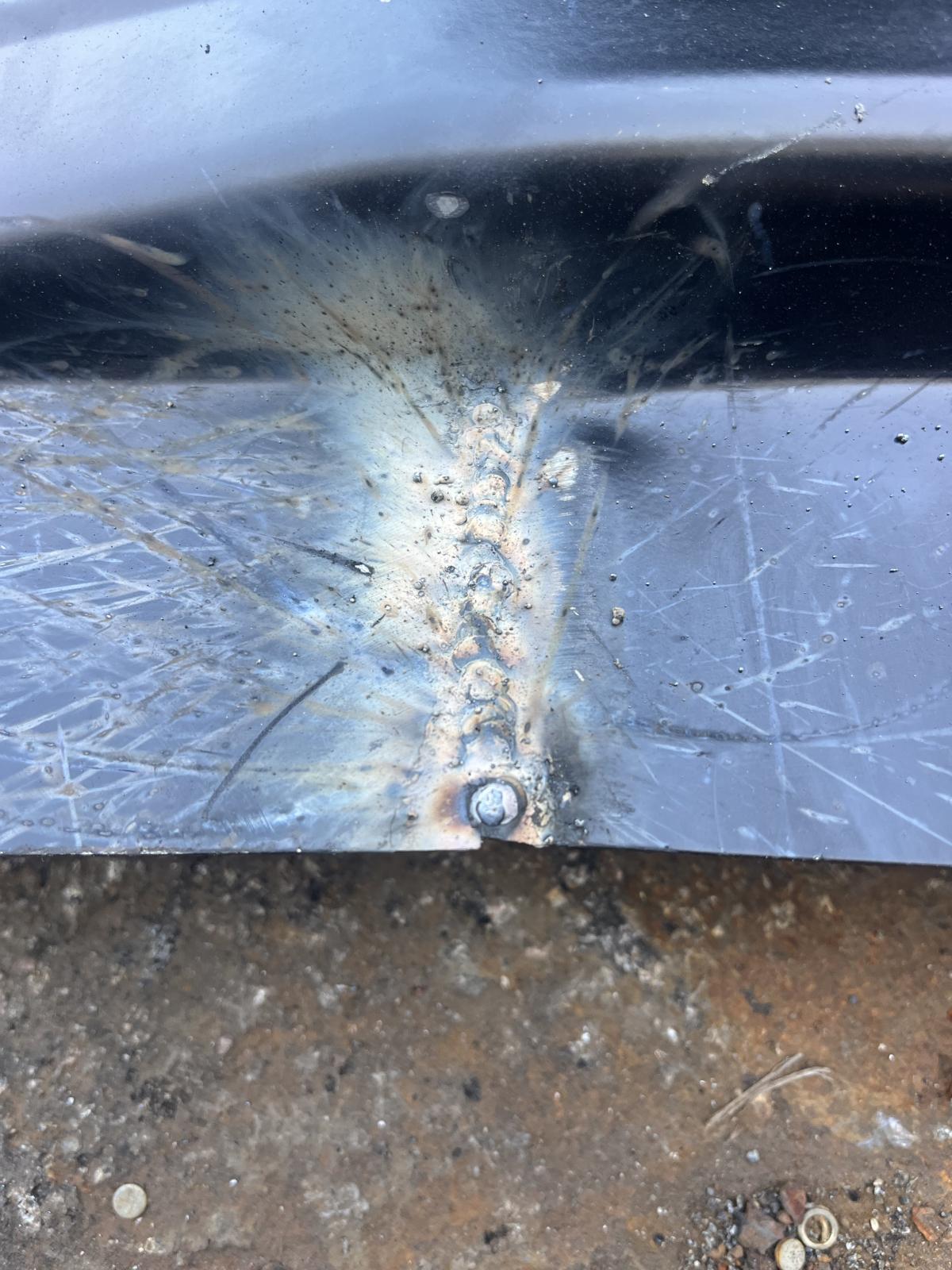

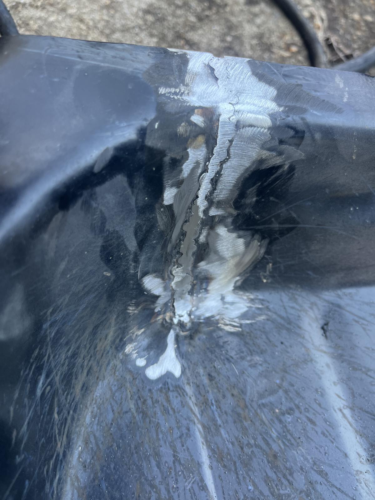

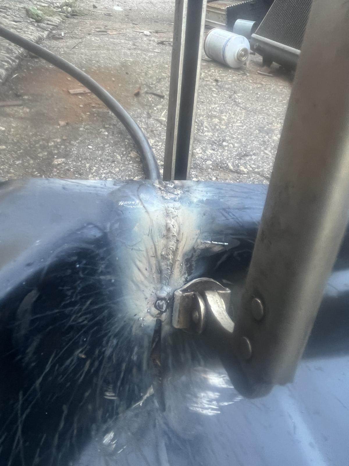

With a few moments to spare, last night I started stitching up the new driver side pan to get it ready to install.
And tonight I filled in another.

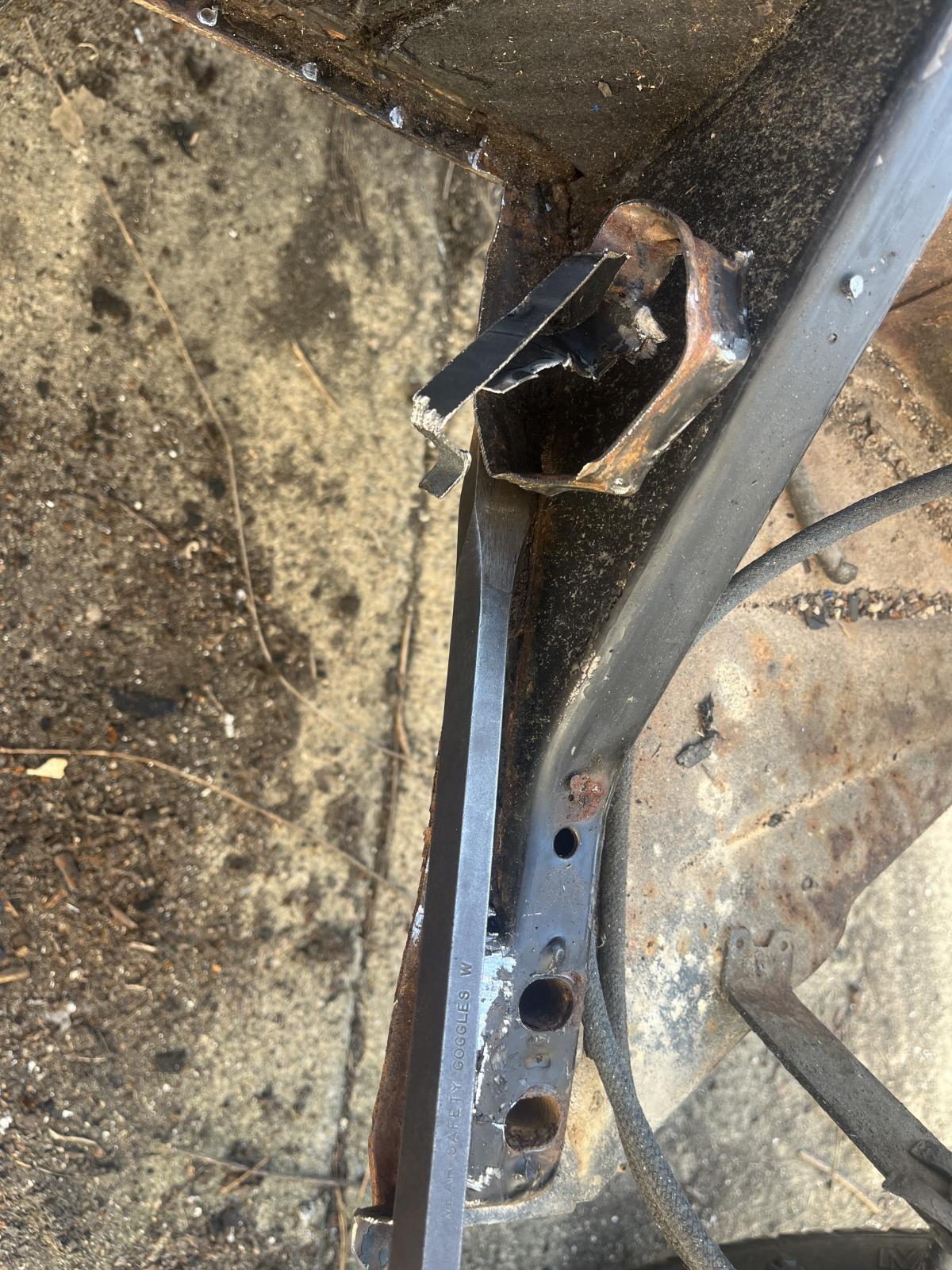

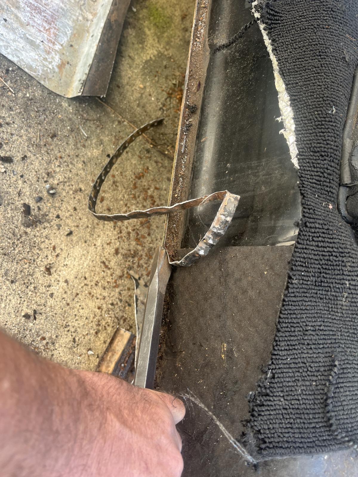

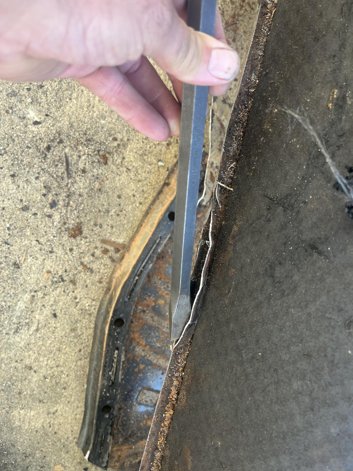

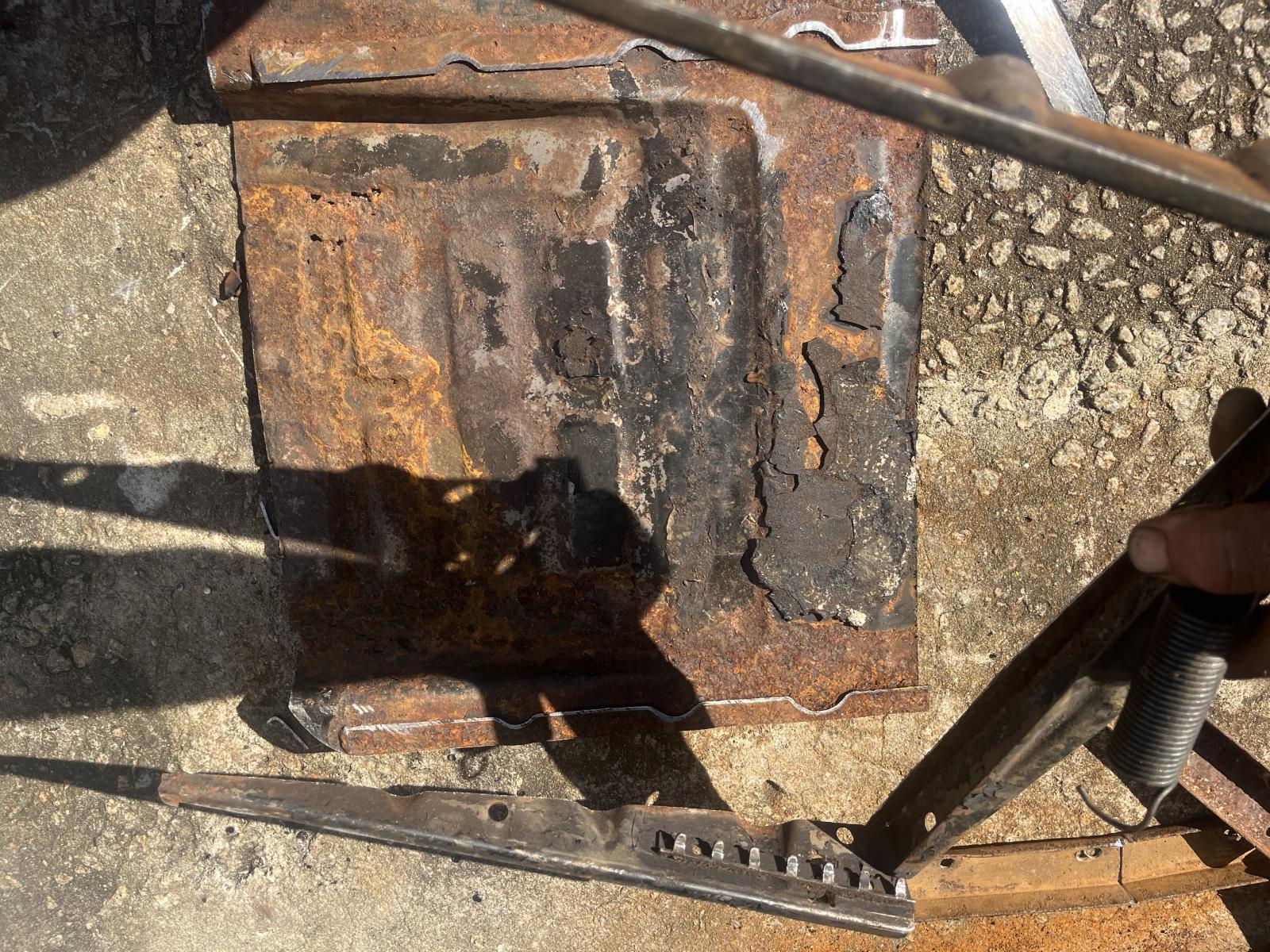

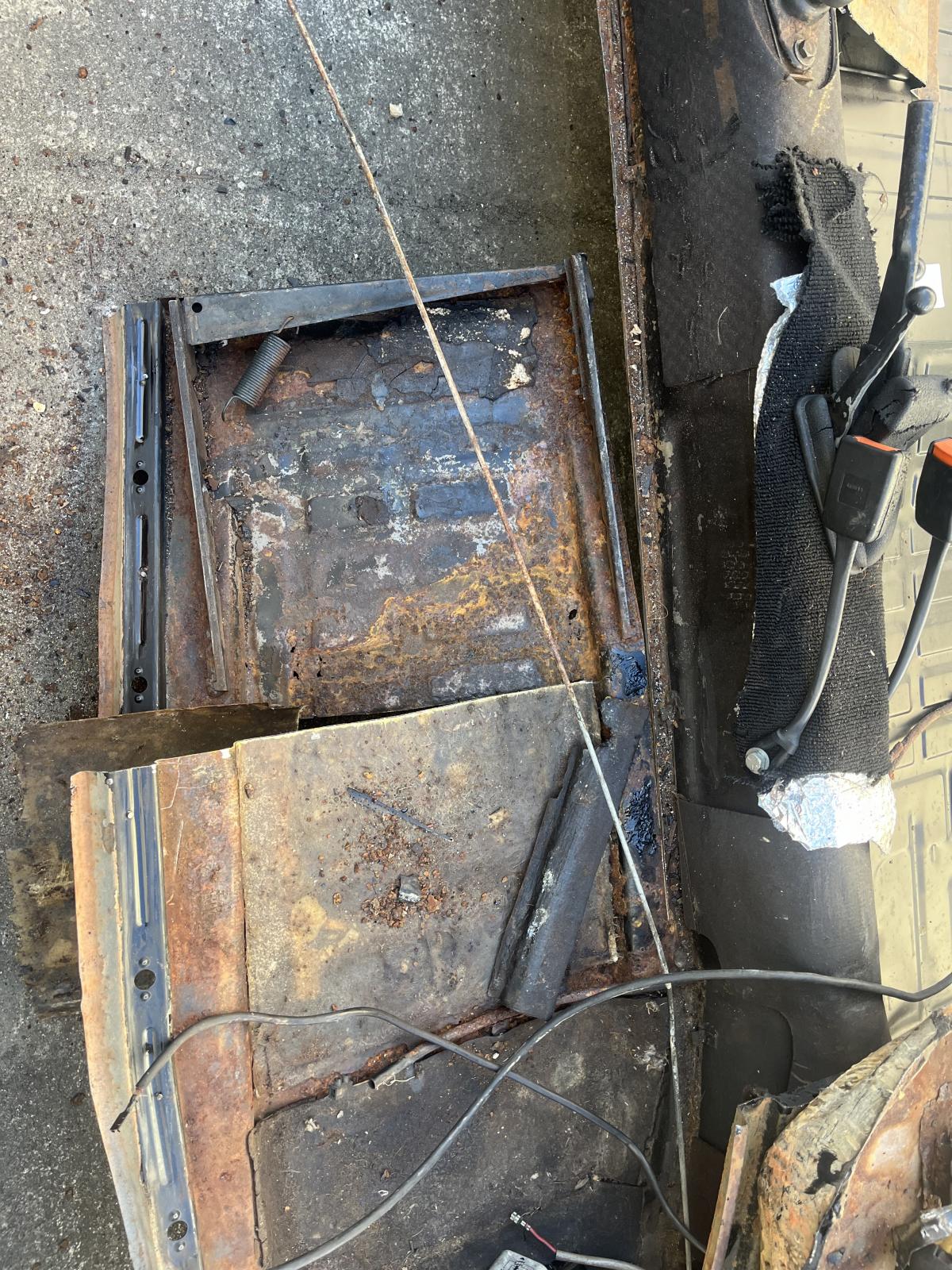

After carefully extracting the seat track, I hacked out the rest of the driver side floor pan.
Then, I used the BFH to bump the remaining strip up enough to get the chisel underneath it.
And continued making ribbons.

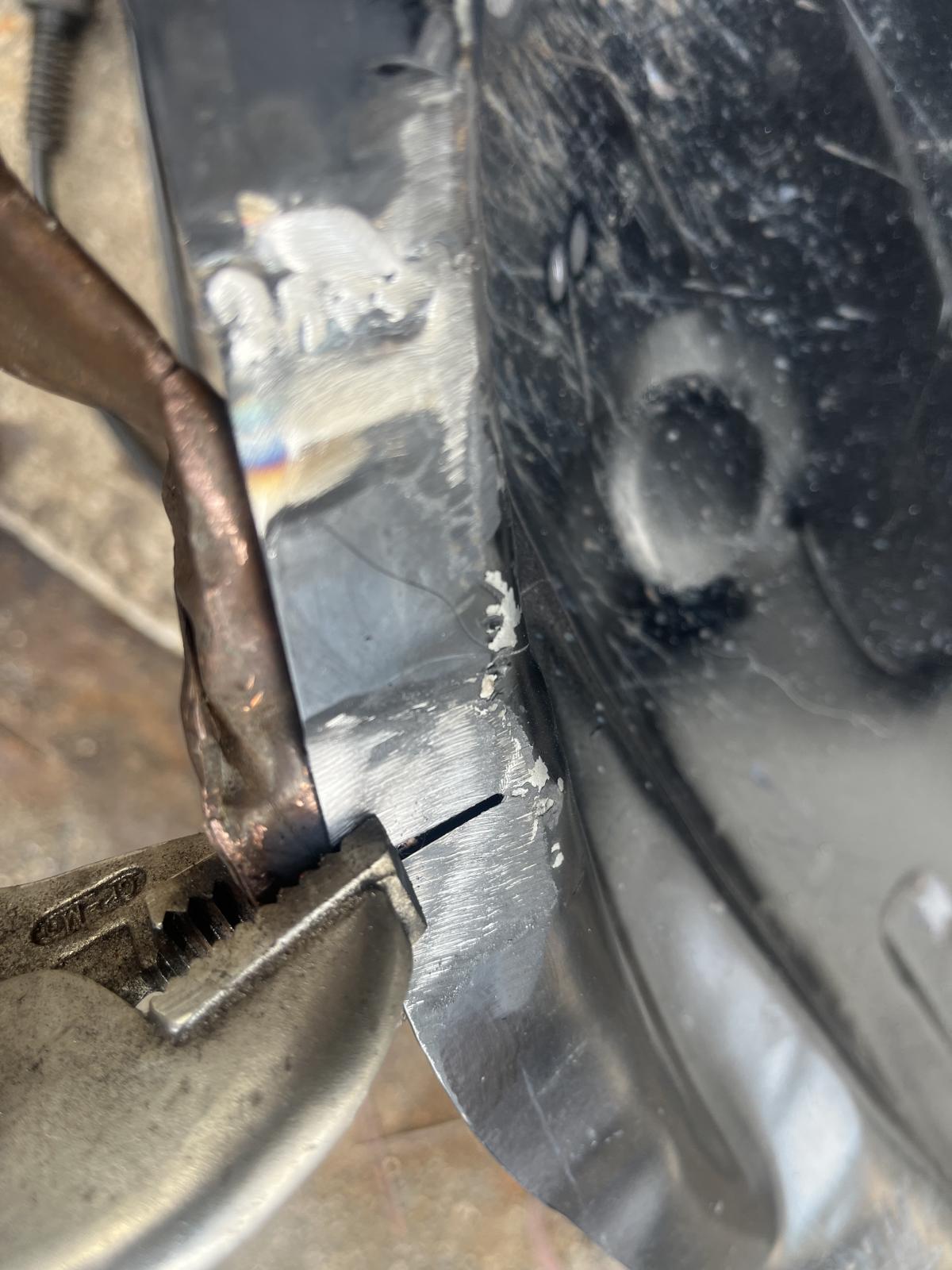

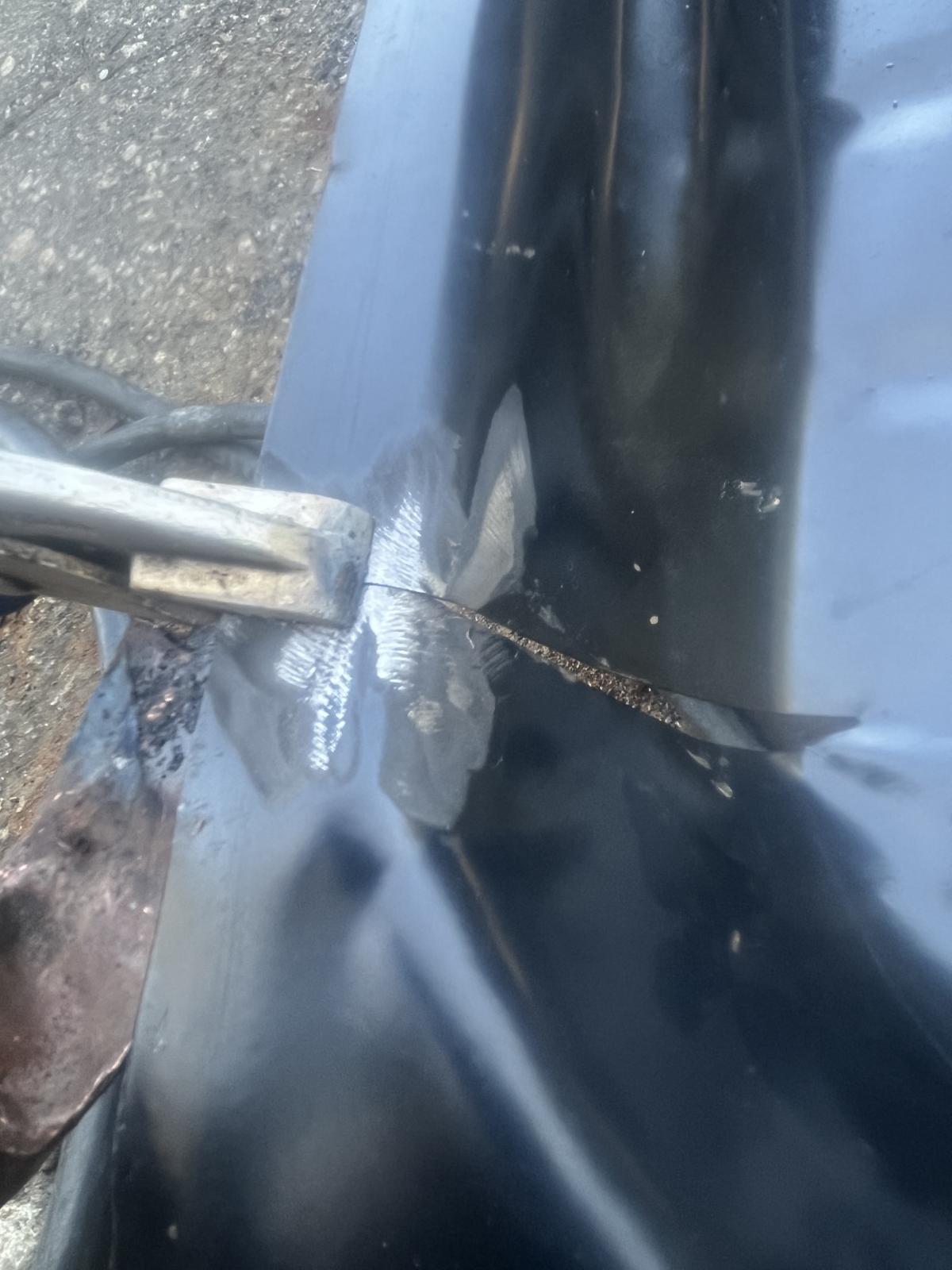

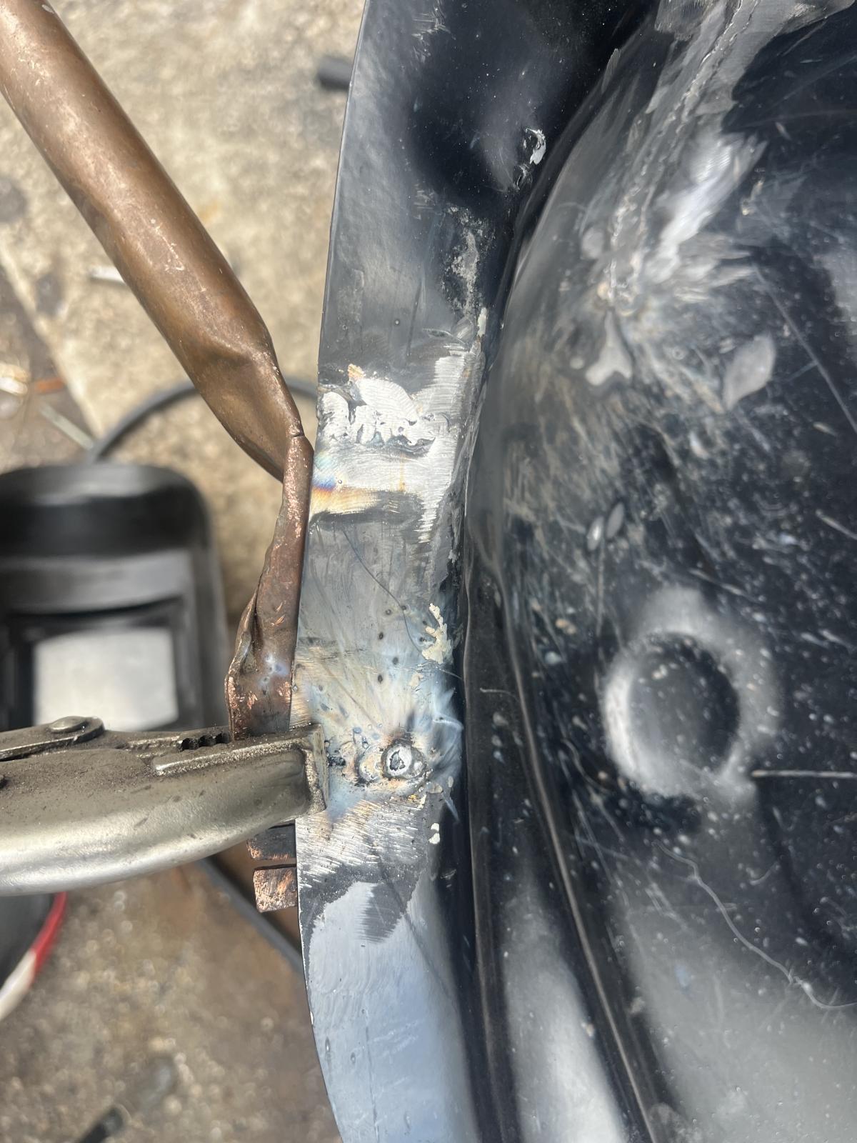

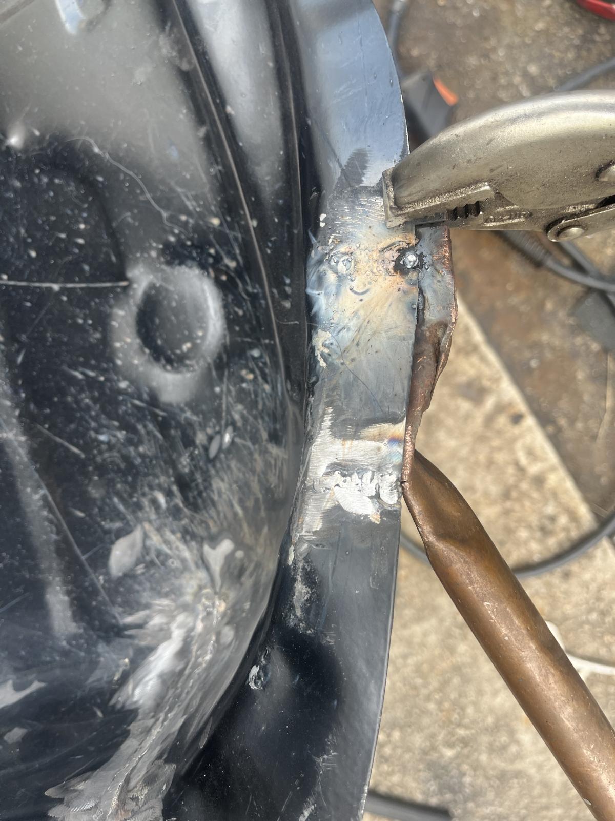

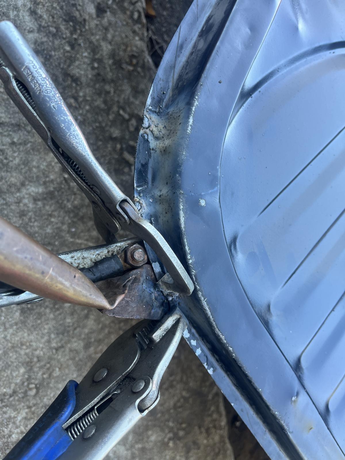

And now to finish filling in the relief cuts on the driver side pan.
Here I clamped a copper “spoon” (made out of a section of copper pipe.) against the back of the seam, the weld doesn’t stick to the copper & keeps the filler wire from blowing through the thin sheet metal.

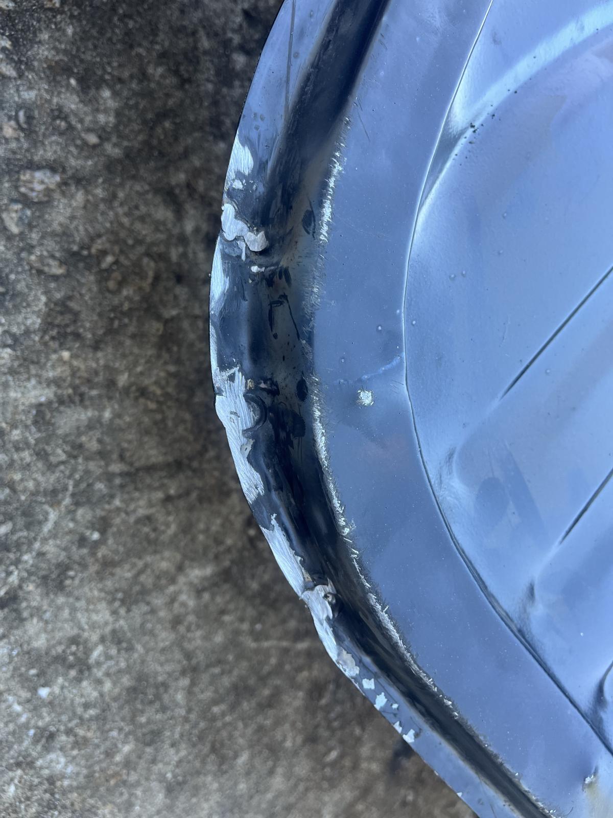

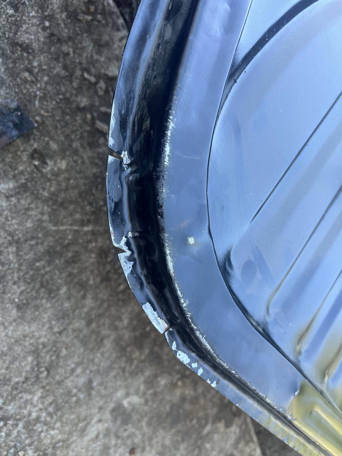

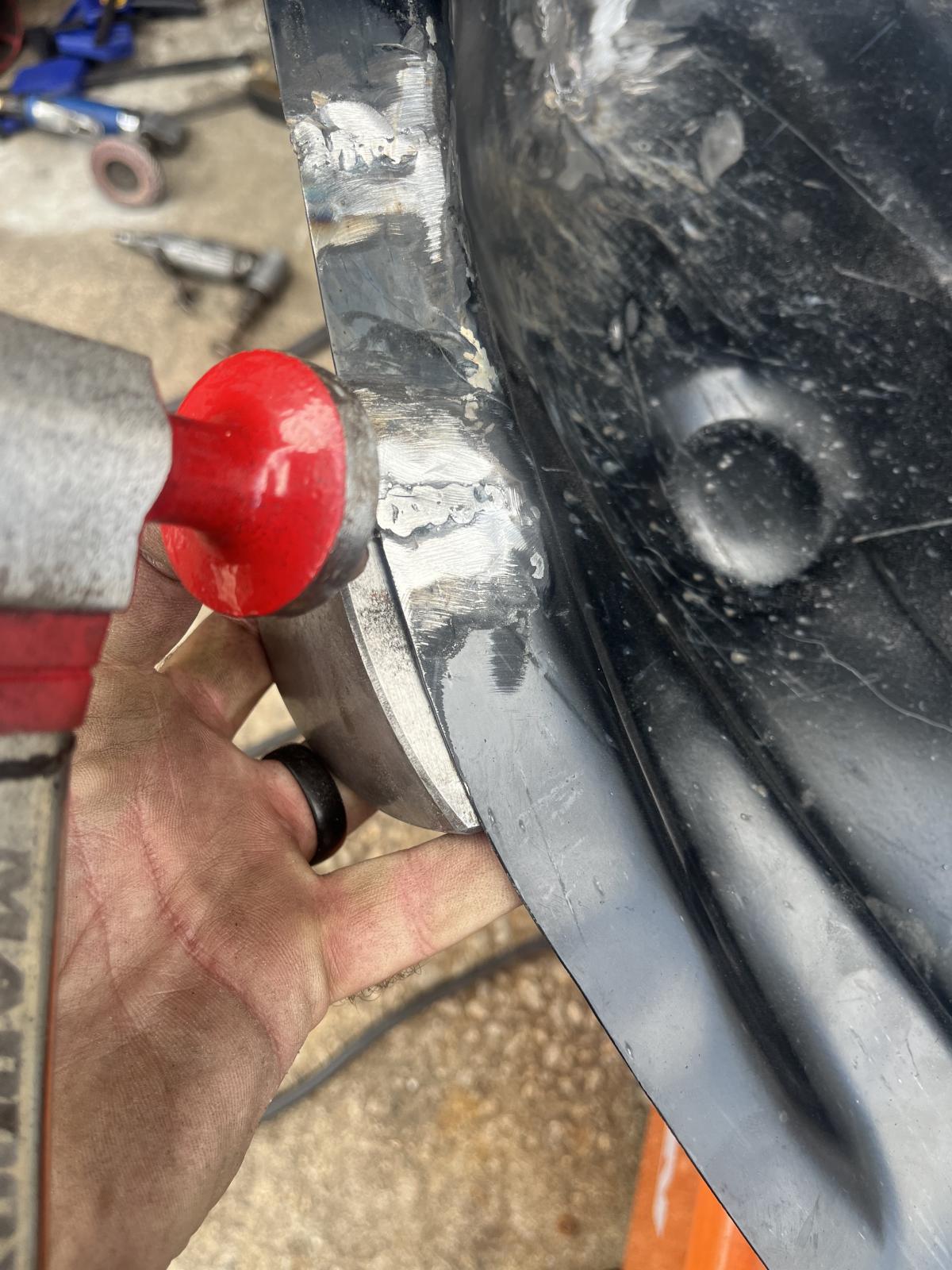

The outer lip of the pan was just as ugly.
So I messaged it with a hammer & dolly and filled in the relief cuts in it too.

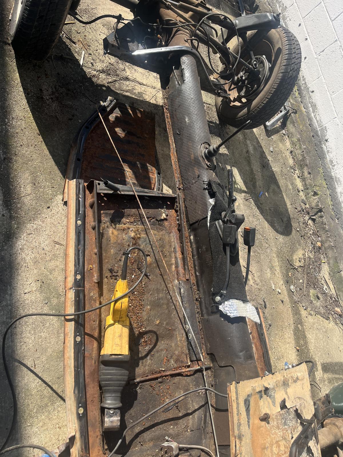

Nothing exciting, but I had to do something, so I mapped out where my welds would be & employed my pneumatic flanger/hole punch.

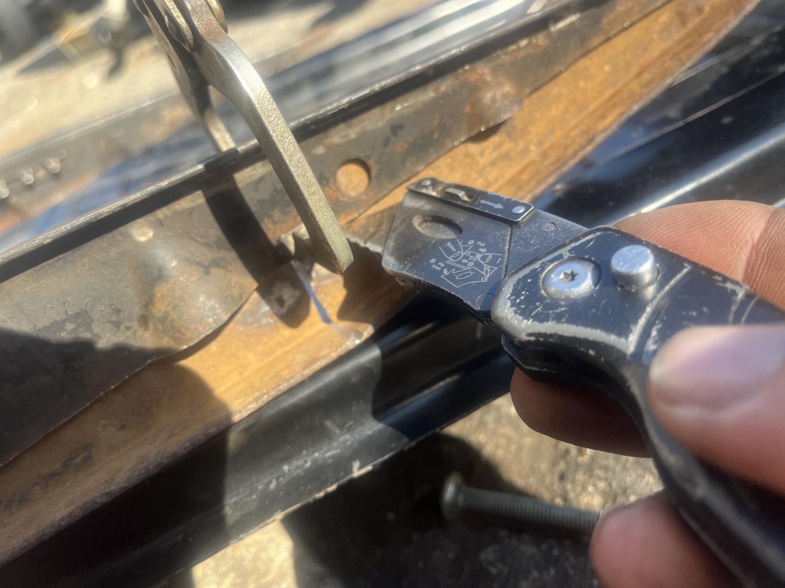

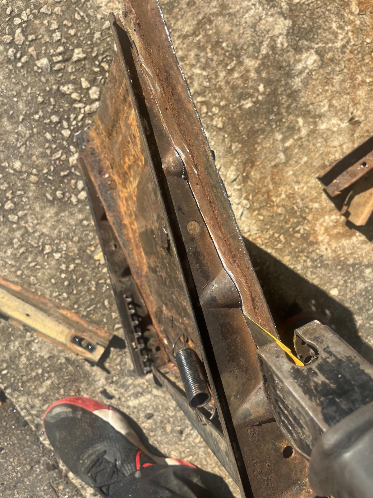

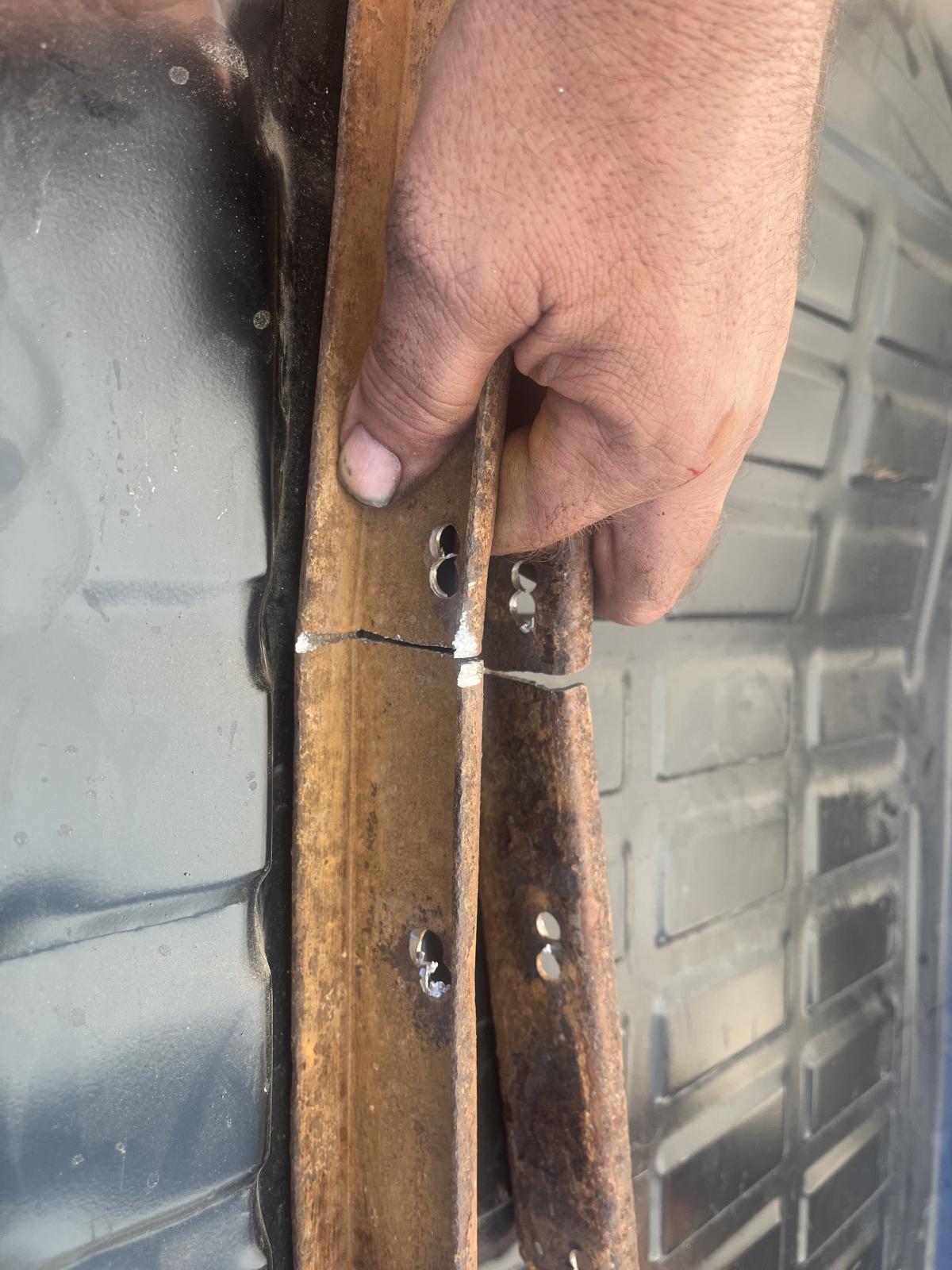

So…. How does one make beetle seat tracks fit a Thing/Ghia pan?
Well, after a bit of contemplation & even more redneck imagineering, I lopped the Beetle track off the old pan section…

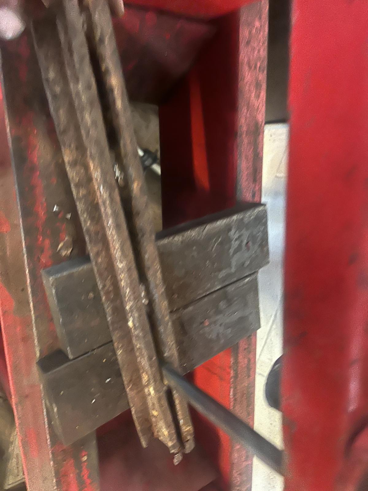

And after hunting around, I found some cross members that were extracted from a bus project.
And hacked off a section that I drilled out a few spot welds & then tossed into the press to force a chisel between the halves.
I then made a pie cut in the center of each half & bent it to fit the profile of the pan.
With a bit more trimming, I then clamped them to the Beetle seat track.

After bending the lower part of the track into shape, & positioning the Beetle track into place, I clamped them together & then scribed a line onto the lower piece.
Once I pared them down, I stitched them to the seat bracket (& forgot to take pics), and then I positioned the seat track in place on the pan half & scribed a line around the perimeter.
And then I began drilling holes into the pan.
