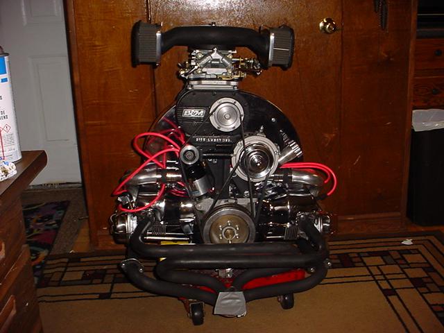

..................................................................................................................jim he said stock heads lol lolhay i just got my super charger to gether what a job. my self i would run the 28 vents. with 132 mains timeing set at 10 degs int. 32 degs total all in by 3,000 rpm they dont like a lot of fuel pressure
i ran 2lbs fuel pressure spencerfvee
