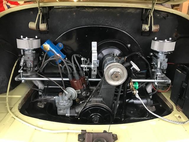

34/40hp carb kits are quite hard to find, Riechert were still making new kits but recently I am not sure of the availability. I have a Theo Decker dual carb kit on my 1200cc 34hp. It's made a real difference and i'm really glad I went through the effort of finding and fitting them. The point for me was it had to remain with 1200 heads Smile
Steve
1951 Type 1 11c - Chestnut Brown
1995 T3 - South African RHD Microbus / 2.6i
Rome
Joined: June 02, 2004
Posts: 10666
Location: Pearl River, NY
Rome is offline
PostPosted: Tue Jan 19, 2021 2:51 pm    Post subject: Re: Vintage Speed Carb Set Up Reply with quote
Nice work on the installation, SteveW. You even "aged" the kit a few years with that large, older generator pulley nut.

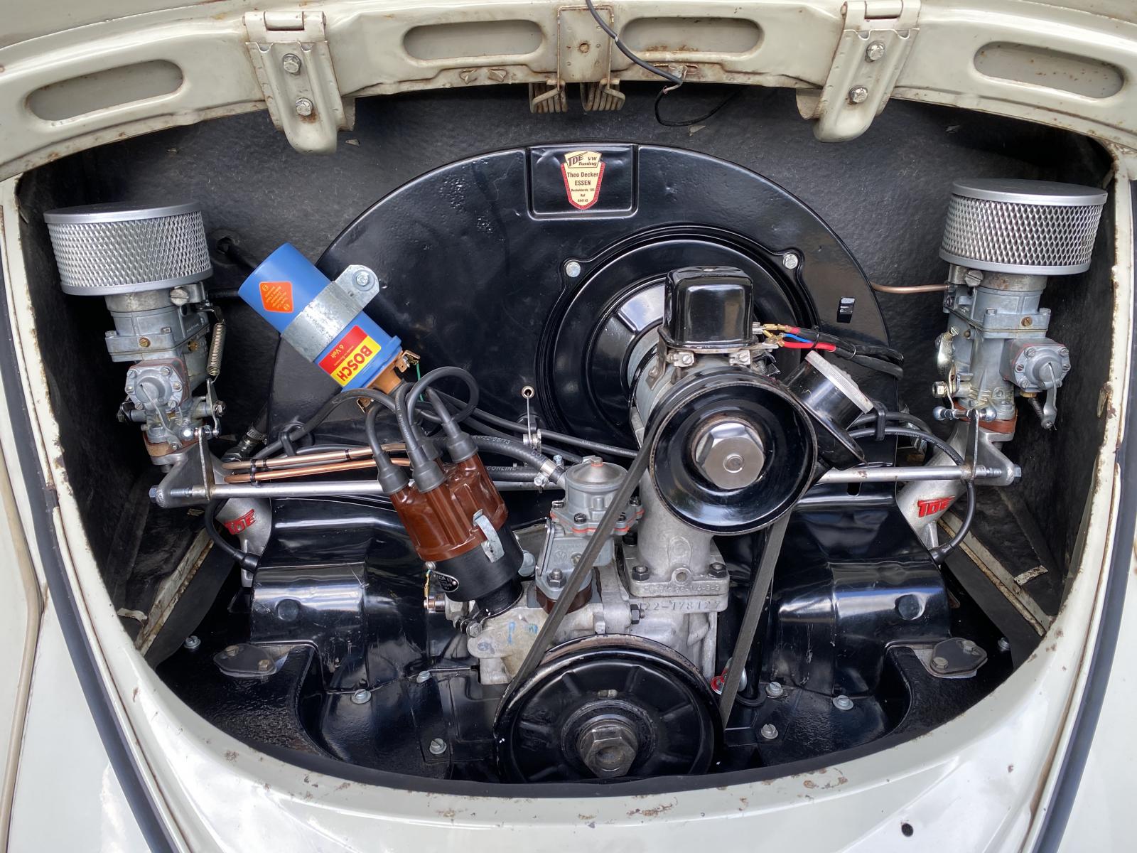

Tall Bloke
Joined: October 07, 2005
Posts: 250
Location: UK>Ohio>UK
Tall Bloke is offline
PostPosted: Wed May 05, 2021 6:00 am    Post subject: Re: Vintage Speed Carb Set Up Reply with quote
Scott - The Kit from Riechert arrived at the end of last year .
All of 30 horses !
