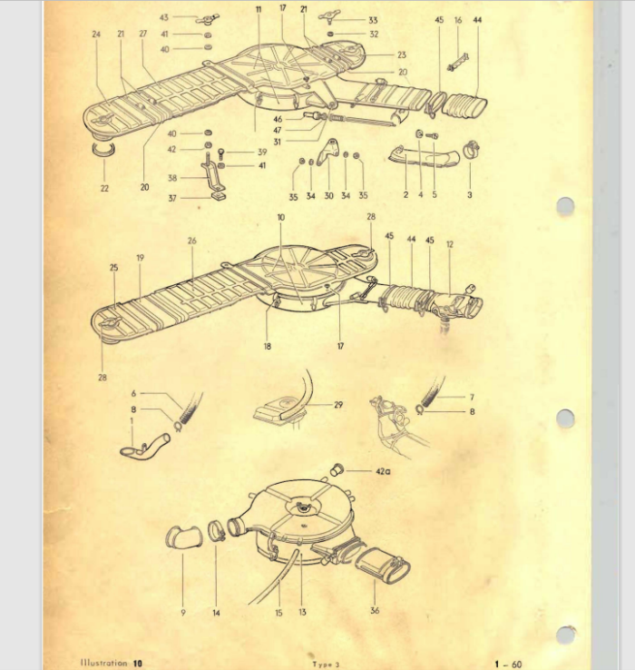

Smaller style carb pre heat tube, just under 1" diameter but with a double bend.
What is this from?

Possibly 1967 with the dual hot air tubes, right side.

Type 3.
#1 in the diagrams
