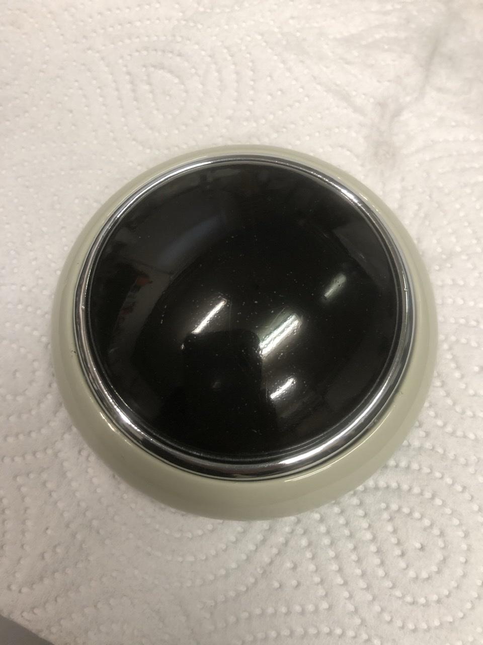

I was thinking of repainting my horn button. To do a good job and avoid harming the chrome ring, I‘d like to dissamble the parts before painting. I didn‘t find instructions how to do it. Do I need to drill out and replace a rivet or is it just bending the spring out or even another route? Thanks!

PostPosted: Sun May 02, 2021 6:29 am    Post subject: Re: Horn Button Reply with quote
The chrome ring has three tabs that you need to bend a little. Bend them as little as possible to push the whole thing apart so that they don't break when you bend them back after you put it all back together.

The original horn button center is VW's version of bakelite and it can be polished btw.

PostPosted: Mon Jun 07, 2021 11:22 pm    Post subject: Re: Horn Button Reply with quote
Thanks Lind and hitest for your tipps. I even found a short info in the Bentley manual, which I forgot about.
Disassembly worked well, but my bakelit center part was not polishable to a good degree. There were a lot of brownish particles in the plastic that stayed, so I decided to give it a light coat of paint.
Assembled back together with the polished center and chrome ring as well as the outer ring in new shiny silver white.

PostPosted: Wed Jun 09, 2021 6:17 am    Post subject: Re: Horn Button Reply with quote
Beautiful work Swiss Bulli !

PostPosted: Wed Jun 09, 2021 10:29 am    Post subject: Re: Horn Button Reply with quote
bakelite polishes up nice with Mothers Polish.
Horn button looks great!
