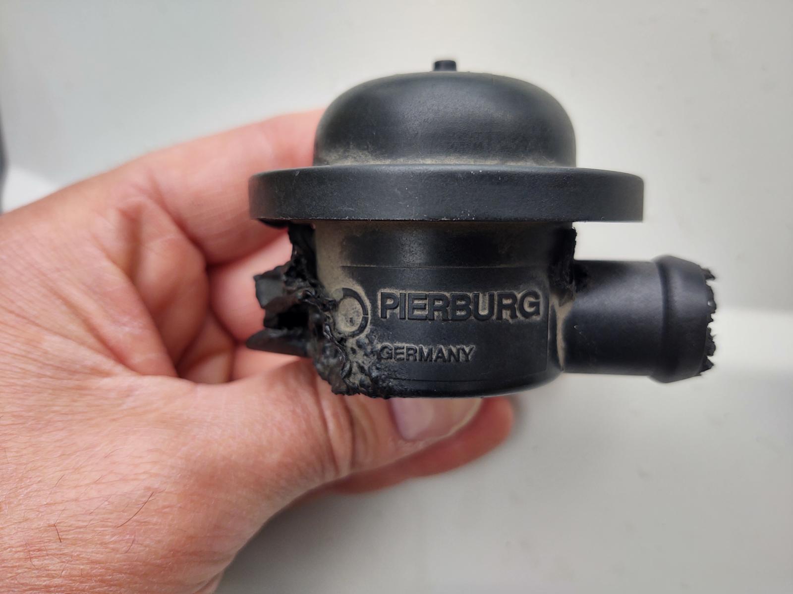

I just bought a '95 EVC and it's frigging sweet, I love it.
Drove it several hours home after buying, opened the hood and noticed the secondary air injection air check valve was all burned up.
So I'm searching now for one of these and have had zero luck. Does anybody out there have a parts vehicle or one of these laying around?
Thanks!!

That is the check valve for the secondary air injection system. The part number is 037 131 367. It is hard to come by, but search with part number and you may be able to find it.

If that part is melted then the combination valve is probably bad and stuck open letting exhaust blow through it. there's a good chance it also ruined the air pump too.

There's a NOS one on ebay in Latvia right now.
https://www.ebay.com/itm/202637378329?epid=9015280994&hash=item2f2e210319:g:wLwAAOSwa9dgjMWo
But as others have said, this didn't melt on its own, find the cause of this happening before you install a new one or it'll be ruined in short order.
Also, there are likely other similar parts that can be substituted. Other VWs from the same time period likely have a similar valve that can be made to work.

Pierburg W0133-1833370-APG is ALMOST the same as the combo valve that the Eurovan uses. The only difference is the clocking of the housing. It's readily available, and it's trivial to loosen the crimps and rotate the housing to match the Eurovan specific part, then re-crimp with a vice grips.

It will also do it if the solenoid that supplies vacuum to the two vacuum controlled valves fails. That solenoid will fail if the hot side valve (name?) diaphragm has a hole in it. Hot humid exhaust will cause corrosion in the solenoid.

Mine looks like that - I took one off my parts van .93 mv luckily the new one didn't get burned but if the new one is hooked up to the valven the engine stalls so I have it partially hooked up with a t fitting & it seems to be fine..Any thoughts anybody?? Bill VT & PR
