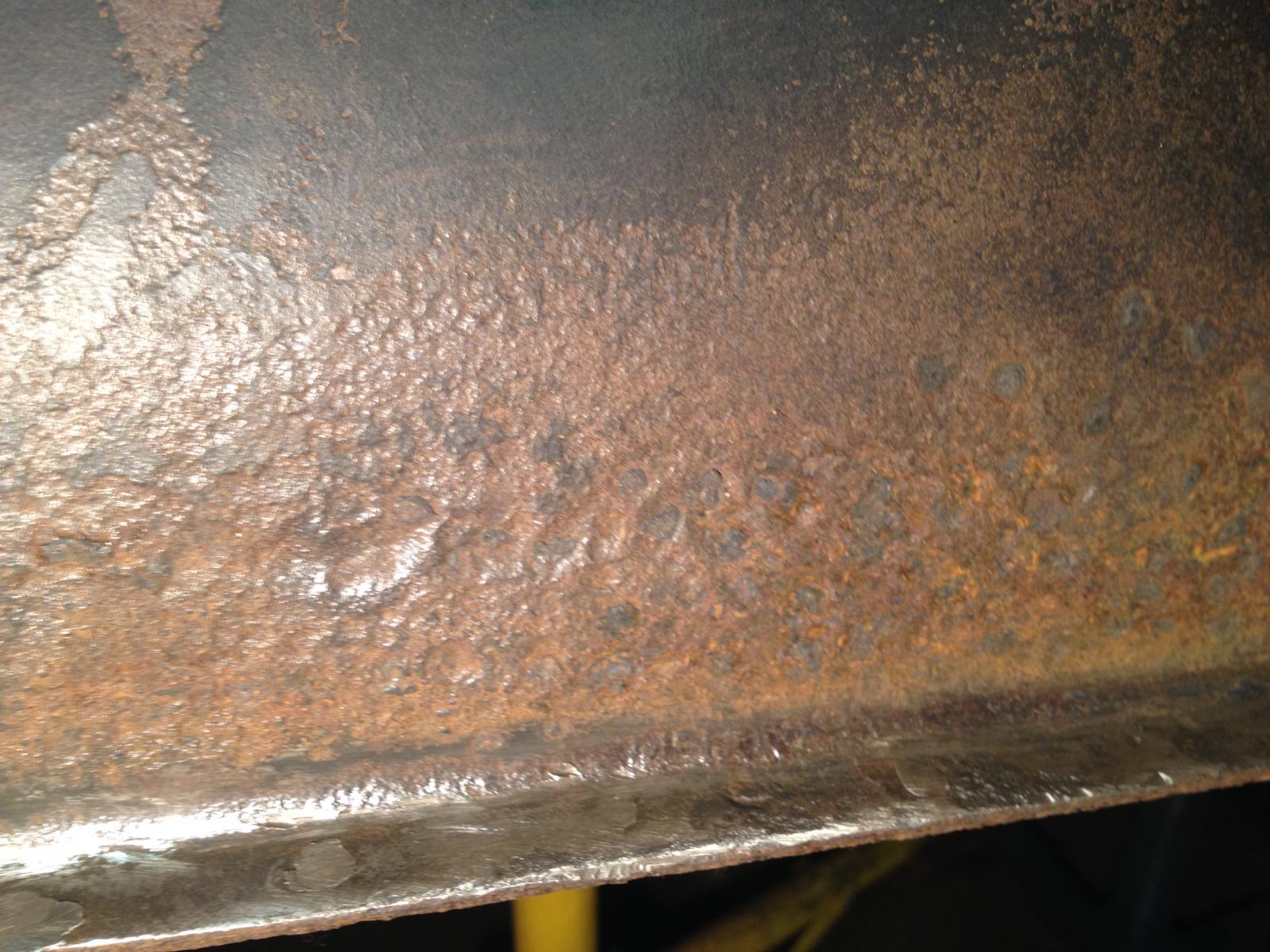

I have been slowly but surely chipping away at my ‘73 Thing. I have the body and chassis separated, and the front beam removed from the chassis. I am in the process of removing rust/cleaning in order to get it ready to paint (chassis that is). I had planned on using semi-gloss POR-15, but after reading some of the reviews here, it seems that maybe Master Series might be the better choice. Definitely want to use something I can brush on, and a primer that can be brushed or rattle canned. I was wondering first, how far down should I go as far as stripping the frame and beam? Do I want to go to bare metal? I’m assuming that would be overkill. I have been using wire wheels attached to a drill and angle grinder for doing the removal. Some of the spots have already been taken down to bare, as can kind of be seen in the photos. Since there are already some bare metal spots, do I need to use an etching primer on the entire chassis? Which brings up another question, the inside lip along the tunnel (where the floorpans are welded) should that be primered with a weld-thru primer and then coated after being welded and sealed? I am more or less completely new to any type of body work, and this car is my attempt at a learning experience. Here is some photos of where I have gotten so far. My lighting is terrible, so I apologize for the quality.
This is before I wire wheeled:
After cleaning for a few minutes:
The center tube is rock solid, but it does have a lot of pitting. This is underneath where the hockey stick would be attached. I am guessing there was water trapped in there. I know I can never get this perfect, but any advice on making this pitting less noticeable when I paint?

You yourself need to answer that question. What are using the car for? How long do you want to keep it for? Is it a daily driver or do you want a "show car" ? Are you flipping the car?
Whatever the answer is, the better the preparation, the longer the car will remain rust free.
In my case I took everything down to bare metal. For two reasons. Firstly you can see the extent of the problems e.g. rust hidden areas covered with bondo or seam sealer, and secondly the quality and longevity of the paint will depend on how clean and uniform the substrate is.
Regarding the pitting. I believe you can use the silver MS paint which has more pigment in it. This helps to "fill" the pits. Any holes however need to be repaired by removing all the rust and welding up to solid steel.
Re the floor pan to tunnel attachment. You need to get rid of any of the existing seam sealer and inspect the area. Looking at the extent of some of the rust on the rest of the car you should check this. You can try and treat the area with some sort of rust converter, then paint, then re-seam seal. There are lots of companies that make kits such as MS, POR15 that can be used on rusty steel.
POR15 gets a bad name usually because people do not follow the directions well enough. It is designed to work with rusty, not clean, steel. MS seems to be more resilient to poor preparation and clean steel.
Even using good old residential red metal primer and a top coat is better than doing nothing if your budget does not extend to the MS.
Here's a picture of my front end which was hand-painted using a product similar to MS here in Australia called KBS.

Thanks for the response. To add a little more info., I am not going for a ‘show car’ by any means, but I would like to make sure that the car is properly rust-proofed. I am not worried as much about how everything looks since the majority of it will be underneath, but I obviously would like to do the best job I am capable of. Don’t want to go through all this work to realize if I spent another hundred dollars and a few more hours work I could have had better results. I think what I am trying to figure out is, being that some spots of the chassis have been stripped to bare metal but most are not, what do I have to do to properly prep/prime/paint? My other question concerning the floor to tunnel attachment is this: I have the lip down the sides of the tunnel cleaned and ground down to shiny metal in order to make a good welding surface. I assume I need to prime and or paint this section (along with the corresponding sections of the floor) before welding. What is the proper technique for this? Do I just spray it with rattle can weld-through primer and then paint it after it has been welded? Sorry to make this more confusing that it has to be, but sometimes it’s hard to explain in a post.

I am not an experienced painter or body man but have done a fair amount of research on this subject. I am sharing what I have learned in the hope that it is of some value to you. Others here may have better information to offer.
1a) If you have the time and budget to take it all down to bare metal, do so. As stated earlier you eliminate the unknown by doing so. Sandblasting is best but DA or hand sanding with 80 grit will work as well. The wire wheel leaves the surface too smooth for propper paint adhesion.
1b) if you do not take it ALL down to bare metal, either spot sandblast the bare metal or hand/DA sand it with 80 grit sandpaper to give the metal a tooth for the paint to bind to. Sand the painted areas with 150 - 220 grit sandpaper or scuff with a maroon Scotch-Brite pad (Medium - Part #: 07447) or a tan Scotch-Brite pad (Coarse - Part #: 07440) to provide tooth.
2a) If the project will remain unpainted for an extended period of time
- Blow off any sand or grit with compressed air or a leaf blower.
- Wipe the entire surface clean with acetone several times to remove residue and contaminants.
- Treat the metal with a phosphoric acid product. Apply the acid and keep the area wet for 10 Minutes. Thoroughly rinse the still wet acid with plenty of water to neutralize it.
- Move to step 2b when ready to paint
2b) If you plan to paint/coat the project soon after stripping (skip the acid)
- Wipe the entire surface with solvent-based wax and grease remover. Follow the direction on the product's Technical Data Sheet (TDS) to the letter.
- Wipe the entire surface with water-based wax and grease remover. Follow the direction on the product's TDS to the letter.
- wipe the surface with a clean tack rag.
- Apply two coats of Master Series silver. Follow the TDS instructions to the letter.
- Apply 1 or 2 coats of the MS Chassis black or AG-111 in clear or color as a topcoat.
- The cleaner the environment and the surface are the better the end result will be. Avoid rushing or cutting corners If you have the time and budget to do so.
- southernpolyurethane.com makes good, affordable products. Get the wax and grease removers from them. Look at their other products a well.
- Invest in a half or full-face respirator. You will need it for blasting and painting.
- invest in a pressure pot sandblaster. It will make blasting the chassis and hard-to-reach areas of the body a lot easier.
- Use crushed glass or coal slag as blasting media.
- For "Driveway/Back yard" blasting, build an enclosure out of PVC pipe and plastic sheeting (about $200) to contain and recover the blasting media. Collect, sift and reuse the media if money is tight or you just don't like waste. The enclosure can also be used as a driveway paint booth.

Evil_Fiz's explanation is a very good one.
But for me that is for a perfect external body paint job.
I would just look up Master Series/POR15 paint and look at their steps.
It is essentially a degreaser step, a rust converter step and a paint step.
For me, for the chassis and suspension, and with not wanting or affording to spend a lot of money on it I would do the following.
1. Scrape down the surface to get the bulk of the grease off. Degrease with auto degreaser. Repeat until clean.
2. Wipe down with a solvent. Even gasoline (when used safely) is better than nothing and relatively cheap. Do it outside and away from any ignition sources. Alternatively use, mineral spirits, white spirits, brake cleaner or xylene. This step is to get rid of traces of oils and greases.
3. Sand painted surfaces to give the paint a key
4. Treat rusty areas with a rust converter/Ospho. Follow the directions. Some do NOT need further treatment as they contain a polymer that seals the surface and prevents flash rust. Others like Ospho needs to be well neutralised with water (or an alkaline solution like bicarb) before painting Spot prime treated areas.
5. Spot prime bare metal surfaces. Allow to dry well.
6. Wipe down with solvent again. Wax and grease remover is usually a solvent like acetone or xylene.
7. Paint areas that are NOT accessible AFTER welding with weld through primer. If they ARE accessible AFTER welding, then just use normal primer.
8. Follow the directions for MS top coat.
In my case for the floor to tunnel area after welding, I was able to use a makeshift rotisserie from two engine stands so I could rotate the chassis. I was able to flood that area with paint with a little bit of viscosity reducer. Penetrol is something we have in Australia that you add to paint and it allows it to wick into gaps better than paint alone. I did one side in the vertical and left it for a day, then rotated and did the other. You'll have paint runs that you have to capture but you know it has got all the way through. If you have an area with too much leakage just plug the area with Play-Doh or plasticine or something that will slow it down, then treat those bits after the paint has dried sufficiently (i.e. take out the plasticine). Once all dry, seam seal.
Even if you do nothing more than convert rusty areas and paint with a good home steel anti-rust product you will have a good protection from most environments except salty roads.
I also tend to try and use stuff available at the big hardware stores rather than the specialist auto paint suppliers due to cost. Prior to retirement I used to assess MSDS as part of my job. Thousands of them. It is amazing to look up the MSDS for a lot of these special "wonder products" and find that they are nothing more than easily obtained residential products with a huge mark-up in price. The active ingredients are nearly always (other than proprietary secret ingredients) listed. It will either give you the actual name on the MSDS or a thing called a CAS (Chemical Abstract Services) number. Google that and you find out what is in it.
As an example I checked the first relevant MSDS for Brake Cleaner I found on the internet. Not sure if this is a brand you use or even available in the US.
http://docs.crcindustries.com/msds/5151.pdf
If you go to Section 3 " Composition/ information on ingredients" you see the composition as:
1. Acetone - 80-90%
2. CO2 - 10-20%
3. Toluene 1-3%
Acetone is the main ingredient. CO2 is the propellant (this being a spray can no doubt) and toluene in small quantities is just another solvent. So other than the convenience of using a spray can why would you not just buy acetone and put in a spray bottle to do the same work.
Now some people will say that all these extra goodies impart some other special attributes to do the job. Usually - no! In some cases there is and it relies on chemists to realise the reasons for this. In most cases is that someone can buy a certain chemical that just happens to have some other chemical mixed up with it at a much reduced supply price. Hence the company just formulates with that mixture and then has to declare it by law on the MSDS. The other reason that other things are added is to differentiate the product from their competitors. You don't want to copy someone else's formula exactly for fear of legal issues and if you add enough special woofle dust to the product you can bamboozle the mug out in the public who buys it.
Just go to a fuel distribution depot and watch the tankers arrive with all different company branding on them to fill up from the same storage tank. Is the fuel really that different?
Sorry for the rant and lecture.

Wire brush vacuum degrease rust converter silver master series. If you want gloss put black master series on the silver.

Man, thanks for all the great information everyone. Is rust converter needed if everything is stripped bare? These are the things I’m unsure of. I was looking on Harbor Freight’s website and they have some blasters in the $150-$200 range. I may pick one of them up. Viiking mentioned using engine stands, I actually just rigged that up. I have the trans. mount bracket bolts attached to a piece of angle iron and bolted the engine stand yoke to that. The front end I’m just using a saw horse. I doesn’t give me infinite positions, but it will make doing the underside much easier to work on. I’ll be so glad when I’m done with this, I figure this is the least fun part of the entire restoration process. Thanks again.

Yes, you need rust converter on all the metal.
I don't wipe/wash it off & put the masterseries silver directly on top of the rust converter.
I've had better luck with the cheap siphon sand blasters that the pressure sand blasters.
Put down a big tarp & screen/reuse your sand.

Recommendations for a rust converter? Googling it gives a million options.

My bottle is Rust-Prep but they all are real similar I think.

Two questions:
- Why is rust converter needed if all rust is removed?
- And, what problems did you have with pressurized sand blasters? I have the opposite experience...the problem I had with the siphon type is that the siphoning action draws the sand immediately around the inlet fitting inside the hopper, then creates an air cavity around it and it stops blasting sand in short orderand just sucked air I had to stop and kick the hopper about every 5 to 10 seconds to agitate the sand and get it to settle back around the inlet so the POS could suck more sand. I eventually got so sick of it that I just about kicked it over the fence to the neighbor's yard. I should mention, now, that this was a Craftsman unit about 30 years ago (this was using dry, filtered blasting sand).
Busstom
Joined: November 23, 2014
Posts: 4579
Location: San Jose, CA
Busstom is offline
PostPosted: Fri Jun 04, 2021 6:16 pm    Post subject: Re: Stripping my Chassis and Front Beam - How Far do I Go? Reply with quote
OP, if you blast the parts yourself, I highly recommend that you invest in crushed glass bottles media. While more expensive, it's significantly safer than actual sand...do a web search for silicosis and to learn what happens when sand particles are propelled at hard surfaces at high velocity. Better yet, probably for a few hundred bucks, you can pay a local blasting servicer to do the work for you, you stay clean and safe while enjoying your time on something else.
Evil_Fiz
Joined: May 06, 2011
Posts: 1111
Location: Jacksonville, FL
Evil_Fiz is offline
PostPosted: Mon Jun 07, 2021 5:44 am    Post subject: Re: Stripping my Chassis and Front Beam - How Far do I Go? Reply with quote
I initially used Eastwood After Blast but need to reapply the acid and rinse it off to properly neutralize it. On the second pass, I will be using "Kleen-strip Concrete Etch & Metal Prep + Rust Inhibitor" based on the recommendation of Samba member C21darrel who has used it in the past in conjunction with MasterSeries silver. You can get the Kleen-Strip at home Depot: https://www.homedepot.com/p/Klean-Strip-1-Gal-Conc.../100406369
