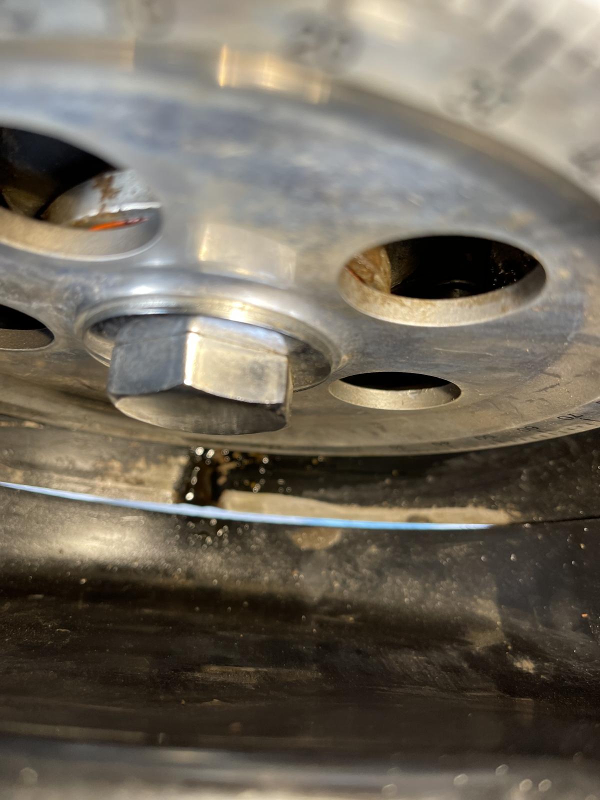

Sorry for the horrible photo but is that orange piece a sand seal? If yes can I remove it and use an OEM pulley?

Yes it is
Some are machined in others are slip in. Pray for slip in. Only way to find out is remove the pulley and measure where the seal rides. Slip in will have a much smaller diameter. Machined in snout will be close to stock diameter.

The next big question is why is it there?, was the engine puking oil from the pulley?, or is it just the natural progression of adding shiny things?, like a useless bling breather that caused oil to come from the pulley?

No idea! It actually just started puking oil and it looks to be from the pully area.

It looks like that motor is set up with a sand seal of some type.
Typically you cut the case to install those, so if it’s leaking you’ll want to replace it with a seal of the same size.
You could probably have a stock pulley machined to work with that seal if you want to have it look more stock.

That is indeed a “slip in” sand seal and you can remove it and install a stock pulley. However, if it is “puking oilwith the seal already in there, it will make a serious mess without it! Shocked
If it was me, I’d rebuild it AND machine it for the proper sand seal. Cool

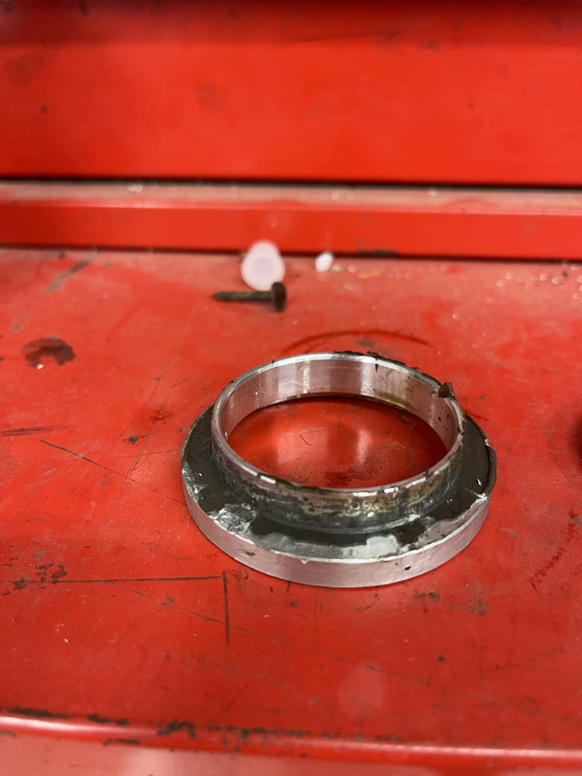

pulled off the pulley. This isnt machined in right? Just slip on seal?

I don't have X-ray vision, it looks like one of those press in no machining ones, but until it's out nobody can be sure.
When it is out remove the spacer washer that goes on the crank before fitting the stock pulley.

looks press in....

That aluminum collar has to come out too, it's the "press in" part that holds the seal. Careful prying under the outside edge should do it, unless you can grab it with a 3 jaw puller, put the bolt back in the crank if you use a puller so you don't F up the threads.

Came out fairly easily.

There is usually a spacer in there too when using a sand seal pulley so it does not hit the seal. You need to punch out the woodruff key then get out the spacer if going to a stock pulley with the grooves.

I have a slip in in my garage. I just threw a caliper on the end that goes into the case it’s1.980 and the pulley measures 1.845
