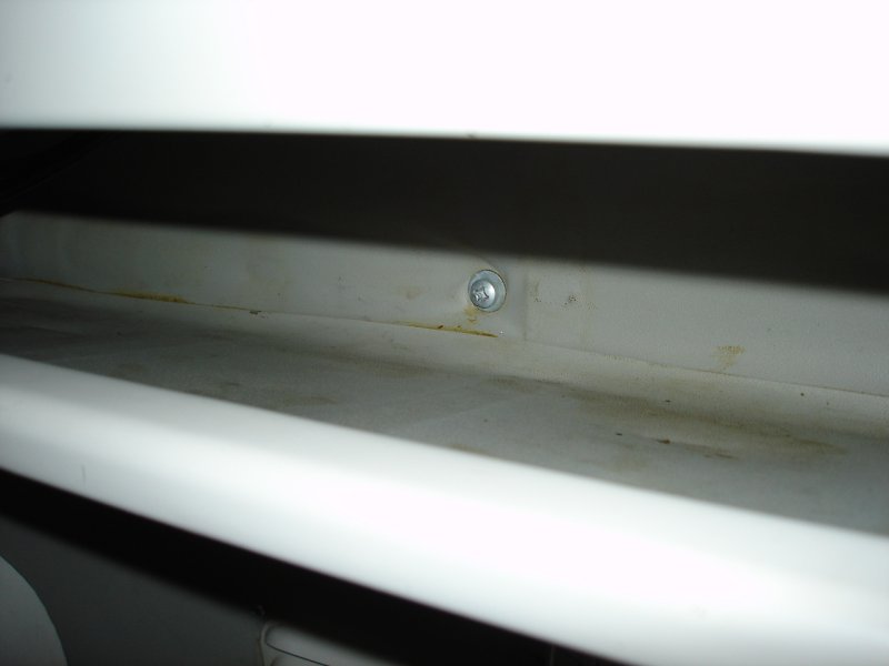

PostPosted: Tue Oct 11, 2005 6:52 pm    Post subject: Reply with quote
original dash vinyl in my 67 standard

PostPosted: Wed Oct 12, 2005 10:19 am    Post subject: Reply with quote
Clara, thank for the photo. I can't seem to recall ever seeing the material there before on any bus I've looked at. I guess I just never paid that much attention to details.
So it looks like it isn't glued snugly around the ribs of the shelf?

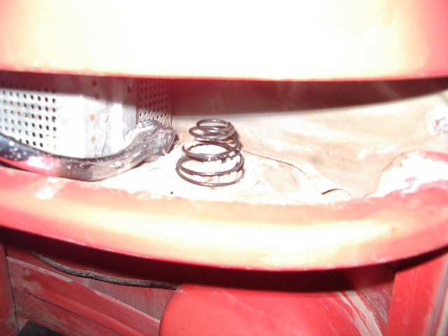

PostPosted: Wed Oct 12, 2005 6:37 pm    Post subject: Reply with quote
Jerry
it is not glued snugly around the ribs(at least not on mine).
As a matter of fact, it is quite sloppy; not the usual attention to detail we have come to expect from the old Germans.

PostPosted: Thu Oct 13, 2005 8:26 am    Post subject: Reply with quote
Riff Raff, thanks for the photo.
The remenants of the glue, on mine, is kinda smeared, haphazardly all over the shelf. The only way I've been able to remove the dried up glue has been with car wax.
