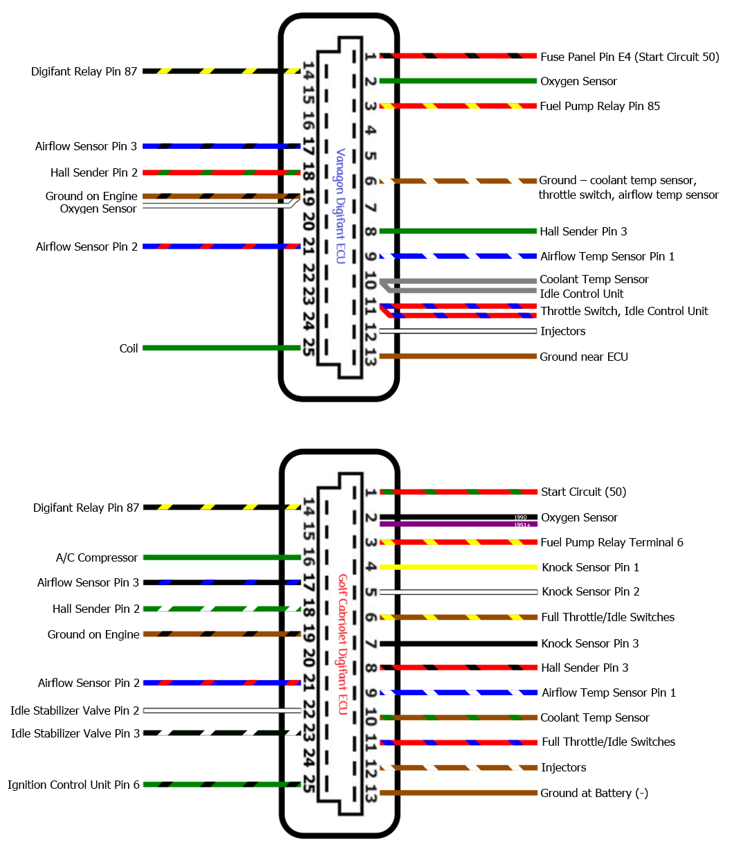

I was curious why the Vanagon Digifant system is so much more, hmm, ridiculous than the other models' Digifant II system. Already had the Cabriolet ECU pinouts, so added the Vanagon next to it to see the differences.
(As for the Digi I vs. Digi II differences, click here. Edit 2: For the inline-4 engines.)

So, the knock sensor is the major hurdle in using a Golf ECU. But a couple questions remain:
1) Why did VW use a stand-alone idle control unit instead of integrating it like in the Golfs?
2) Why did VW not incorporate an ignition control module (part #191905351B) into the Vanagon system (I ask this one due to some ignition coil-ECU problem discussions)?
~Kamz Anxious

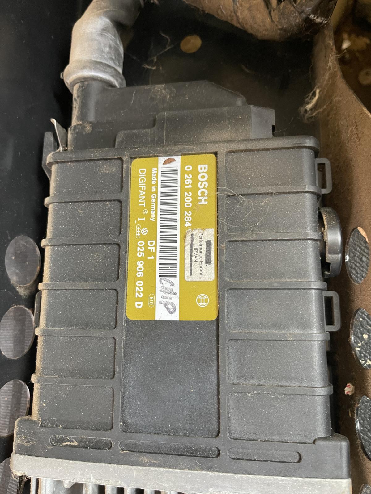

Coincidentally? this photo appeared here just now as well, showing a Digifant-I (DF1) label on an 88-91 Vanagon ECU.
this is just a guess, and likely giving VW too much credit... but off loading the ignition control module to an external assembly COULD have been a move to reduce failures of the coil driver inside the Vanagon ECU. but since these were in concurrent production, it doesn't seem like a good scenario.
maybe they physically ran out of room inside the ECU with knock control and had to put the module outside. maybe it was a different design team for the Golf series that thought the Digifant (not I or II) ECU design was stupid.
I've seen a VW factory manual (the Pro-training?) referring to Digifant I as well, and not the Digi I from the '90s for California cars. Weird and confusing, but that's VW for you. Razz
Since the recent discussions have pertained to coil failures in Vanagons, it got me wondering... These coil failures aren't as prevalent in the inline-4 cars, AFAIK, thus the speculation about whether the ignition control module would play a role. The ICM input on the ECU is at the same pin as the Vanagon's coil input.
Just spitballing (no intention to actually do it): Would there be any issue in adding an ICM to a Digifant Vanagon? The component has 7 pins, but in the Cabriolet's case, only 4 are utilized: Coil, ground, + voltage, ECU. So, pretty simplistic.
Good point!

The Digifant II Cabriolets (and I'm sure the other Golfs/Jettas too) had California-market ECUs as well for 1990, before switching over to California Digi I.
I know a flat-four is quite different from an inline-4, but I would've thought the fuel injection control system wouldn't have been so different. One has a separate ignition control with built-in idle control; the other has a separate idle control with built-in ignition and 9 unused ECU pins (36% of the total).
