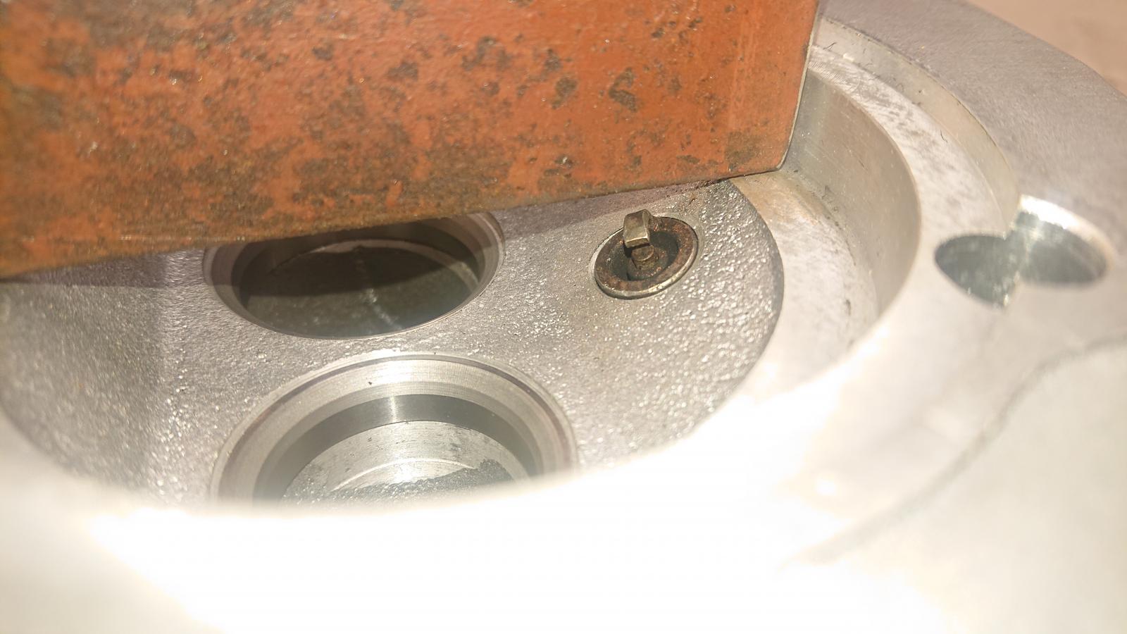

I hardly ever share direct info about what I do, but this time I decided that I will make an exception. So this will be a thread about making the Okrasa heads better and suitable for some good street power out of an Okrasa engine.
The engine will ultimately be a 69,5 X 83 mm (1503 cc)
Carburetion will be Solex 40PII on Speedwell manifolds. The rest is not determined yet.
To get a baseline on just how much is needed to make the heads support 100-110 hp with peak around 5500 rpm I wantyed to see how they flowed - almost - out of the box. I say this because the customer already had a competion 3 angle valve job performed on them. As at least some of you will notice the improved valve seats improved with about 4 cfm flow up to about 8 mm (0,315") After that it reduces significance. The last point in the graph is without a valve to see how much the port will support as is. Interestingly enough the multi angle valve job almost makes the port flow its maximum. Only about 8 Cfm reserve. Another interesting thing is that the small 30 mm exhaust valve actually outflows the intake at 0,150" - 0,250" lift with the multi angle seat cut.
This also explains why even a bone stock Okrasa engine wakes up significantly by just increasing displacement from 77 to 80 mm bore.
This test is made with an 80 mm bore cylinder.
All flow numbers are at 28"
The Okrasa engines are somewhat limited wrt cam lift. The valve lift can be handled with ratio rockers. But knowing the behaviure of an unwelded Okrasa port there is not much idea in lifting the valve more than about 0,450 - max 0500". Also, in order to get the engine to flow enough for 105 110ish hp at that lift and approx 5500 rpm we need the intake to flow around 110 cfm @ 0,450" with good port velocity and port energy. That should be possible with a 36 mm valve. We may go to 37 mm as I may have a set of such on the shelf from a Lotus engine that I can convert. More on that later.
So this is where we start from.

One of the issues with Okrasa heads from a tuning standpoint is, that due to the plug location you can´t flycut them much.
Personally I much prefer plugs with protruded electrodes, but that is basicly a no go. Even with a non flycut head you will only have the piston to cylinderhead clearance. With a std type plug it helps somewhat with about 2,5 mm clearance. So even with 83 mm bore and 69,5 mm stroke other measues have to be done to increase CR to anything resembling a more modern engine configuration. The chamber volume in an untouched WW Okrasa head is approx 46 cc. So with a 1503 cc displament and 1 mm deck height that results in a wimpy 8,3 - 1. So when I have finished shaping the chamber for larger valves and improving wall side flow it will be even lower. So something has to be done.
But first I need to find out how well I can make the ports flow, and how much valve size I need to use. The challenge with the intake ports are that they are very steep, sort of like in 356 heads. So next step is to make a dummy intake seat for a 35 mm valve and make a port and correct the manifolds and see where that gets us. - Some people will say "Why dont you just install a 37 mm valve and be done with it?" 1 reason really. The easiest thing is to make a big valve flow fair. The downside is, as always, that the port velocity and thereby port energy reduces dramaticly at part load resulting in decreased driveability. If I can get the port flow and characteristics I want with a 35 mm valve I will stay with that. If I need to increase valve size to get it, so be it. Here we are going to make a set of heads for a usable street engine that will see a vintage streetrace event every once in a while, so a wide powerband is the goal.
Now it will be a couple of weeks until my next step is ready. I will post results of the valve size increase and corrected port.
