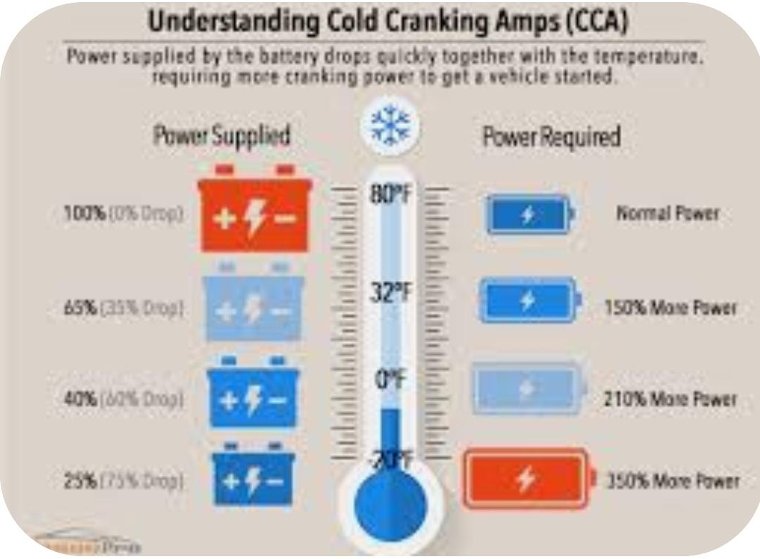

Ollie and other interested parties,
I ran a multimeter on the battery today. Here are my numbers:
Battery sitting at rest - 12.60
Running at med idle while parked~13.50 (first running)
Running at normal 800 RPM idle while parked ~ 12.50 (parked)
Running with heater on while parked ~ 12.48
Running during heater “cool down” while parked ~12.31
Running after “cool down” and heater off ~ 12.43
Engine off ~ 12.60
This morning I inadvertently turned off the engine before the heater completed its “cool down” cycle. One the heater was off and I attempted to see if I could start the bus and it started. No issues.
I’ve come to a couple of conclusions: first, this morning temps were north of 40 degrees so I believe so Nitramtebarb72 has a point with the temps. When I was having issues the temps were below 32 degrees. Secondly, I believe I need to address the + wire connection on the starter. I’ve never cleaned it or looked at it since I’ve owned the bus. Likely some minor issues there that may give issues during extreme weather.
Lastly, I’m going to take Ollie’s recommendation and hold off until warmer days to start switch things around. I’ve got a system - when I can remember it - and really love the extra heat on those sub-32 degree days.
Thanks for the hep guys.
