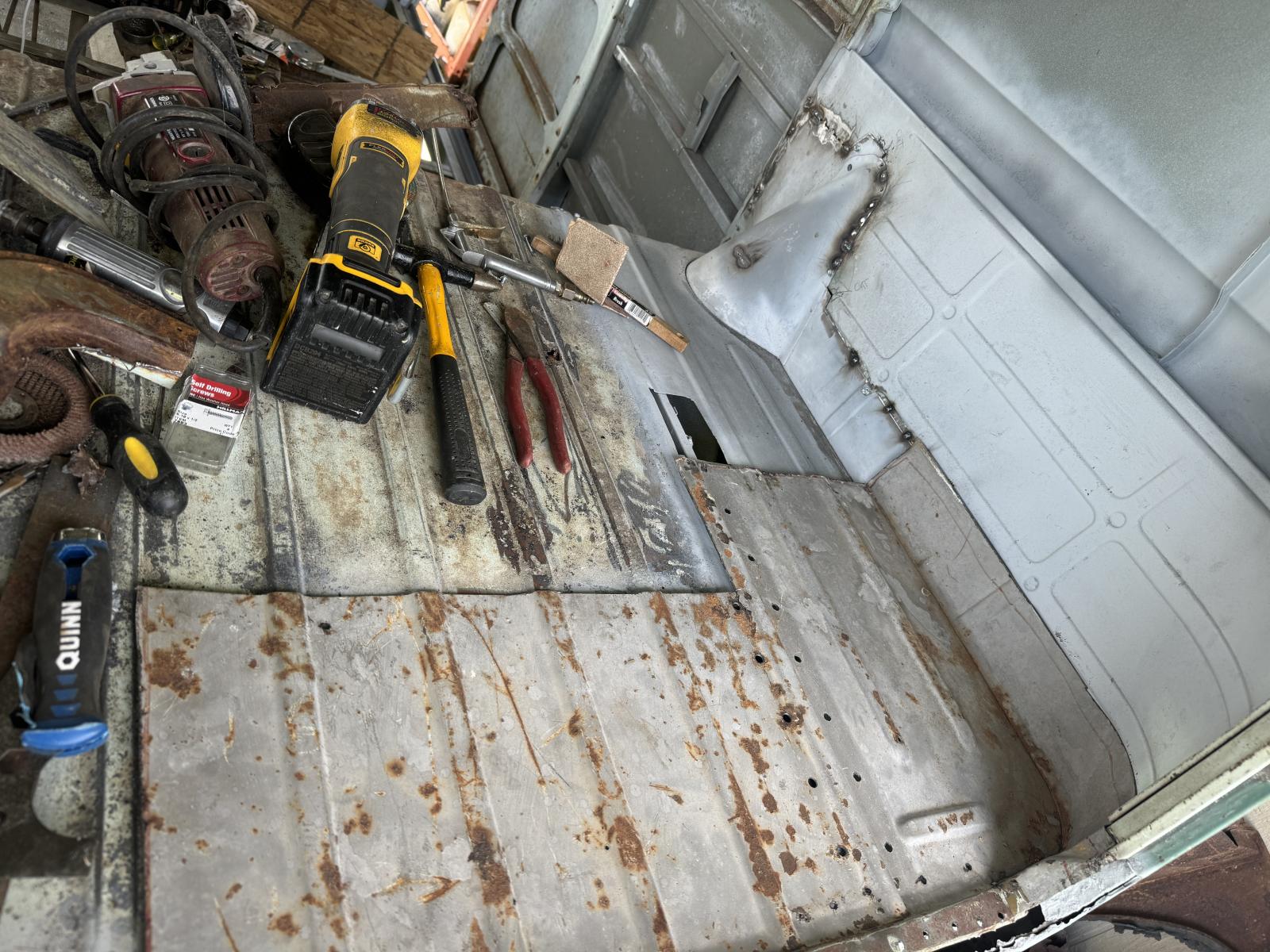

PostPosted: Mon Oct 04, 2021 2:06 pm    Post subject: Re: 1965 Velvet Green / White split walkthrough Rustoration Reply with quote
So a few more photos, they are old and I have done a bunch more since these Ill try to fill in these posts in order of how I done them.
So this is how the floor looked before starting removal, by the cargo door, the other side was pretty much the same.
and 2 more when I started cutting the floor out. I used the old cut with a cut-off wheel in my grinder and followed the tophats and I-beam sides being careful not to hit the lines for the brakes and shift-rod, ectt.. Used the air chisel tool to peel the floor on top of the ibeams, be careful using the air-chisel on the top hats as it will rip the spots out of the top hats.
The Rear passenger side rocker will need replacing also. I do have that replacement also.

PostPosted: Fri Oct 08, 2021 12:45 pm    Post subject: Re: 1965 Velvet Green / White split walkthrough Rustoration Reply with quote
More of the floor cutout
Then some Measure and Cutout passenger rear most I-Beam. This 65 has 3 I-beams in it.
Man this thing was swollen and crusty!
Cut the new piece from a KlassicFab Replacement, and fitting.
Then Welded in. I welded this end with a stepped notching with 2 plug welds in the overlap in to the original and them butt welded the rest. Made I think for a stronger end!

PostPosted: Thu Oct 21, 2021 12:02 pm    Post subject: Re: 1965 Velvet Green / White split walkthrough Rustoration Reply with quote
Little more shown progress from around May of this year. Trying to show in chronological order!
Rear passenger front of the wheel well cut out.
Replacement I made, without the other tweeking I had done to the edges.
Then almost all welded in, still need to finish it.
