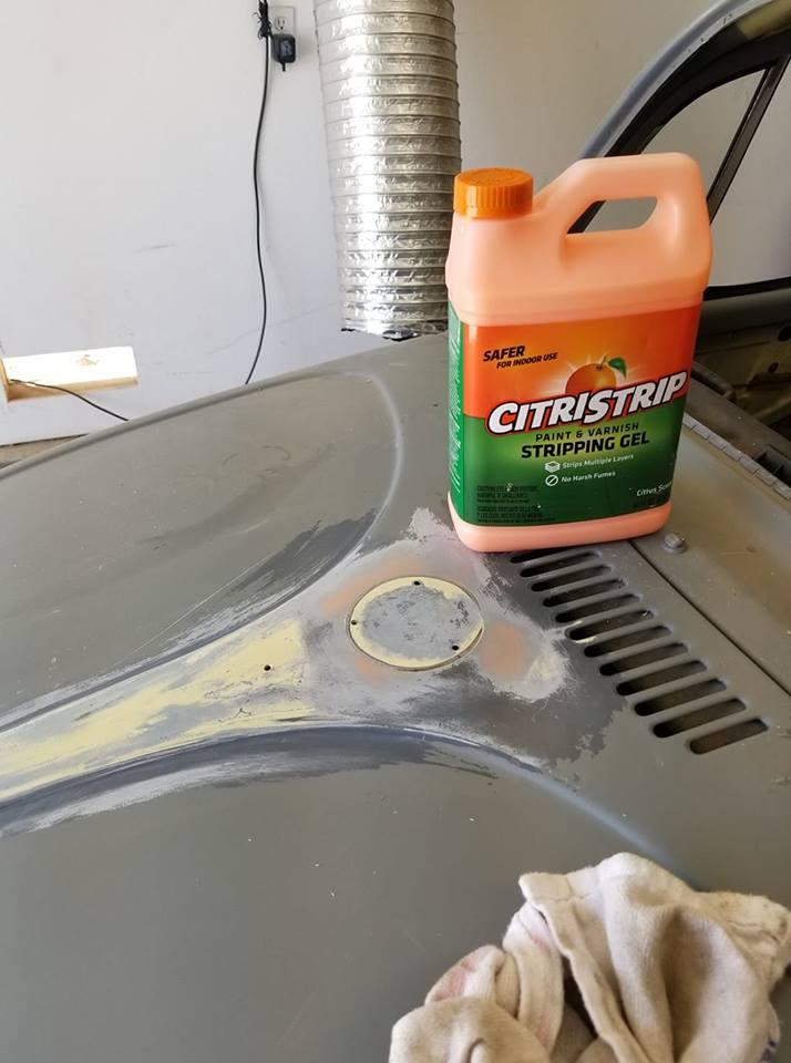

Products recommended to try to strip back to original paint:
* Chemical Strippers
* Putty knifes (plastic, get a bunch as the edge will go dull after a while)
* Razor Blades (plastic are best)
* Scotch-brite pads (No-scratch ones)
* Steel wool - Super fine #0000
Strippers
3M Safest Stripper
Citristrip:
Graffiti Remover
Notes: Or similar products
Jasco Paint and Epoxy Stripper
Notes: Can be harsh, probably best to try other products first and you must act quickly once it starts peeling

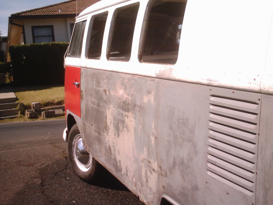

Skim, to remove non-OG paint and primer, I have had great luck with Graffiti Remover. Start out with a small area and don't let it stay on the paint too long, just a few seconds. Use a towel to wipe it off and you will be amazed at how easy it is. It will remove top layers of paint and primer, but be careful because it will go through the OG paint too. As long as you start out slow and get a feel for how long to leave the remover on, you'll get it. Better to wipe the remover off too soon, until you get a hang of it. No matter what kind of remover you use, remember to wipe all of it off completely, or it will continue to eat through the layers. In the case of the pics below, we were not trying to get to OG paint, just down to where the logos were.
Primer removal on front logo - "before"
Primer removal on front logo - "after"
Passenger's side logo - "before"
Passenger's side logo - "after"
Dash - "before"
Dash - "in process" There is no red paint left on the dash after this pic was taken. I don't have an after pic, sorry.

PostPosted: Mon Jun 21, 2004 5:26 pm    Post subject: Reply with quote
That was amazing. BTW, that ICE logo bus kicks ass. Period.

Thanks, the ICE BUS now belongs to my buddy Brad (Jawohl), and he has a lot of fun with it.
It's all about the patience, believe me. I would so much rather strip a layer or two of crap and get down to something cool and old, than just have new paint sprayed. Amyone can hire a painter, it takes actual sweat and many, many beers to remove paint. A real bonding time with your bus too!
