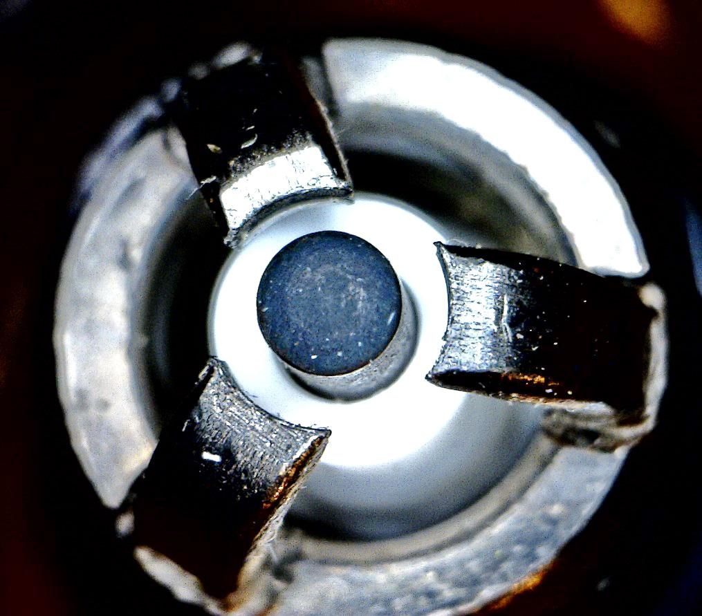

I have written volumes in these forums about triple electrode plugs. I need to find some of those threads and save the link.
An engine that requires this type of plug and runs better with it...requires it. Typically high compression and lean burn. They also ...for reason not 100% known....work far better with coil voltage better than the basic stock coil of the acvw.
Typically you see noticeable improvement with something as simple as a Perrtronix 42kv flamethrower coil. A lot of the watercooled VWs from late 70s and early 80's that ran these plans from factory ....used a transistorized hall effect system with 50-55kv oil.
Higher voltage makes a noticeably better spark on these plugs
The usefulness of these....is not as so many claim....just for longer life. The lifespan is a little longer....about 30-40% by my experience....but they MUST be kept gapped properly. That requires a specific but pretty cheap Bosch gapping tool....and a little time. You can also just keep a pin gauge and $3 pen vise around and use that.
Part of the difference in HOW they spark is that the spark is at the side of the center electrode....not the top. Its closer to the enclosed area in between the electrodes and has a different ground path that is similar to a "surface discharge" spark plug.
These are the type of plug originally used on motorcycles and that had high compression, ran high rpm and lean mixtures with a lot of turbulence in the combustion chamber ....where sparks could be blown at at high rpm causing a miss.
Yes....only one electrode sparks at a time.....but they all spark and its rare to see the same electrode spark twice in a row.
Because of how they ground....and a shorter ground path.....the variation of temperature of any given electrode....the particular fuel mixture and compressed mixture density in the gap between ground and center electrode........at any given time...one of these three electrodes WILL have lower resistance to ionization....and that electrode will spark.
They also purposely have the electrode ground on the end....into a segment of a circle that fits around the center electrode. That gives each side ground electrode VERY wide surface area .....with very sharp points on the ends of the electrode which actually increase propensity for ionization and spark.
You can see this in the pictures below.

Here are a few pictures I snagged out of my gallery of a new and a 40k miles Bosch W7DTC
The W7DTC and the NGK BP6ET.....are hands down easily the best sparkplug I have ever found for a type 4 engine with better than stock ignition, high compression and fuel injection.

As I said in my first post some guys love them.
I dont think its about "try them and see if you like them". Again.....its not something that just drops into any engine and automatically makes some kind of dramatic "change".
If your engine never came with them ....its possible and probable that the engine you have needs nothing more for proper ignition that what it came with. And dropping a triple plug like this into a basic engine.....just to see a difference without doimg anything else.....will likely show no changes.
The prime example I have..... The 1.7L high compression engine in 411/412 and 914 and the 2.0L 914 engine....never came with triple electrode plugs.....and in dead stock tune.....does not really benefit.
The main reasons for that are they run a bit richer than they should be from the factory (though its still more lean than the carbed engine) and the stock igntion coil while adequate.....cant really operate this plug noticeably differently.
However.....these particular type 4 engines are notoriously "under ignited". When you start tuning these particular engines a good bit tighter thwn factory.....you run into that factor.
Through the years.....I started see dealers and private tuning shops equipping 914s and a few other up-tuned cars from this era with these plugs.....with noticable improvement in smoothness starting and better tune-ability of fuel mixture.
Going from points to hall effect or points replacement along with better coils also was required.
I was shaking my head and thinking "whatever".....when I first saw this......but the tuning improvement was no lie.
At that point in time......already working on quite a few WC vw's and Audis (and even a few Datsun at one point in time)......that were using this type of plug stock......the lightbulb finally went on that these watercooled cars that ran better on this plug......had the same overall tuning characteristics that the 914 guys and 411/412s were running into. Higher compression, leaner burn .....running even leaner at highway speeds and rpms.
So if improving spark uniformity with electronic ignition and going to a more powerful coil.....and then re-tuning fuel mixture and timing are required to get any useful effect from these type of plugs......how does one know that the improvement you got.....was not just from all of those other improvements?
Pretty simple really......try dripping your original plugs back in and see if you can run exactly the same with all of the subtle tuning you have done.
If the answer is yes.....you never needed triple electrode plugs. You just needed to do a better job of tuning in the first place.
If the answer is no.....then you have your answer......that your engine and its characteristics are a good candidate for this type of plug.
These plugs like every other plug.....are not going to make some kind of dramatic horsepower change. A sparkplug will not manufacture EXTRA hp of any kind.
However if its what your engine and it's fuel and ignition system require......it can allow you to TUNE better....so you do not lose small amounts of the hp capability that your engine combo should have had in the first place.....and mostly you see improvements in throttle response.
I have never advocated that this type of spark plug should be universally used by anyone.....only that it works very well on specific engines with specific configurations. Ray
