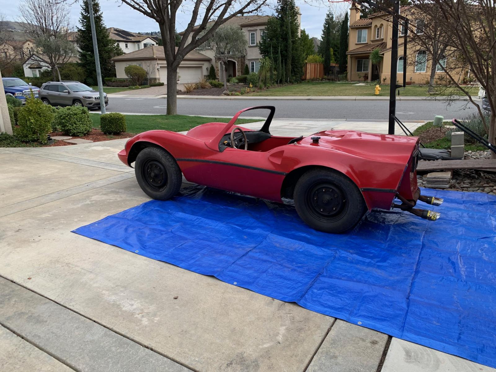

I was cruising through the ads and found this cool little Vokaro. It's complete including an excellent hardtop side windows, and tonneau cover. Has the instruction manual too.
It's been sitting for 25 years so I'll have to do some work to get it running. It has a Weber 2 barrel carb. It's a 1960 chassis and the motor is a 1500 from a 69 Ghia.

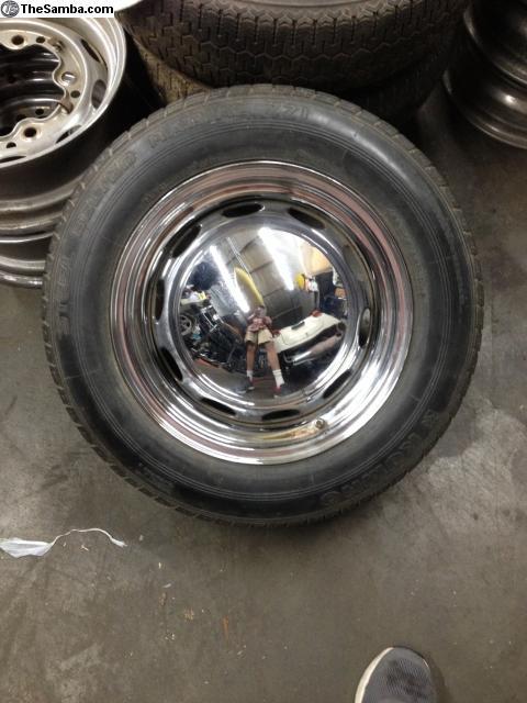

I've already ditched those hubcaps and am looking to get a set of Porsche replica wheels like in the picture below. Need a Ghia windshield too and will be getting rid of the exhaust with something a little cleaner.
Never had a VW powered car before so this will all be new to me. Luckily I've got some extra VW parts available from my Bounty Hunter rescue.

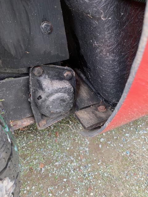

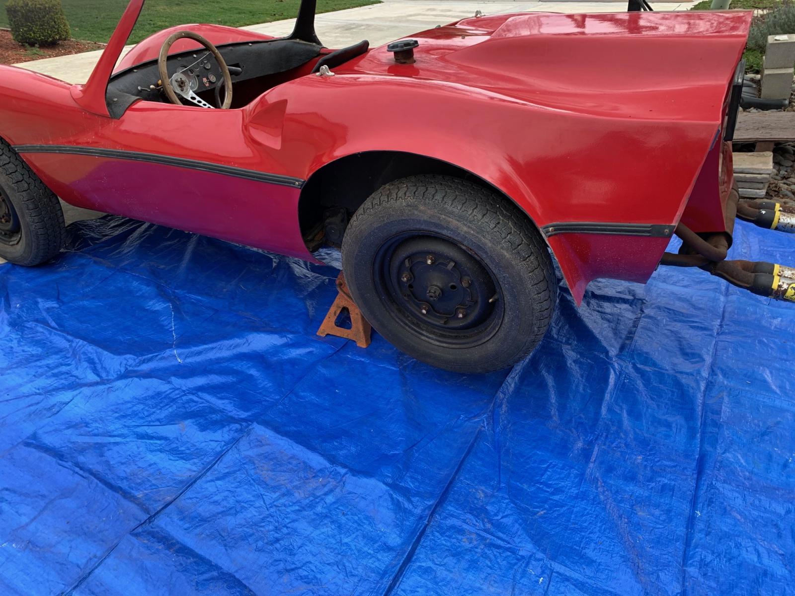

The body drives me nuts since it's offset an inch or two towards the back. Not sure if I can move it back easily.
This car also has what looks like a leaf spring connecting the two rear wheels. Is that stock on 1960 bugs? It limits the amount of camber so the wheels can't tuck under the car.

The "leaf spring" is a camber compensater, an aftermarket item on swing axles. It doesn't hurt anything and does help a little if you like to drive spiritedly through the corners. The body being offset.. is the mounting flange on the inside not matching the pan perimeter? It would be held on my the pan bolts on the outside along the edge, maybe a couple up front, but I wouldn't worry about a couple inches. Most kits were that way.

If only the early Corvairs had that camber compensator! I think the front of the inner body tub closely matches the flange on the admirals hat. I've got to take a closer look because they have a piece o plywood sandwiched between the an and fiberglass body tub.

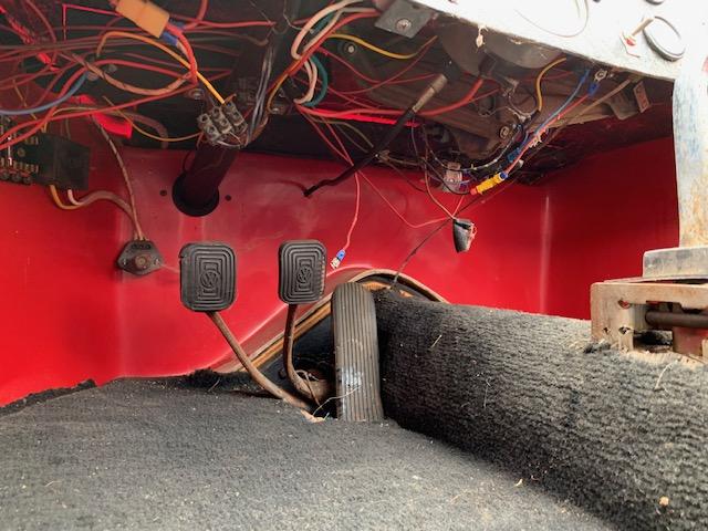

They have a spacer on the admiral's hat too. I've got just a bit of wiring clean up to do. Looks just like my Bounty Hunter.
There appears to be a bit of room to move it backwards but then it may not line up with the admiral's hat.

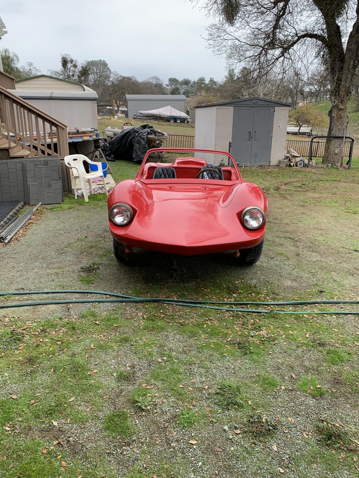

This dealer photo shows it nice and centered.
The driver's side is all the way at the back of the wheel for the rear wheel. The front wheel is too but not as bad.
The passenger side looks a little better. Not sure if that is the camera angle or a bent suspension. Maybe they didn't do a good job of shortening the pan so it could be crooked. You can still see that the front wheel is offset to the back. I'll get the tape measure out and measure the space between the wheels and see if it is 80" on each side. I'm betting it's not. If the driver's side looked like the passenger side I could live with it.

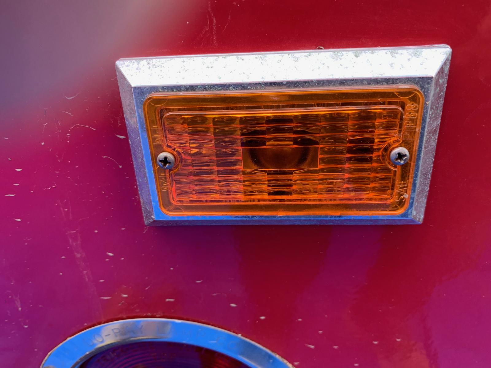

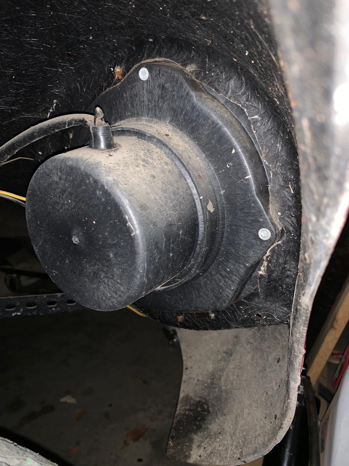

Can anyone identify this signal light? It's on the back of my car. I believe it was part of a kit from the body builder. The same light is shown on most Vokaros on the front in their literature and on many of the online pictures.
There is some lettering.
SAE PIP 68 on one side and PM 126 on the other side.
I'm looking to get a set for the front of my car as they have cheesy lights hanging down on there now.

I found them....
https://www.etrailer.com/Trailer-Lights/Peterson/4...gKqcPD_BwE
This is what the dealer used for rear lights for their demonstrator. These appear to be from a Mazda RX-2. I've seen lots of Vokaros with these lights as well as the trailer light above.

Headlights look like empi baja units.

Full plastic tub. I looked them up and that looks like the same one. I'll get a set of the rings ordered although they look like they are chrome over abs now.
Thanks for the pointer. Mine are rusted and beyond saving.
