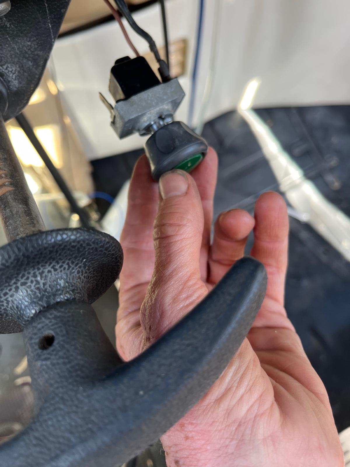

Where does Terminal K on the defogger indicator light get wired to?
Terminal 15: positive feed to Fuse 10
Terminal 31: Ground
Terminal K: ? (please see picture)
1979 VW Transporter (Type 2)
The single black wire hanging out of the base of the RH windshield pillar.
