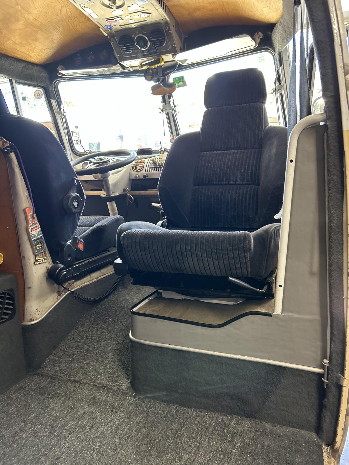

Thats a nice setup, and a really good reference photo. As I mentioned I converted to a walk through and a double door, amongst other things, but sacrilege wasn't on my mind as this bus had potential but it was also cut all to hell and converter camper windows done poorly, so I just decided to make this one what I want.
I've been looking at a lot of swivel seat bases, I have procar lowback seats for my bus, same ones I ran in my last 65' but years ago (sold) and my Chevelles over the years, can you tell I like the procar scat 90's? Smile
Regardless if I go swivel or not, I'll certainly be doing this extremely short bulkhead, if we can even call it that, only being inches long on top and curving down a bit just enough for seat clearance.
Even sourcing stock seats and stock swivels, it won't be stock to your bus, or mine, my two cents with that said, is it wont be stock either way so finding high quality boat swivels and some welded if needed, and seats or buckets of our choosing, could be pretty smooth. Just depends on the bus, most of us, even custom and modify fans like myself wouldn't cut up or heavily mod a stock beauty.
Tons of neat options out there.
Is the short "bulkhead steel tubing" 1/2" or 3/4"? Looks like 3/4" to me.
Just curious.

pyrOman
Fire Master
Joined: July 21, 2003
Posts: 12570
pyrOman is offline
PostPosted: Tue Oct 21, 2025 10:04 am    Post subject: Re: Walk-Through Conversion - Was this stock metal-work? Reply with quote
Thanks for the positive vibes! Cool
Always wanted to do this and last year I scored on 2 swivel bases at the Blackstar campout! Don't know where they came off from but they are stamped with the "Audi" sign. This one ended up about an inch HIGHER than the driver seat. I would have preferred a set up from a vanAgone but last time I saw one at the pick'N'pull the base was welded on and I did not have a way to cut it out of it. Sad
On the "side support", I used part of the cut off piece to mimic that of a stock swivel seat bus. Wink
Finally, the vent cover I found at the swaps and it came with 3 VDO gauges. I grafted the phatchick vents on it and used a horn button just to cover up the center hole. Razz
