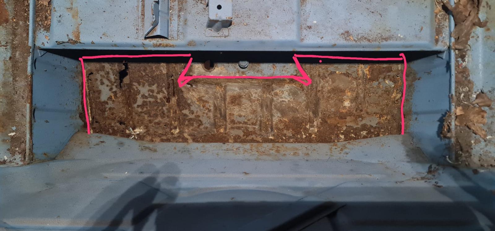

Need to reair this section on my bus, is it possible to do so without reniving the tool box section above? Seems like getting that out involves lots of spotweld removal and unfolding of the wheel tubs.

I'm hoping I can just replace/repair the rearmost section that tucks against the bulkhead.

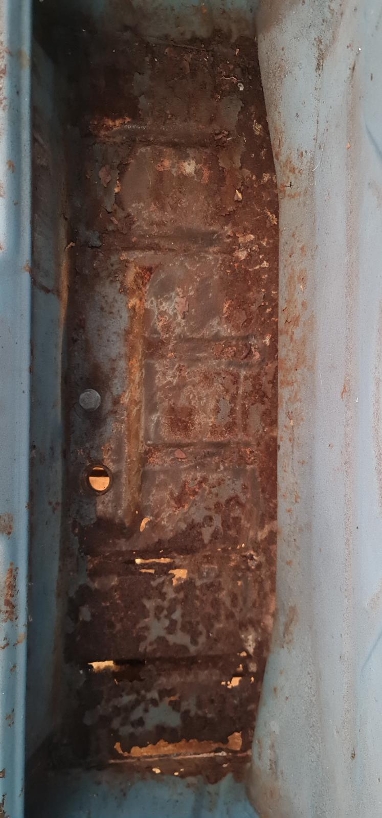

PostPosted: Mon Aug 19, 2024 7:15 am    Post subject: Re: Under cab tool box floor section repair 1966 bus Reply with quote
I'm hoping I can get away with repairing just this section, where a liad of wet leaves had sat for a while

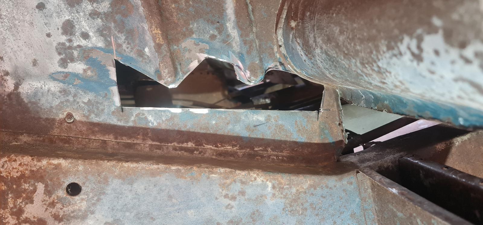

PostPosted: Wed Nov 06, 2024 1:36 pm    Post subject: Re: Under cab tool box floor section repair 1966 bus Reply with quote
Got out there again today:
Drilled out the spotwelds where the panel meets the sides
I'm going to cut this section out:
Big bit chopped out, now just need to trim off the flanges at the side where the spotwelds are, and then trim along where the panel meets the flange of the toolbox section itself:

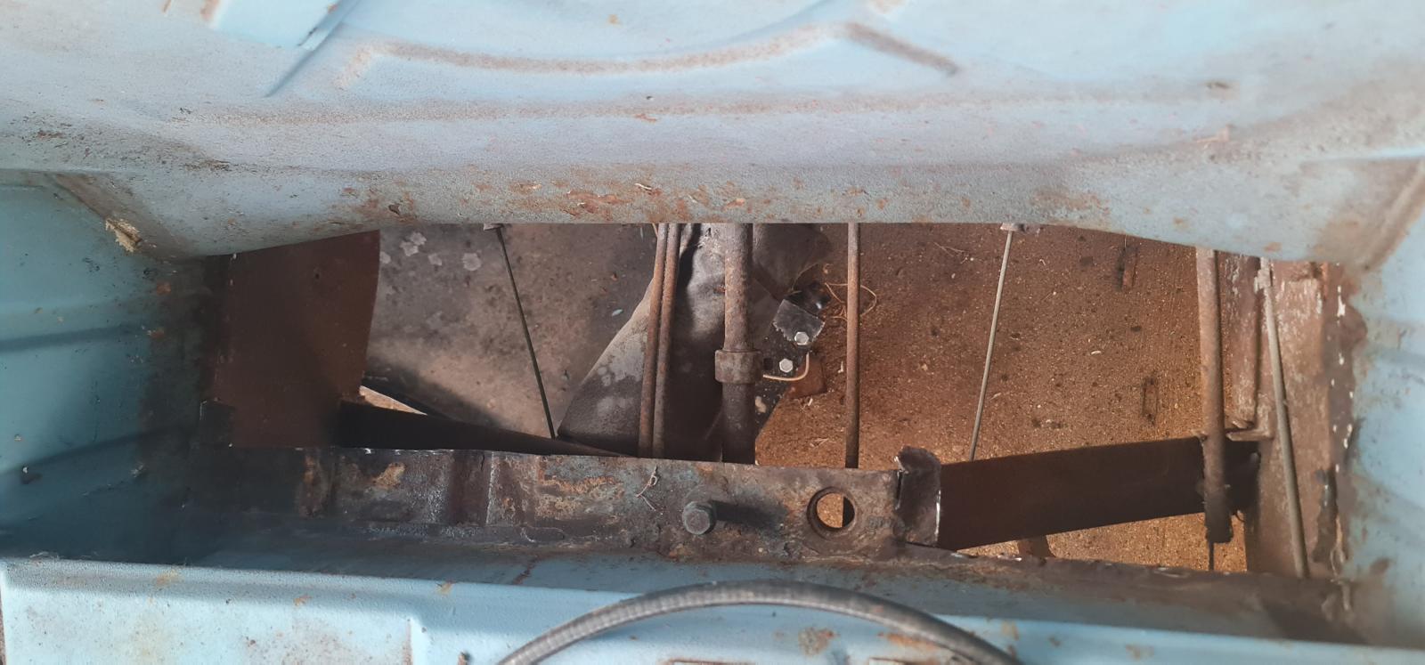

PostPosted: Thu Jul 10, 2025 3:58 pm    Post subject: Re: Under cab tool box floor section repair 1966 bus Reply with quote
Chopped some more - decided not to go right up against the flange on the passenger side in order to be able to dress the welds there back and have it look factory, although now as I write this I wonder if it will look better if there's a welded seam right the way across on both sides?
The other alternative is to hide the weld underneath the toolbox, but that will involve working on it from beneath.

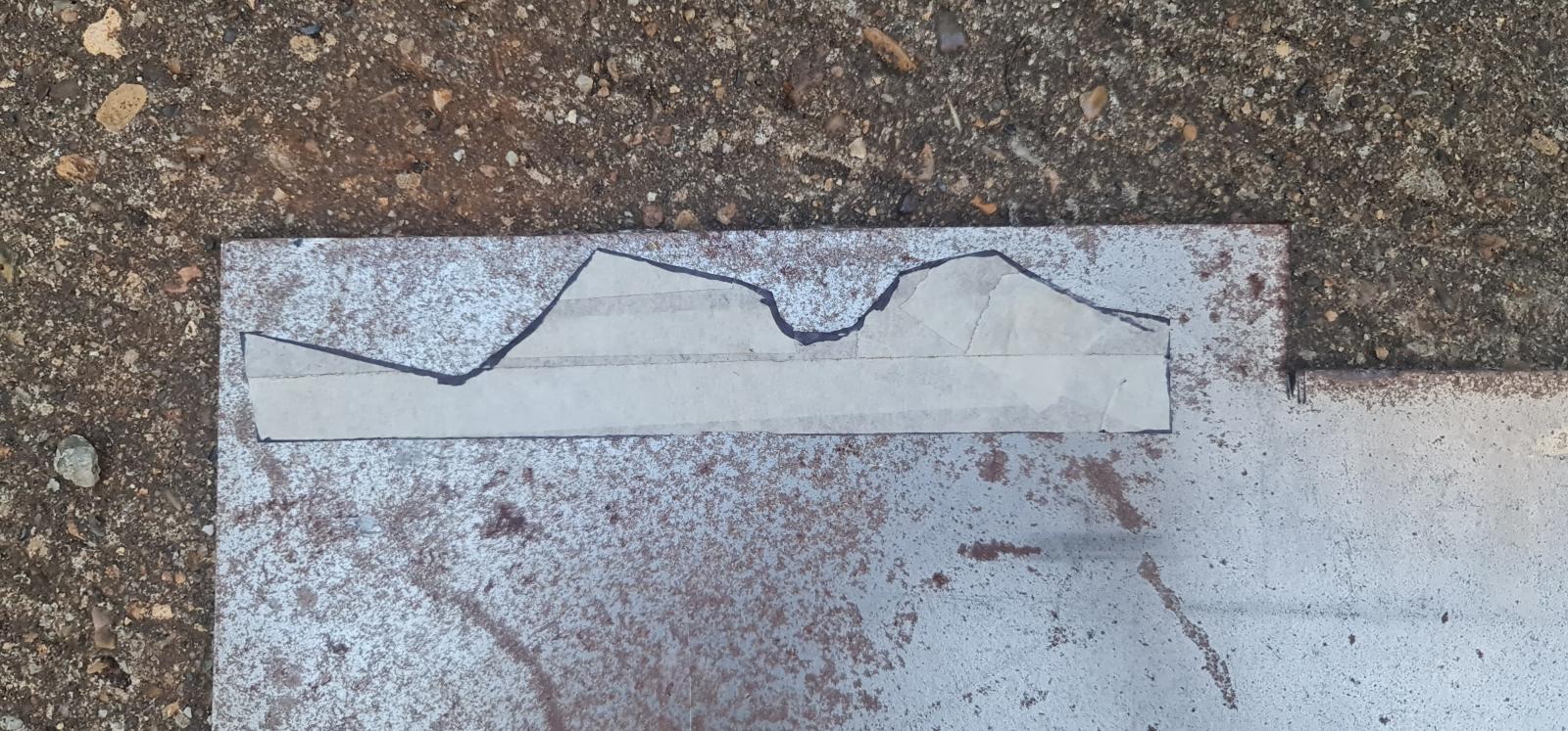

While I was at it I marked up a template to fix the chassis side plate tgat had rotted through where it attaches to the toolbox floor:
